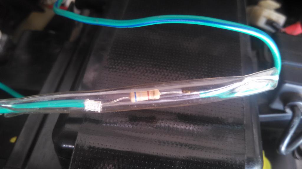

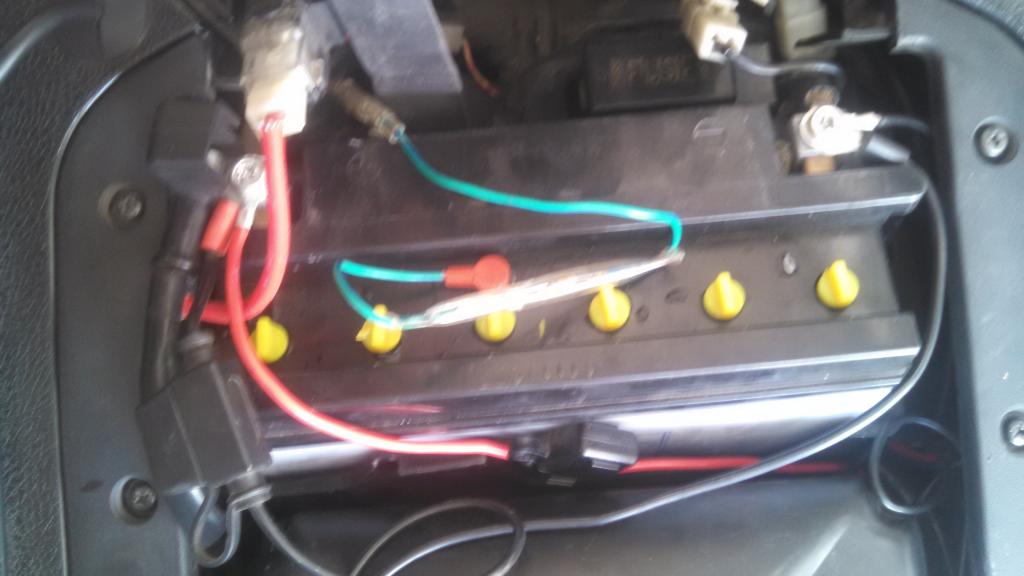

Prairiehammer Posted October 11, 2015 #11 Posted October 11, 2015 videoarizona said: BTW, the PO put a resister in the circuit AND this battery does have the sensor! [ATTACH=CONFIG]101912[/ATTACH][ATTACH=CONFIG]101913[/ATTACH] Question #2: If I replace with a sealed unit....will this resister setup work? The pictured resistor is original factory OEM set-up. If you change to a MF battery, simply cut that resistor off along with the probe and install a 2.2K through 22K ohm resistor on the same wire stub and connect the other end to a 12 volt supply, usually the ACC tap on the OEM fuse block.
videoarizona Posted October 11, 2015 Author #12 Posted October 11, 2015 Kevin, I was going to try the original resister first since it's within the parameters...6.9k. Didn't know that was part of the original system. Interesting!
videoarizona Posted October 14, 2015 Author #13 Posted October 14, 2015 Update: New battery in but original resistor didn't cut it as the warning light still on, so off to the store to find a 2.2K and maybe a 1K ohm set. Might as well take old battery to Autozone at same time...
videoarizona Posted October 15, 2015 Author #14 Posted October 15, 2015 Update: 2.2k resistor works. Warning of. Done!
