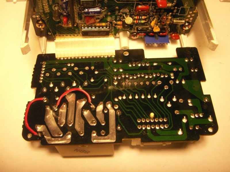

Flyinfool Posted June 9, 2019 #30 Posted June 9, 2019 The RLU has nothing to do with the headlight warning on the dash. To fix that you have to jumper the 2 headlight reed switches on the back of the dash display. There are 4 total reed switches on the back of the display, if you are doing a full LED conversion you will want to jumper all four of them.

jasonm. Posted June 10, 2019 #32 Posted June 10, 2019 (edited) Flyinfool said: The RLU has nothing to do with the headlight warning on the dash. To fix that you have to jumper the 2 headlight reed switches on the back of the dash display. There are 4 total reed switches on the back of the display, if you are doing a full LED conversion you will want to jumper all four of them. Because I wired my 4 LED driving lights to the head light harness 2- 10w to low(20 watts) beam power wire ,& 2-10w to high(20 watts)... ..I never got headlamp out. Just the warning "headlamp issue red led indicator" + LCD symbol. You say jumper the reed switches. " Eliminate by shorting so they never open ? Reed switches where ever they exist ...wish I knew. I have spare instrument panel. Hope the reed switch is easy to find there? Edited June 10, 2019 by jasonm.
Flyinfool Posted June 10, 2019 #33 Posted June 10, 2019 OK @cowpuc, back to school again. WARNING - Educational material to follow.......... What a reed switch is. It is a coil of wire wound around a glass tube (the reed switch) that has a wire sticking out of each end. The way it works is that the power to the light bulb flows thru the coil of wire. When power flows thru the wire it creates a magnetic field, think electromagnet. Inside of the glass tube are two thin iron strips that are not touching. When they get magnetized by the electromagnet the magnetic force make them attracted to each other and they pull together making a contact. It is this contact that the CMU uses to tell if a bulb is out. If a bulb is out the power will no longer be flowing thru the coil so the magnetic field goes away and the two iron strips are no longer attracted to each other so they separate. So jumping is literally connecting a wire from one end of the reed switch to the other so that the computer always thinks that power is flowing thru the bulbs regardless of whether it is or not. The reed switches are "tuned" to open and close at a specific amp draw. that way with the 2 bulb tail light if one bulb goes out, the amps will be half as much so the switch will still open, even though there is still some power going thru.

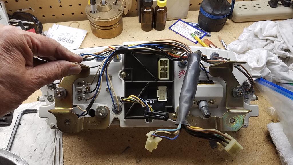

videoarizona Posted June 10, 2019 #34 Posted June 10, 2019 Reed switches marked and 2 are jumpered below are the high and low beam for headlight This board is located on the backside of the dash panel. You need to take the headlight/windshield stuff off. Then spread the two side panels. You can then get in there and take off the dash. There are two ways....one takes 4 screws to take out the panel and the frame...or just take out the panel with 2 screws. Put in on bench. Turn it over and look for the black "box" looking thing in the center. Take off the screws and pull it up. Board is there.

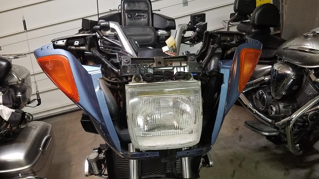

jasonm. Posted July 2, 2019 #35 Posted July 2, 2019 videoarizona said: https://www.venturerider.org/forum/attachment.php?attachmentid=116634 Reed switches marked and 2 are jumpered below are the high and low beam for headlight https://www.venturerider.org/forum/attachment.php?attachmentid=116635 https://www.venturerider.org/forum/attachment.php?attachmentid=116636 This board is located on the backside of the dash panel. You need to take the headlight/windshield stuff off. Then spread the two side panels. You can then get in there and take off the dash. There are two ways....one takes 4 screws to take out the panel and the frame...or just take out the panel with 2 screws. Put in on bench. Turn it over and look for the black "box" looking thing in the center. Take off the screws and pull it up. Board is there. https://www.venturerider.org/forum/attachment.php?attachmentid=116637 I have done the wire jumpers. Works great . The pics etc were helpful. But why did you remove the instruments the "hard way" ? Yamaha made this bike easy to service. I got my instruments out in less than 10 minutes. (1) remove windshield, (2) remove headlight, then LOOK there are 2 bolts, 1 left and 1 right of the wiring cluster and instruments. Any size hands can do this. Just need a 1/4" drive 10" extension and 10mm socket and a good light. To reinstall put a nut inside the socket to push the bolt out to catch the threads and possibly use a magnet touching socket to steady things. Cheers
videoarizona Posted July 2, 2019 #36 Posted July 2, 2019 jasonm. said: I have done the wire jumpers. Works great . The pics etc were helpful. But why did you remove the instruments the "hard way" ? Yamaha made this bike easy to service. I got my instruments out in less than 10 minutes. (1) remove windshield, (2) remove headlight, then LOOK there are 2 bolts, 1 left and 1 right of the wiring cluster and instruments. Any size hands can do this. Just need a 1/4" drive 10" extension and 10mm socket and a good light. To reinstall put a nut inside the socket to push the bolt out to catch the threads and possibly use a magnet touching socket to steady things. Cheers I didn't know how to do it...so spread the uppers to get my fat hands in there. Then saw the 2 bolts and chuckled. Yep...easy!
