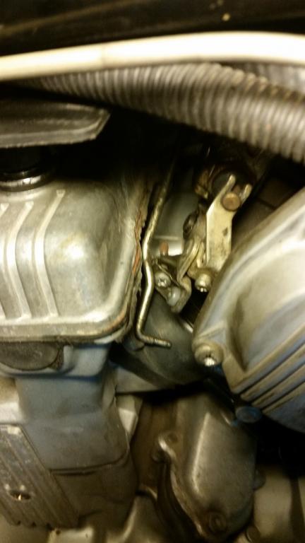

ChiefCass Posted September 6, 2015 Author #9 Posted September 6, 2015 I pulled the side cover this morning in preparation to pulling plugs for diagnosis and found the choke linkage for the right bank disconnected (picture>) (Doncha love learning about stuff the previous owner did?) I reconnected and then bent it very slightly so it'd stay where I put it. Then I took Blu out for test ride and... MUCH BETTER but still not the complete fix: - Low RPM still runs on mostly 3 cylinders and hesitates in idling parking lot maneuvers. - "Kicks in" much more smoothly without the popcorn noises in the exhaust at about 3200RPM - Still backfires under deceleration right at 4500RPM: Set your watch by it! I do NOT understand why not having choke on the right bank would make a difference in the way the bike runs WITH THE CHOKE OFF. The linkage "engages" the choke forcing a richer starting and warmup mix. With the linkage disconnected, the choke fails in the open or "disengaged" position and no vacuum or throttle condition should be able to pull it closed. What the Heck? Is there an idle enrichment circuit that's actuated by choke position? Yes, I'm a newbie. Yes, I need to read more about these bikes. Yes, I haven't dealt with carbs since Throttle Body Injection came out and not much even before that. I invite comments and I still plan to get into those plugs and see what's up with them... after I take a little ride... Too nice a day to twist wrenches. I've got all Winter (in Michigan) to do that nasty tear-down and repair stuff. Thanks!
