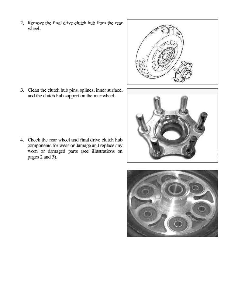

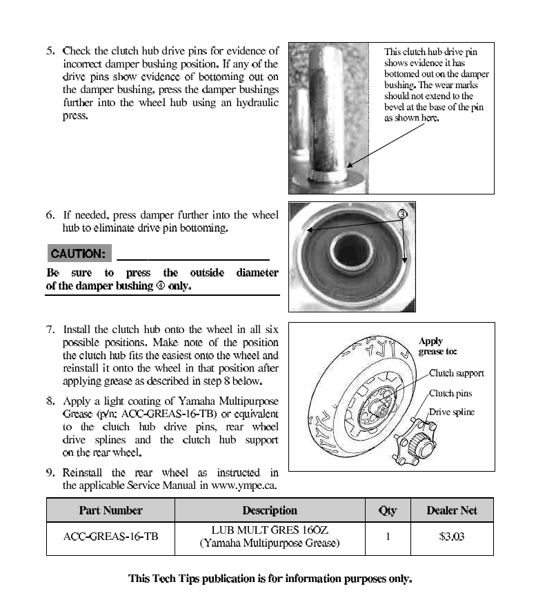

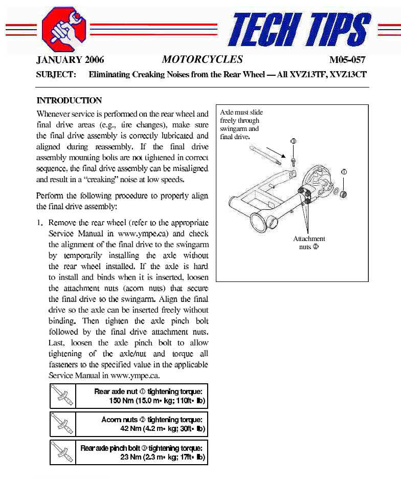

Eck Posted September 2, 2015 #3 Posted September 2, 2015 Ok, lets test that questionable bent axle. Remove the wheel from the bike. Insert the axle through the swing arm as normal, but no need to use the spacers or the locking nut here, this is only a test. Now turn the axle. Does it spin freely or does it bind a little? There are (4) acorn nuts on the rear end of the drive shaft housing.. If there is any binding at all you must loosen those acorn nuts and tighten them in a criss/cross sequence. Read this tech article and perform the instructions with-in to ensure your in alignment. http://www.venturerider.org/forum/showthread.php?1705-Rear-End-Noise-Yamaha-TSB http://www.venturerider.org/rearnoise/index.1.jpg http://www.venturerider.org/rearnoise/index.2.gif http://www.venturerider.org/rearnoise/index.3.gif
