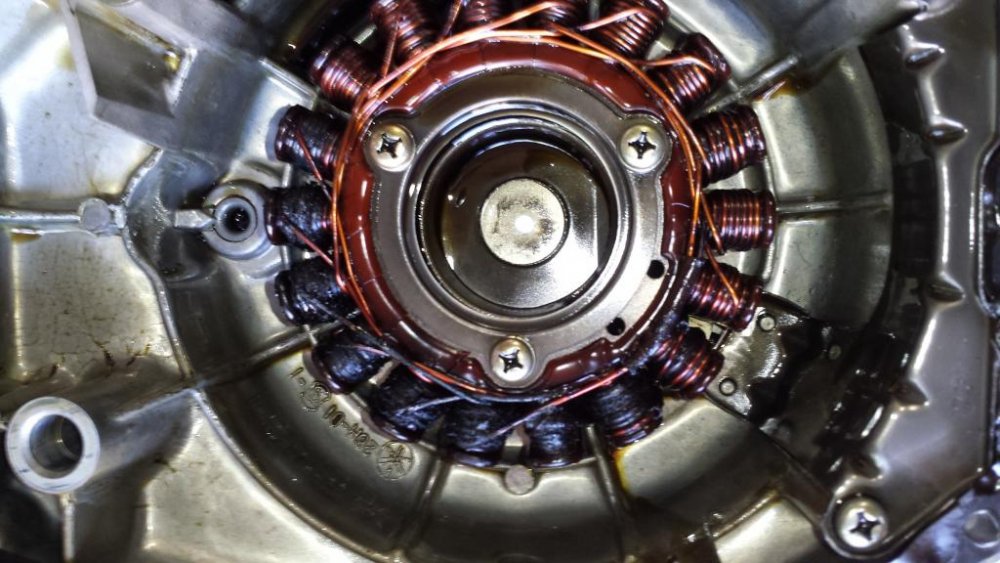

The Bum's picture is showing the stator up side down. The pictured burned section is up when installed on bike.
It is very typical that an upper leg gets crispy. Rarely does the lower leg burn up, because it runs cooler, since it received more cooling engine oil.
