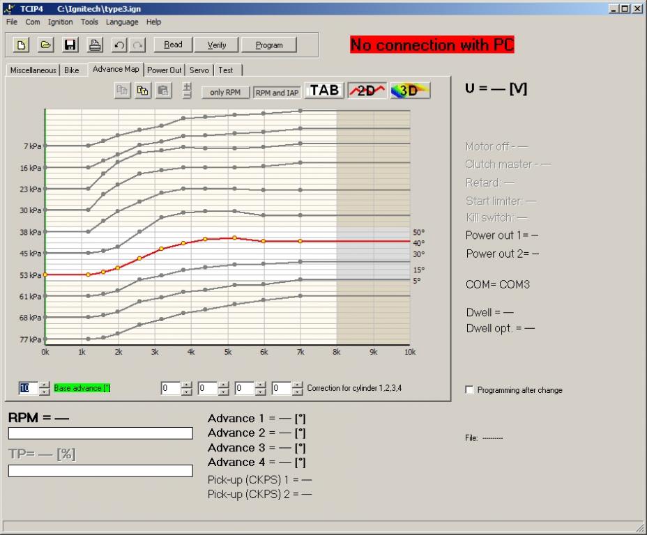

KISA Posted September 21, 2015 Posted September 21, 2015 I received ignition charts from Gary. An old problem - all charts are calculated on use of TPS... Lonestarmedic - established your chart. I passed 30 km. For some reason the average temperature of the engine, on 15-20 C increased. I will do a bit of traveling 2-3 more days, I will replace a chart and I will look at temperature. I, however, again established COP.
lonestarmedic Posted September 21, 2015 Author Posted September 21, 2015 Kisa- My chart is fairly agressive. It is possible that you are experiencing a detonation problem depending on the octane of your fuel. Try dropping the curve down a bit. My curve has more advance in the part throttle area. I have another chart that I developed that is less aggressive. When I have a chance I will load several different versions and check the temperature.

KISA Posted September 22, 2015 Posted September 22, 2015 Bad-11 km/litre, 9 litre/100 km, 25.9 miles per gallon. Oh, it is my chart! Lonestarmedic - On your chart I didn't refuel yet. I confirm the increased temperature. It seems that the overestimated corners on small and average turns. Tomorrow I will replace a chart. I will try a new insertion of Ignitech.

KISA Posted September 23, 2015 Posted September 23, 2015 My main task - to connect IAP with the chart of ignition made for TPS. Pressure from 101 to 75 kPas aren't necessary to us. Here example. I don't understand actions of Ignitech. It turns out, they put on the TPS motorcycle and do an ignition chart?
lonestarmedic Posted September 23, 2015 Author Posted September 23, 2015 Whether IAP or TPS is chosen the action is the same when using a vacuum sensor. It is reading voltage. And that voltage in a given rpm is assigned an advance value. You set the advance value on the TAB section.

KISA Posted September 23, 2015 Posted September 23, 2015 Lonestarmedic - 65 miles/hour - the most economy mode. There it is possible to reach 36 miles on gallon. Boring speed) I set TAB. But I am not confident in the minimum and maximum pressure. My motor on single turns shows 75 kPas. In an ideal pressure has to be 33 kPas (-2 atmospheric pressure). Something not so with carburetors?
