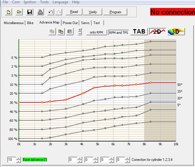

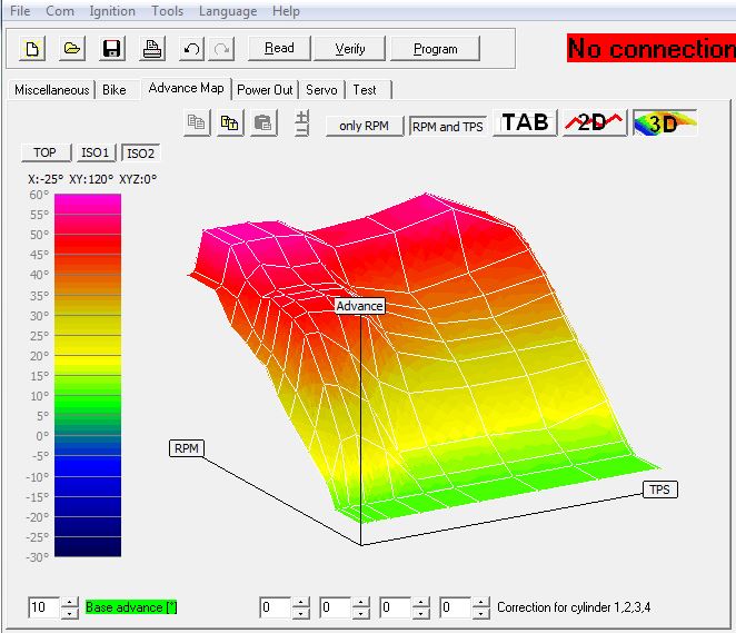

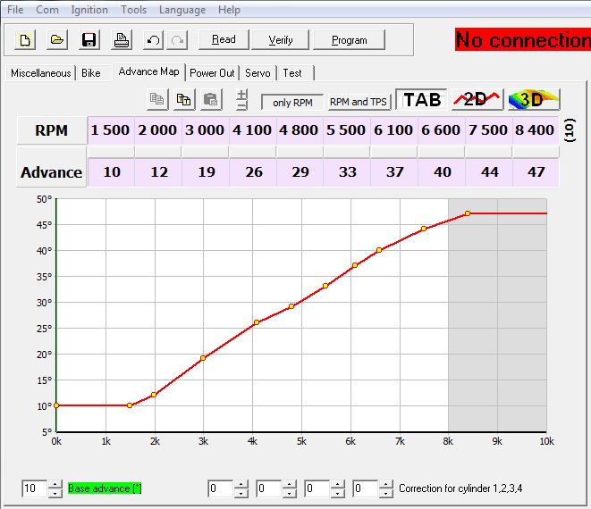

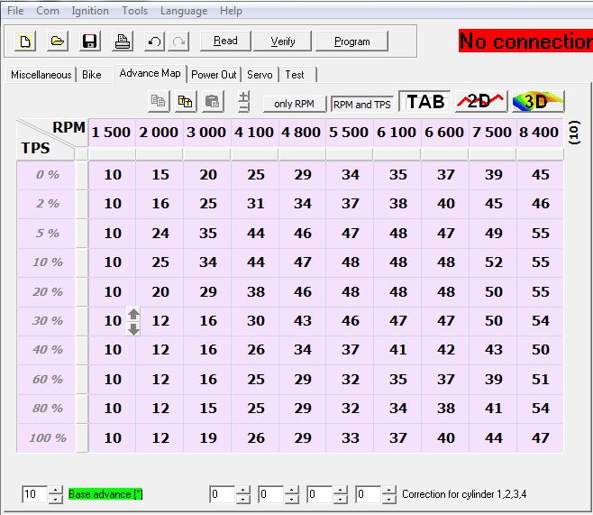

lonestarmedic Posted September 16, 2015 Author #89 Posted September 16, 2015 Been a couple weeks now and I have played with my mapping a bit. I am satisfied for now and intend to ride the bike and check mileage and performance. The C.O.P. conversion is really the way to go. I feel the plugs are firing at their optimum. My curve is pulling like a freight train. Maybe I can tweak it a bit yet. But the response from 2000 up to 8000 RPM is smooth. The bike feels very different. More willing to respond to throttle and quicker to run up speed and RPM. Is this the module itself? Or the combination? Or merely the fact that my original CDI was starting to fail? I do not know exactly. My next step will be to put the thinner shims back under the diaphragm needles. These I got from SkyDoc17 years ago. Maybe going on 5 years. I had put the carburetors to stock in order to evaluate the ignition. With the thin shims I always got 43 MPG when one up and 37 MPG when 2 up. Right now my best tank has been 39 MPG one up with the stock setup. I know that I am currently running a bit rich in the cruising RPMs. I can see it on the plugs, smell it, and see it on the muffler tips. I may even try switching to a set of those expensive Iridium plugs and see if those respond well with the C.O.P. setup. However, the stock plugs have been doing well. But I sure have clogged them up with all this tuning I am attaching screen shots of my present programming so those interested can see the minor changes. I have also sent them by request to one gentleman who has been having some of the same problems that I encountered.
KISA Posted September 16, 2015 #90 Posted September 16, 2015 I can't understand - why by means of MAP sensor to emulate TPS? Whether it was simpler to balance MAP and standart sensor (IAP)? I tested the chart of type2. Distance of 500 km, rider + passenger of =230 kg. To 2500 turns of power it isn't enough. Sweat-enough. The maximum speed - 180 km/h.
lonestarmedic Posted September 16, 2015 Author #91 Posted September 16, 2015 Kisa, This motor has never been designed to run well at 2500 rpm. It is slow in the lower rpms. Even stock with a good module my motor did not work well until 3000 RPM. Using a MAP sensor lets us factor in the load on the motor. Whether we call it TPS or IAP. The voltage is translated to a percent of advance. A TPS sensor is linear. Half throttle is 50%. But what gear at which RPM? And what is the torque load on the bike. The vacuum sensor helps by trying to interpret those factors.
garyS-NJ Posted September 16, 2015 #92 Posted September 16, 2015 I'd have to think the map would be better because when you wack the throttle open, the vacuum drops and at that point you don't want full advance (until the rpms spin up ). A tps would need a mass airflow sensor.
Great White Posted September 16, 2015 #93 Posted September 16, 2015 I'd have to think the map would be better because when you wack the throttle open, the vacuum drops and at that point you don't want full advance (until the rpms spin up ). A tps would need a mass airflow sensor. Actually, most ign curves in the automotive world are a 3 d lookup table using rpm, MAP and %TPS. Very effective. At smooth and approriate power curves. They then chuck in a knock sensir to pull timing if knock is detected. mass air flow sensors are used to tailor fuel injection to proper stoich. Ive never seen maf used in any ign lookup tables. ideally, we would want baro (ie:map) and tps to trim out ign curves. But the ignitech is an either or propositon so its map or tps. I lean towards using map if the choice has to be made....
