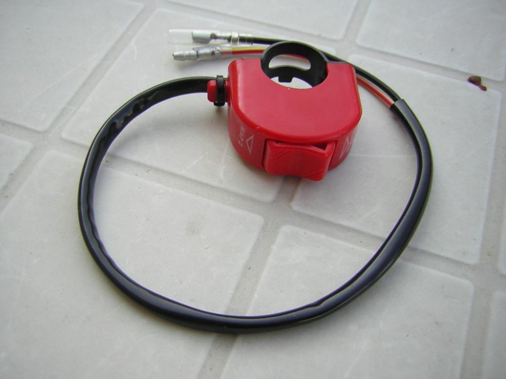

dingy Posted September 5, 2015 #41 Posted September 5, 2015 I just found a new item on Ignitech site that might be interesting. It is called a MAP Switch. I sent my contact at Ignitech an email asking about it and if it would work on TCIP4 TCI. http://www.ignitech.cz/en/vyrobky/accessories/map_switch/map_switch.htm Gary

Great White Posted September 6, 2015 #46 Posted September 6, 2015 (edited) I just found a new item on Ignitech site that might be interesting. It is called a MAP Switch. I sent my contact at Ignitech an email asking about it and if it would work on TCIP4 TCI. http://www.ignitech.cz/en/vyrobky/accessories/map_switch/map_switch.htm Gary Interesting. Seems like the "switchable tunes" we do in OBDII. This would seem to indicate that the Ignitech can hold more than one set of tables at a time. I even looks like it uses the same scheme of grounding a pin to switch curves. seems to be what the black wire would indicate. If that's what it's doing, any 3 pos switch would work. Switching tunes has more of an effect in OBDII vehicles because the switch means different, fuel, ignition, shift tables, etc. I personally prefer to tune for the best all around performance when setting up OBDII vehicles, but there can be some benefit from manipulating only the ignition curves in a vehicle like a bike that only gives you the ability to tune the Ignition. After this winter, my engine will be more VMax than venture, so that's the curve I'm going to start with and tune from there. Gawd, I hate saying "tune" but it's what most guys undersand these days. Say "re-calibrate" and you get that dog tilted head thing as a response..... Edited September 6, 2015 by Great White

KISA Posted September 7, 2015 #49 Posted September 7, 2015 dingy, it won't turn out to work with 2 charts. Only, we have an option to depress an ignition chart on in advance set number of degrees. Its Retard.
