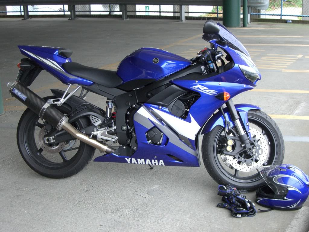

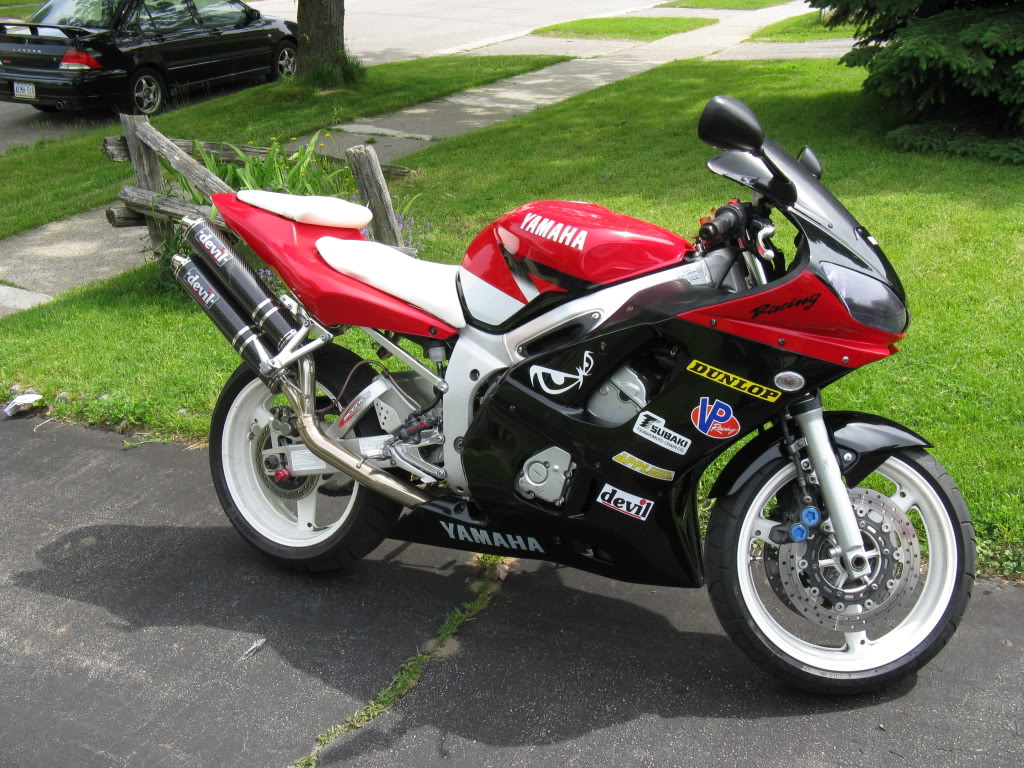

BratmanXj Posted August 25, 2015 #6 Posted August 25, 2015 Condor that's what I'm probably going to do. I have my eyes on a nice set on Ebay from a 05 for $65. Both R1 & R6 in 2005 (blue bike) were Radial Mounted Calipers that won't fit out bikes and You'll have to find a set from an older bike like the 2001 (red bike) that mount horizontally to the fork leg.

Condor Posted August 25, 2015 #8 Posted August 25, 2015 Both R1 & R6 in 2005 (blue bike) were Radial Mounted Calipers that won't fit out bikes and You'll have to find a set from an older bike like the 2001 (red bike) that mount horizontally to the fork leg. [ATTACH=CONFIG]101306[/ATTACH][ATTACH=CONFIG]101305[/ATTACH] Yep....

Prairiehammer Posted August 25, 2015 #11 Posted August 25, 2015 The color of the R6 is not a good indicator of brake caliper compatibility. For instance, there was a blue 2001 R6 with calipers that you can use.

BratmanXj Posted August 25, 2015 #15 Posted August 25, 2015 Now I'm confused I was told blue fit red don't. The Blue ones I am looking at have horizontal mounting bolts. Sorry, my color comment was only in regards to the 2 photo's that i put up to show the different calipers/forks relative to the year of the bike. The pictured caliper will work. But the list that the seller says is of compatible bikes is incorrect. Agreed...
