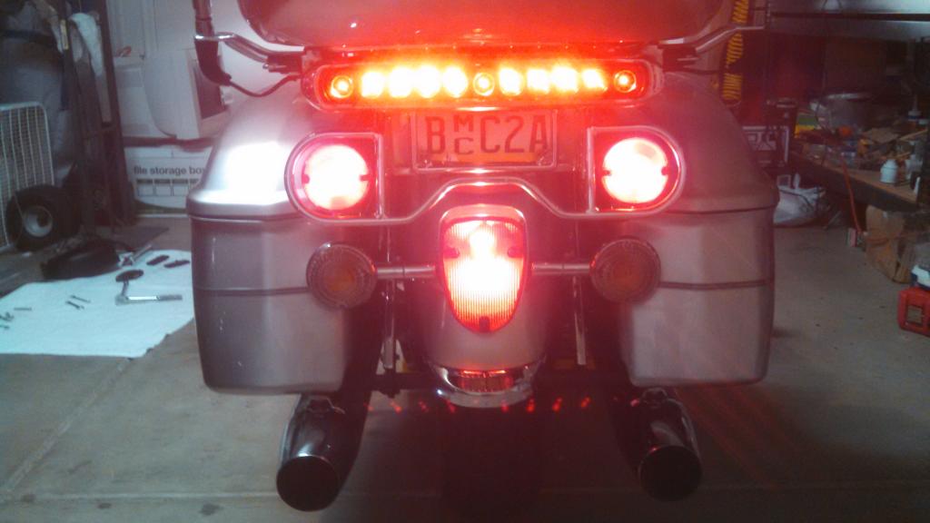

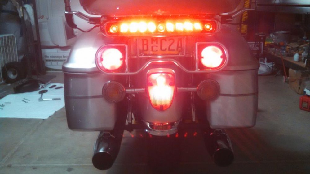

videoarizona Posted August 22, 2015 #6 Posted August 22, 2015 I was also thinking of some sort of brake lights mounted on the trunk somehow. What about some Harley lights on the license plate bracket...I also have an LED strip right under the trunk. One of our members, Steve @M61A1MECH, sells them. or Yamaha made a spoiler for the trunk that had lights on it. I don't have a pic of that but the ad that Puc posted in the watering hole has a picture of an 05 silver RSV with the spoiler.
cruiserlover Posted August 22, 2015 Author #7 Posted August 22, 2015 What about some Harley lights on the license plate bracket...I also have an LED strip right under the trunk. One of our members, Steve @M61A1MECH, sells them. [ATTACH=CONFIG]101214[/ATTACH] or Yamaha made a spoiler for the trunk that had lights on it. I don't have a pic of that but the ad that Puc posted in the watering hole has a picture of an 05 silver RSV with the spoiler. I will check into that.yes the harley gave me the idea.

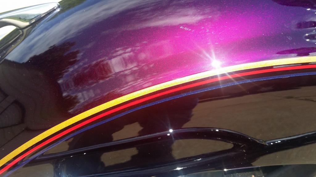

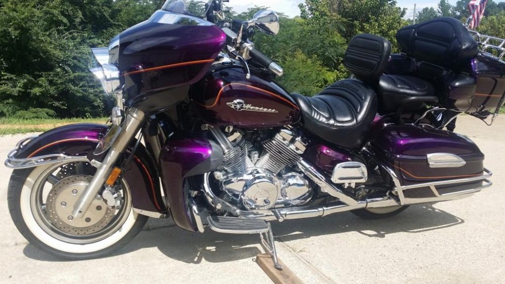

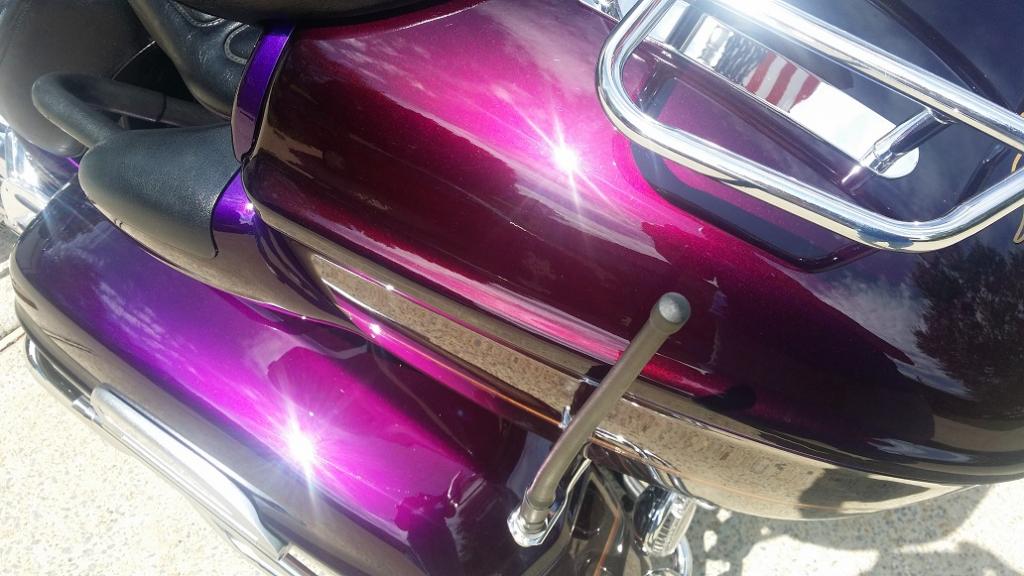

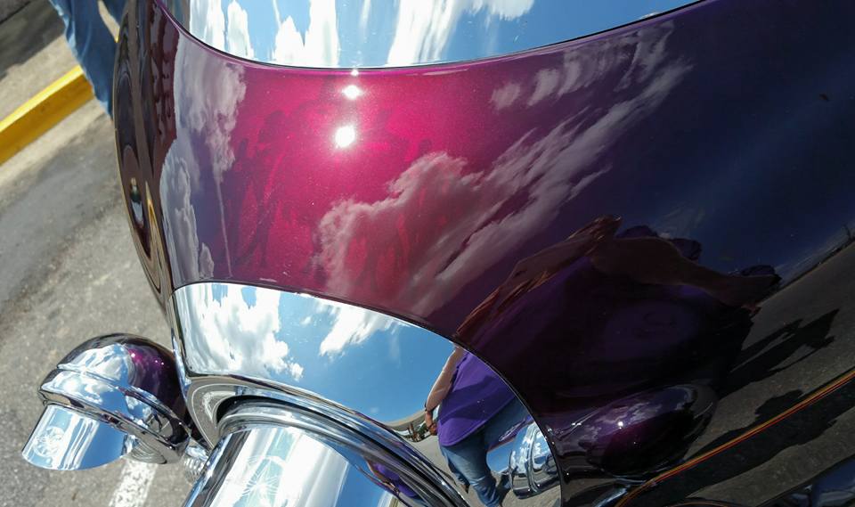

YamahaLarry Posted August 24, 2015 #8 Posted August 24, 2015 Get ready. Tearing down a venture, cleaning and then sanding all the parts is a ton of work. I would rather sand a complete car for painting. Every little nook has to be hit with a medium grit paper (depends on paint manufacturer). I just completed painting my RSV. HOK tech data for paint that I was using was to sand surface with 320 grit. It took a while and lots of sweat. Also, the pinstriping has to be totally removed and it is vinyl striping and most likely under a couple coats of clear. Once that was done, and minor repairs performed, we laid on the layers of paint up to the point of my pinstripes. Let paint cure for at least 24 hours and then sanded the 6 parts requiring stripes with 800 grit. Then we applied a layer of inner clear, then the stripes and then 2 more coats of clear. Lots and lots of work. Took me 3x longer to put it all back together as it did to tear it down. Granted, by mine being candy, it required more work, but still, this is no easy chore. Here is my finished product. Reassembly was just completed this past Friday. You can read about the inspiration for the project in one of my other threads in Watering Hole.

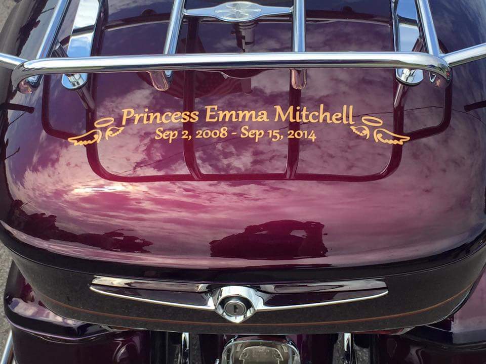

YamahaLarry Posted August 25, 2015 #11 Posted August 25, 2015 (edited) That is about the most beautiful paint job I have seen.Sure, it was a lot of work, sure it was a pain, but the bike results are what makes it worth a 100,000 dollars in appearance.Beautiful work.I have decided probably on metallic red, not as big a flake as 196-'s metalflake,but flake.The word venture will be like a ghost emblem,painted on, barely discernible on the sides of the tank.Plus xvz1300 on the sidecovers.I am not concerned with saving or reaplying stock pinstriping.I would love to know the paint colors you used Larry.As far as time, in the winter it will be done,too rideable right now. All the paint was House of Kolor, except for pinstripes and tribute to Princess Emma. Those were 2011 Ford colors. HOK: Silver Sealer BC02 Orion Silver BC10 Pavo Purple (these 2 basecoats were what I used to give it a two tone effect) UK22 Voodoo Violet Kandy SG100 Intercoat Klear USC01 Show Klear The ghosted Justice League is the Pavo Purple, lightly misted on top of the Orion Silver. We sanded the ENTIRE surface of all 27 pieces with 320 grit prior to painting. Then after the intercoat clear and 2 coats of show clear, we allowed it to cure for more than 24 hours and sanded the parts that required pinstripes with 800 grit, applied the stripes and then sprayed 2 more coats of show clear. I think there are total of 4 coats of clear coat. Some will tell you that 1 quart (if you are using a solid color) is enough to paint your bike. Don't listen to that. Depending on the gun you use and air pressure, 1 quart will get you 2 coats, maybe 3 if you have very little overspray and how thick you lay it. I recommend allowing an extra pint at a minimum. I bought 2 quarts of Kandy and barely had enough. We had to really stretch it to get 4 coats. We were running 22 psi at the gun (HVLP with I think a 1.4 tip). Edited August 25, 2015 by YamahaLarry
cruiserlover Posted August 25, 2015 Author #12 Posted August 25, 2015 All the paint was House of Kolor, except for pinstripes and tribute to Princess Emma. Those were 2011 Ford colors. HOK: Silver Sealer BC02 Orion Silver BC10 Pavo Purple (these 2 basecoats were what I used to give it a two tone effect) UK22 Voodoo Violet Kandy SG100 Intercoat Klear USC01 Show Klear The ghosted Justice League is the Pavo Purple, lightly misted on top of the Orion Silver. We sanded the ENTIRE surface of all 27 pieces with 320 grit prior to painting. Then after the intercoat clear and 2 coats of show clear, we allowed it to cure for more than 24 hours and sanded the parts that required pinstripes with 800 grit, applied the stripes and then sprayed 2 more coats of show clear. I think there are total of 4 coats of clear coat. Some will tell you that 1 quart (if you are using a solid color) is enough to paint your bike. Don't listen to that. Depending on the gun you use and air pressure, 1 quart will get you 2 coats, maybe 3 if you have very little overspray and how thick you lay it. I recommend allowing an extra pint at a minimum. I bought 2 quarts of Kandy and barely had enough. We had to really stretch it to get 4 coats. We were running 22 psi at the gun (HVLP with I think a 1.4 tip). Great information.I appreciate it a lot.
