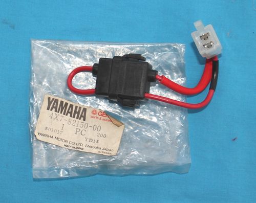

Prairiehammer Posted August 18, 2015 #4 Posted August 18, 2015 Tatonka82 said: The air suspension is not working, is that easy to replace? Depends on what part of the C.L.A.S.S. (air leveling system) is not working. Does the controller light up and display anything besides "psi"? As Marcarl says, the CLASS can be operated only when the keyed ignition switch is at the ACC position. If the controller does not turn on, check the CLASS fuse. It is a glass fuse within a rubber waterproof in-line fuse holder. Tatonka82 said: When the bike warms up, I start having shifting issues, I cannot get it into Neutral. Shut it down, start is up when it cools off and I can shift into neutral and start it. Any solutions? Again as Carl says; probably requires a fluid flush and bleed of the clutch hydraulic system. I lost the capability to disengage the clutch completely on my then new to me 1990 when I was riding it home from the seller's business. Old water contaminated fluid was the cause.

Tatonka82 Posted August 19, 2015 Author #8 Posted August 19, 2015 Prairiehammer said: Depends on what part of the C.L.A.S.S. (air leveling system) is not working. Does the controller light up and display anything besides "psi"? As Marcarl says, the CLASS can be operated only when the keyed ignition switch is at the ACC position. If the controller does not turn on, check the CLASS fuse. It is a glass fuse within a rubber waterproof in-line fuse holder. [ATTACH=CONFIG]101191[/ATTACH] Again as Carl says; probably requires a fluid flush and bleed of the clutch hydraulic system. I lost the capability to disengage the clutch completely on my then new to me 1990 when I was riding it home from the seller's business. Old water contaminated fluid was the cause. What is the best fluid to flush with a DOT 3? Which brand do you like?
