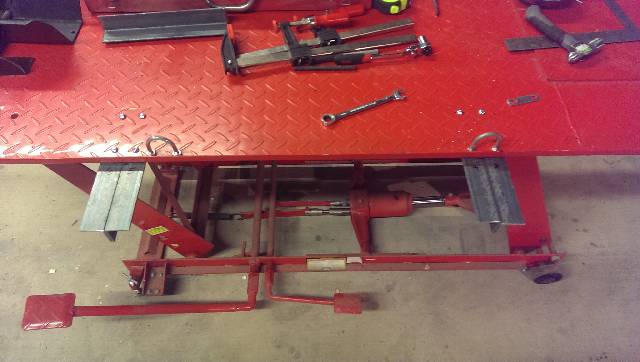

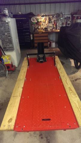

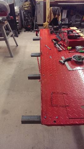

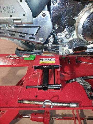

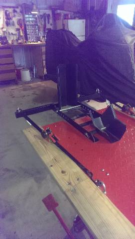

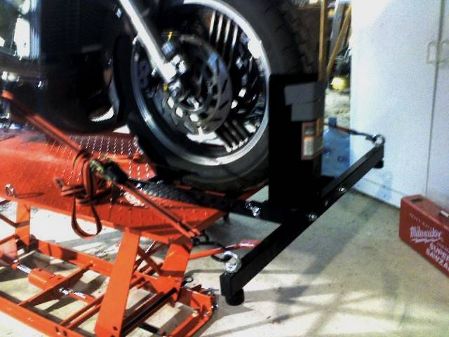

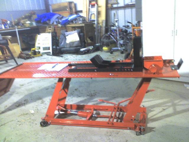

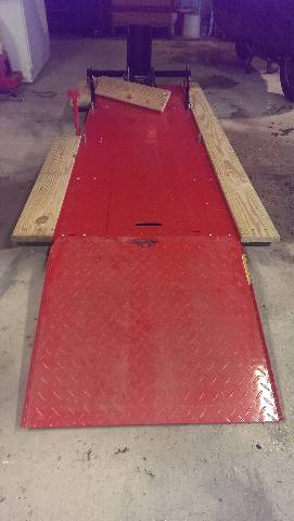

lonestarmedic Posted August 11, 2015 #11 Posted August 11, 2015 My 1986 is on a Harbor Freight manual lift right now. The lift is about 5 years old. Works great. I added wings down the side for an extra bit of width. Six inches each side. I put a different wheel chock on the front and repositioned it a bit. I use a small screw scissor lift under the bike instead of a center stand. I can use the rear wheel drop that way. Mine is the generation with the solid safety bar. And has the lips of the frame bent differently than a second generation. Not sure what is available now. I had to set my pressure relief valve upward when I first got it. It would not lift my first gen. I put a Harley Electraglide on the lift and then adjusted the relief valve until it would just lift the Harley. Never touched it since. If the lift is under load, it will sit against the hydraulics and not drift down more than a couple inches in a week. Unloaded it will drop about a foot or so in a week. Load must push the O-rings and seals outward a bit and cause a tighter seal. After the modifications, I have about $400.00 invested. Including the new chock and the side wings. I would not give it up now. I do ride the bike up the lift under power. If bike is dead, takes two people to push it up on. JB

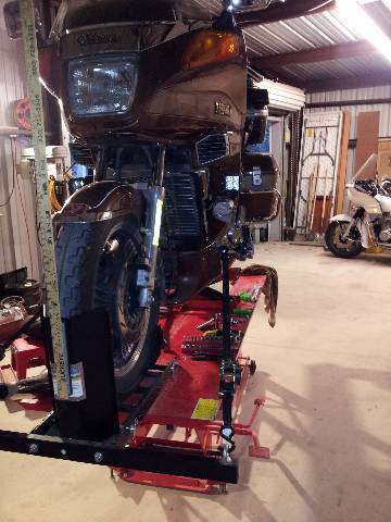

H2O Posted August 12, 2015 #13 Posted August 12, 2015 I bought one this summer too. Installed two 3/8" eye bolts close to the front corners with large diameter fender washers so I could use ratchet straps from the handlebars to anchor with. I never use the front tire clamp except for a wheel chock and the little u-bolts are pretty much useless for large bikes. My 88 is a bit too much for this lift, but my 06 RSV is very secure after the eyebolt install. I haven't attempted to elevate the wheels yet but was getting ready to figure that out next. Glad to see some ideas. Had to put hydraulic fluid in mine, but overall I'm satisfied and man, how nice it is just to stand there an have easy access to maintain and clean!

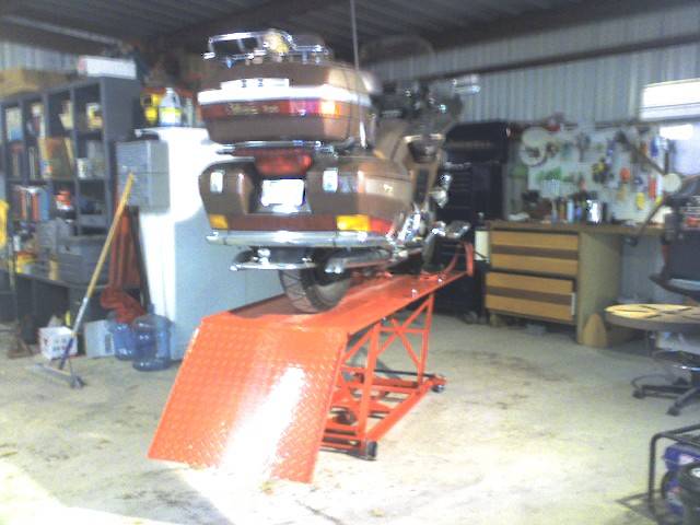

lonestarmedic Posted August 12, 2015 #15 Posted August 12, 2015 Pictures of my lift as it has progressed.

H2O Posted August 12, 2015 #19 Posted August 12, 2015 And the side wings: [ATTACH=CONFIG]101060[/ATTACH] [ATTACH=CONFIG]101061[/ATTACH] [ATTACH=CONFIG]101062[/ATTACH] [ATTACH=CONFIG]101063[/ATTACH] [ATTACH=CONFIG]101064[/ATTACH] [ATTACH=CONFIG]101065[/ATTACH] [ATTACH=CONFIG]101066[/ATTACH] [ATTACH=CONFIG]101067[/ATTACH] [ATTACH=CONFIG]101068[/ATTACH] Good idea! I always get a buddy to help with mine and I've thought about doing this. Can you back it down safely too?
lonestarmedic Posted August 13, 2015 #20 Posted August 13, 2015 I drop the rear suspension and no problem. Put in 1st gear and leave the brakes alone. Feather the clutch to slow the descent. Of course bike is not running. Sent from my SAMSUNG-SM-T217A using Tapatalk
