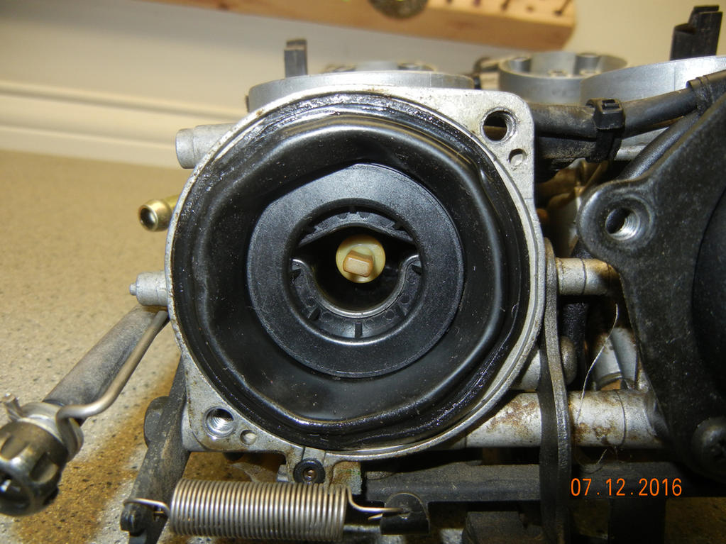

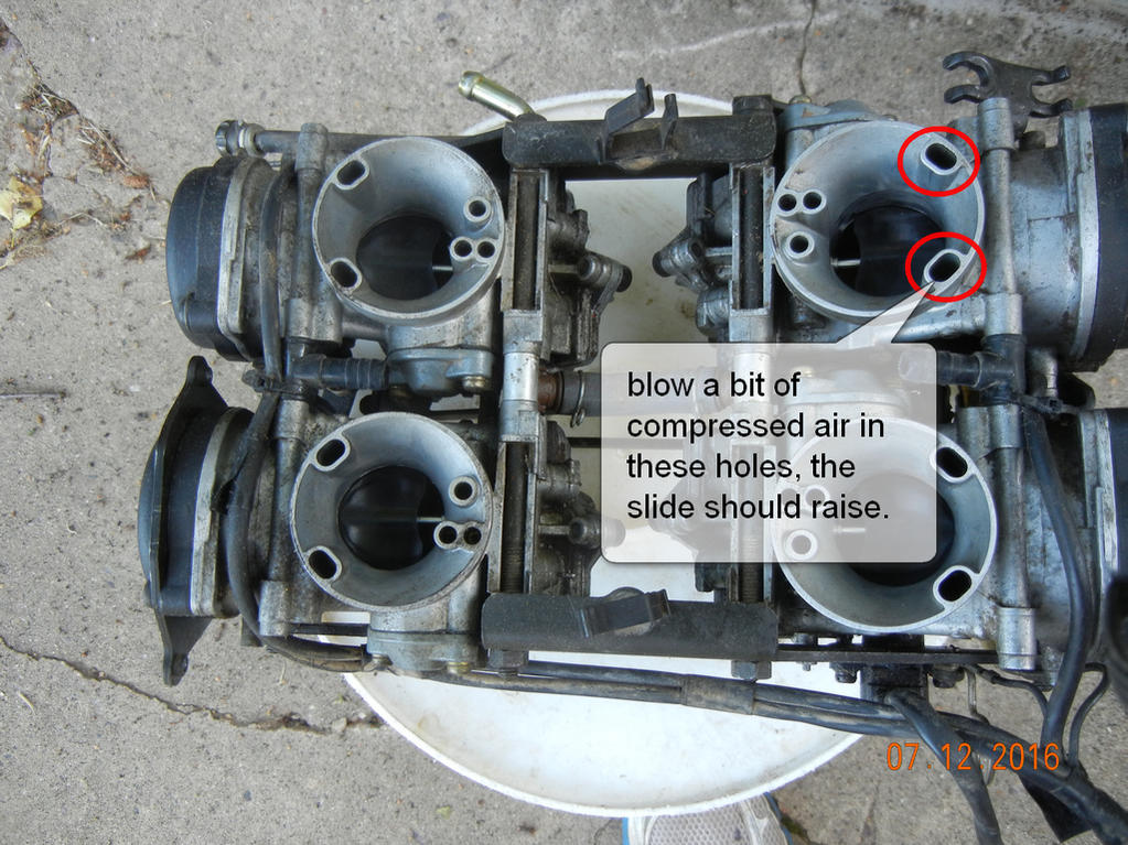

Hadn't been into set of venture carbs for a while, but a new to me 99RSV had been fuggled by a "motorcycle shop". Gas was dripping, pouring out of the carbs, couple things I found;
air test.jpg\\
three out of four rose..........
Turns out "mr cycle shop" wasn't the sharpest pencil, but he only charged the PO a few hundred for his carb "services"

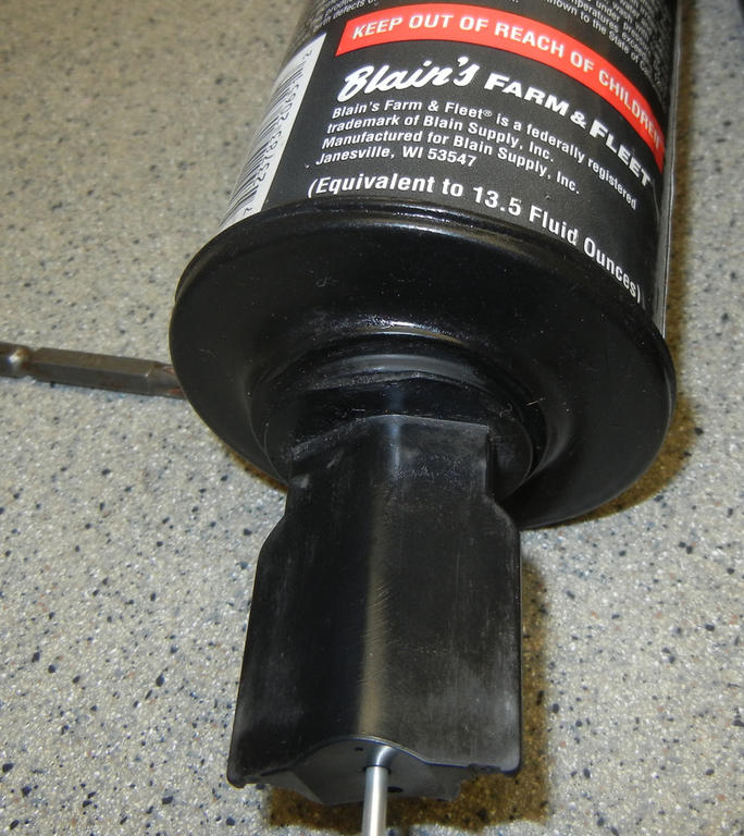

after lubing with a bit of dielectric silicone grease I gently stretched the diaphragm over a spray can for a few minutes, this let me get it in the body groove and get the cover back on, rechecked with compressed air, all FOUR slides now rise as they should.
