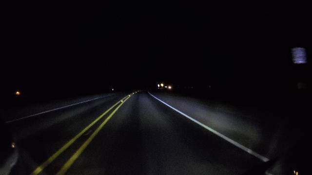

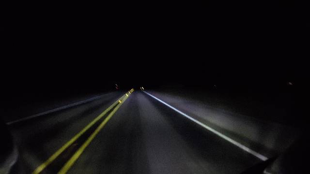

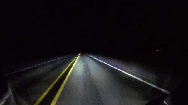

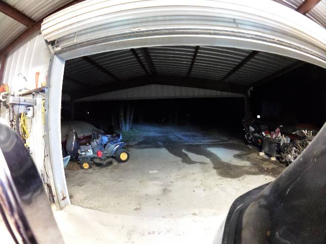

lonestarmedic Posted July 28, 2015 Posted July 28, 2015 I decided to try one that could be bought through Amazon on Prime. That way I could have a hassle free return. I ran into a unit from a place called OPT-7. A lot of claims about reliability, waterproof, bright, and working correctly. It came in and I pulled the headlight and followed the directions. It went in as described. I tucked the little driver module up in the wiring harness and hit the switch. All I can say is WOW!!!!! The beam is bright white and focused really well. No dark spots and it has a nice vertical cutoff. Spread is fantastic. Lights up the road edge much better. I set the vertical where I thought it should be by measuring against my garage wall. Bike with tire touching wall I marked beam top cutoff. Backed up 30 feet and put the cutoff edge 2 inches below the first mark. Waited until dark and went to field test. I took a major 2 lane state route and passed about 15-20 oncoming cars with no one flashing me. Low beam out there about 2-3 times brighter. Went to a straight deserted level road and checked hi beam. It kicked out there and really did its job. about twice the distance out from the edge of the low beam. I could not be happier. Then I kicked on my Rigid LED driving lights in addition. This bike lights up the night like the sun. And the LEDs are super efficient. Yes, the LED headlight tripped the CMU and threw a headlamp out indication. But, it did NOT trip the Reserve Lighting Unit!! They claim Can-Bus compatible. But I did not expect it to be fully compatible with a 30 year old system. So, I have removed the Reserve Lighting unit, jumpered the CMU system and all is good. This unit is about $55-$60.00. My opinion is very worth the trouble. I put another post up showing the rear of the CMU on my 1986. And there are write ups on jumpering the RLU. But, if anyone want my version just ask. JB

lonestarmedic Posted August 2, 2015 Author Posted August 2, 2015 (edited) LED headlight results: 1) The OPT-7 unit does NOT seem to emit any RF on my bike. I use an aux. input through the 1st Gen cassette player modification. I am sending my phone through and streaming Pandora radio or MP3s. I do have a stereo ground isolator between the phone and the input. I had to put this in for the normal ground problems not the LED. 2) I do know the problem with the LED emitting a hum in a stereo. My first Rigid LED driving lights had it badly. And Rigid did a recall on the lights and replaced the driver circuit. When I got the lights back, the hum/static was gon. 3) You can hear the little cooling fan on the LED when you turn on the ignition just before you start the bike. I actually now listen for it. 4) I uploaded a video clip onto my Facebook page. I am am public. Joseph Slye. My cousin is Joe Slye. I am the one in Floresville, Texas. (joseph.slye.7 on FB) 5) I am thoroughly amazed at the quality of the light and its performance. I have chopped out the reserve lighting unit permanently and modified the harness. It will still work for a standard bulb should I need it. I did retain a headlight indicator out signal. TURN ON BIKE. IF AREA AHEAD OF YOU IS DARK, A BEAM IS OUT! Seriously. I have the headlight on my walk around every morning anyway. Here are some pictures of the headlight on our dark rural road. Pictures were snapped in motion using my Garmin Virb action cam. It does video and will take still at the same time. Inside dark garage out to driveway. Out on road. Should be low beam. I believe high beam High beam and Rigid LED driving lights Edited August 2, 2015 by lonestarmedic
