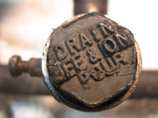

Next, check to see that the bypass plug down by the oil filter is turned in the right direction. (See pic) This will also cause an issue with the cooling of the motorcycle.

Two things puc, on water for the cooling system, I always use distilled water. On the picture of the bypass valve, that looks backwards to me. The top of the letters should point toward the 5 o'clock position for the run position and not the bypass position, if my old memory is correct.

Earl, where is exactly situated the bypass plug? In which pos. should it be?

Hey Oliver,
One of the members here on the forum, Donvito brought to my attention that the pic may confuse you about the Drain Plug. When using the water pump plug to drain the coolant system, you would turn the drain plug to the position that is shown in the pic I attached. When you go to fill up the coolant system, you would turn the drain plug back to the "OFF" position. I apologize for the confusion. This drain plug is located right above the oil filter canister, which is in between the two front exhaust pipes, right behind the front tire.
Thanks to Donvito for helping me to clear this up.
Earl

Got a question about the coolant drain plug: mine is set upside down I mean the writings are really upside down, so do I have to unscrew the plug, will that come easy, is there a risk of braking? What's the correct position if I'd like to cool down that bike? Thanks
