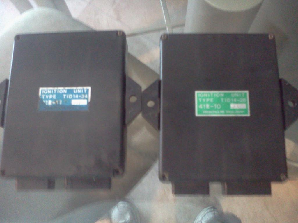

I have an 87 Venture Royal with a 41R-11 Type TID14-34 TCI unit. I just purchased a TCI unit off Ebay that is a 41R-10 Type TID14-28 that is flat out dead and I'd like to confirm its compatibility with my bike just to cover all bases before I try to return the defective TCI. The 41R-10 looks great when I took the back off so I'm really disappointed, I guess the hunt goes on for a good TCI, My unit is on the left and the Ebay unit is on the right in this picture-
My bike starts right up with the original 41R-11 TCI, but when I try the 41R-10 TCI I get nothing it just spins and spins, not even a backfire or pop of any kind so I’m guessing the 41R-11 is no good, but I’d like to there’s not a compatibility issue.

Another question I have is this unit for a different motor altogether and that is why it doesn't work on my bike? I'm fairly certain it is for a Venture other that an 83 but, mine is a 46-11 Type TID14-34, not a 46-10 Type14-28 and the tag is blue not green a minor difference I'm sure, but it might be important. I need some input from someone more knowledgeable than myself
Any of the 41R TCI's will interchange. Something internally caused Yamaha to bump the revision level. Not necessarily performance related. Could have been component change on board for some reason.

This TCI look to be in great shape much better than mine, but when I plug it in the motor just spins like it’s not even there. Curiosity is getting the better of me; I really want to desolder the board to get a look at the other side, but I doubt I could repair it

I'm amazed at how well the Ebay TCI looks, but when I desoldered the board and got a look at the other side of the board, wow what a mess. There's obviously been a small stream that flowed thru the board compleat with rust, not only the usual 8 burned out Diodes, but many resistors, you name it. This puppy's shot, no bringing it back to life, He's dead Jim. I feel a lot better about my ugly Box, my bike runs great on 3 cylinders, no 2 is giving me fits, its come down to I have to a least try a known good TCI to know for sure, it will happen some day
