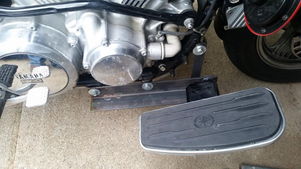

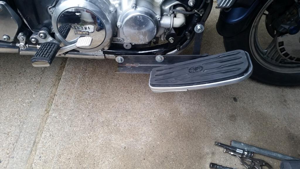

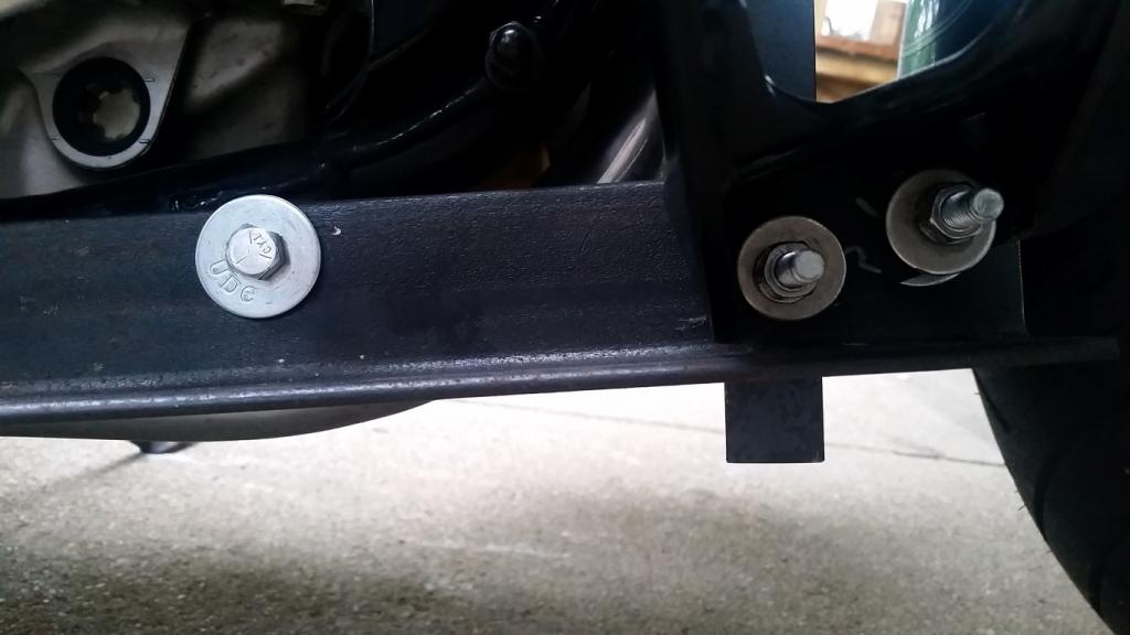

syscrusher Posted July 11, 2015 #1 Posted July 11, 2015 I just finished creating nifty brackets to hold my floorboards where I want them on my Gen 1.2. They would be far stronger if I weld them up but the bike itself is the best jig I have available. I could try mounting parts on my wood patterns but that could vary a little from the actual bike. I just don't want to fry the computer unit or the TCI with pulses or surges. Is there any advice on this? In the photo where you see the underside of the bracket I was thinking I would put a section of pipe between the parts hanging down to protect the oil filter but I think instead I will cut those off after welding and arrange for a short plate between the brackets on either side. Whatayathink? http://www.venturerider.org/forum/attachment.php?attachmentid=100567&d=1436583348 http://www.venturerider.org/forum/attachment.php?attachmentid=100568&d=1436583348 http://www.venturerider.org/forum/attachment.php?attachmentid=100569&d=1436583348 http://www.venturerider.org/forum/attachment.php?attachmentid=100570&d=1436583348
Carbon_One Posted July 11, 2015 #2 Posted July 11, 2015 I've tech welded stuff on bikes before with no issues, then removed the item for final finish welding. Larry
djh3 Posted July 11, 2015 #3 Posted July 11, 2015 Couple ways you can protect those parts. Disconnect battery, unplug the computers and you should be good to go. Discon the battery should do the biggest part of trick.
M61A1MECH Posted July 11, 2015 #4 Posted July 11, 2015 I would do As Carbon one suggesed, Tack weld them up on the bike, remove them and finish welding them off the bike, and yes diconnect the battey at least.
MiCarl Posted July 11, 2015 #5 Posted July 11, 2015 There is a welding shop in the same complex as me. The guy there is apparently very good, they send him stuff from all over the country. According to him modern DC welders pose no risk to electronics, that the older AC welders can damage them. I still disconnect all the solid state devices on bikes I have him weld, just to be extra safe.
