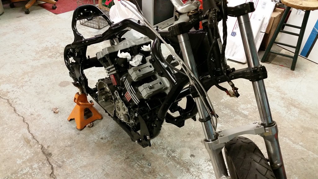

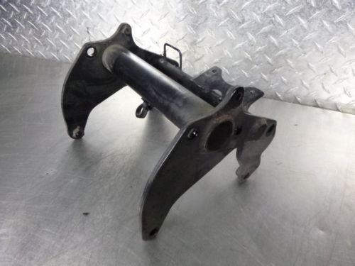

dingy Posted July 4, 2015 #7 Posted July 4, 2015 Great White said: It appears from the discussions that the issue is the engine mount. You may be able to get around the issue of the RSV down pipe is used, but I'm only guessing... Attached picture shows what I did to front motor mount. On a 2nd gen, the two plates that I have mounted on the outside of the frame rails at the front mount points are connected by 2 tubes and mounted inside the frame rails. I used long 1st gen bolts that go thru both plates with a tube that bolt passes thru to the 'exact' length between the solid mount bushings. This will allow the bolts to be tightened down without potentially causing the block mount ears to snap off. Picture of unmolested 2nd gen attached. Gary
