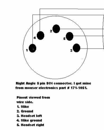

utadventure Posted June 27, 2015 #16 Posted June 27, 2015 (edited) Yamaha only uses three wires for the speakers. If I remember correctly (there is a wiring diagham on the site) plug 3 is LF, 2 is GND, and 5 is RT on the 5-pin DIN plug. Edited June 27, 2015 by utadventure

camos Posted June 28, 2015 Author #18 Posted June 28, 2015 utadventure said: Yamaha only uses three wires for the speakers. If I remember correctly (there is a wiring diagham on the site) plug 3 is LF, 2 is GND, and 5 is RT on the 5-pin DIN plug. [ATTACH=CONFIG]100237[/ATTACH]Had a look in the junk box in the house and didn't find a keyboard cable but could be one in the junk box in the shed. Those things are really old. Did find a conversion adapter to a PS2 port though. Tested it and seems to fit into the holes but is too fat to go all the way in but a bit of a trim should make it work. I'll see if I can open it up without damaging the wires. Might only have to buy a 3.5 mm stereo plug. If I don't have to buy an adapter I just might be able to afford that Sena mic base. Whoo-Hoo!!! Things are looking up.
