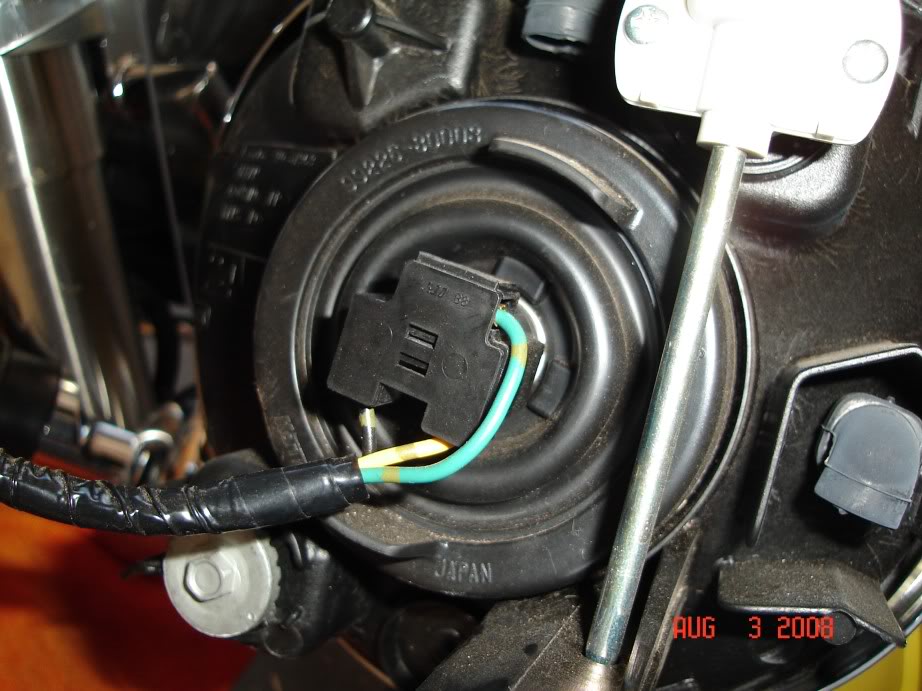

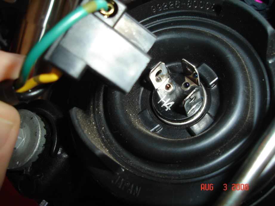

M61A1MECH Posted June 20, 2015 #1 Posted June 20, 2015 I have had a request to make an adapter that will plug into the headlight connecter, so the wiring can be extended to facilite the install of a different headlight. The owner does not want to tap into or cut off the existing wiring, he wants to extend it. I can supply all of that easy enough , but thought it would be nice to use the correct colored wires, green, yellow and black, in the correct locations. I do not have a Venture any more so I cannot just go to the garage and look, so I was hoping someone would have a photo showing the correct placement for each color. If not I will have the requestor check for me, before I build the unit. Thanks for any help.
Eck Posted June 20, 2015 #2 Posted June 20, 2015 (edited) Not sure if you can find a clear enough picture within this PDF file or not for what you are looking for. Hope it helps.. http://m.yamahaventure.nl/pdf/99-09xvz13tfelectricalinfo.pdf Here are a couple pics but not sure they will help. Edited June 20, 2015 by Eck
camos Posted June 20, 2015 #3 Posted June 20, 2015 I have had a request to make an adapter that will plug into the headlight connecter, so the wiring can be extended to facilite the install of a different headlight.Male and female H4 plugs should be available at most auto supply stores so you could make your own extension. Oops, guess you know that. Didn't read the title about a pic.
M61A1MECH Posted June 20, 2015 Author #4 Posted June 20, 2015 Not sure if you can find a clear enough picture within this PDF file or not for what you are looking for. Hope it helps.. http://m.yamahaventure.nl/pdf/99-09xvz13tfelectricalinfo.pdf Here are a couple pics but not sure they will help. Hey thanks Eck, I had found hose same photos, late last night or more corectly very early this morning, and was convinced they did not give what I needed, but I am glad you posted them again because looking at the first one, 'i can can just barely make out the black wire in the lower left, so that was one of the the pieces of the puzzle I was needing. The second photo I could not tell for sure if the connector had been rotated after being taken off, now I can tell it was just lifted straight off.
Eck Posted June 20, 2015 #5 Posted June 20, 2015 .................The second photo I could not tell for sure if the connector had been rotated after being taken off, now I can tell it was just lifted straight off. You can tell that the connector was pulled straight off. The ground (green wire) ALWAYS goes to the center tab (which is turned opposite of the other two tabs) as seen in photo# 1925
