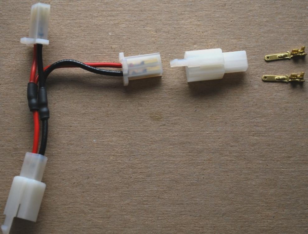

M61A1MECH Posted June 1, 2015 #3 Posted June 1, 2015 The power outlet (cigarette lighter type socket) on the inside of the fairing is switched with the ignition. In side the fairing is a two pin connector that feeds the power outlet. I sell a "T" harness that will let you tap into that circuit, all you need to do is add two contacts to your GPS power harness and insert them into the connector I provide. Cost is $13.00 delivered to the lower 48, add $5.00 to deliver to Canada. Here is photo.
GFRicky Posted June 1, 2015 Author #4 Posted June 1, 2015 I like that set up M61A1MECH. I will send you a PM so you can send one out to me. I like the clean look of this ease of install. The less cutting into the harness the better. Thanks.
