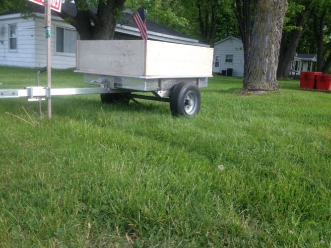

pbjman Posted May 25, 2015 #1 Posted May 25, 2015 Nice aluminum trailer solid mount; no springs. good or bad to pull behind motorcycle?
slowrollwv Posted May 25, 2015 #2 Posted May 25, 2015 I would not pull it. It would bounce and dart left or right on every bump.
etcswjoe Posted May 25, 2015 #3 Posted May 25, 2015 slowrollwv said: I would not pull it. It would bounce and dart left or right on every bump. Same here but if the price is right you might look at modifying it to meet your needs.
djh3 Posted May 25, 2015 #4 Posted May 25, 2015 I was thinkin same thing. The one I had years ago with springs seemed to bounce alot. We have tractor supply here in Fla, fleet and farm is like it up north. They carry some trailer parts. Looks to have a nice piece of box tube there to mount up springs.
pbjman Posted May 25, 2015 Author #5 Posted May 25, 2015 djh3 said: I was thinkin same thing. The one I had years ago with springs seemed to bounce alot. We have tractor supply here in Fla, fleet and farm is like it up north. They carry some trailer parts. Looks to have a nice piece of box tube there to mount up springs. so was it bouncy with springs or did you mean to say without?
dacheedah Posted May 25, 2015 #6 Posted May 25, 2015 I agree with adding springs or a torsion axle. Remember here it's not better to go big but to fit the load. If it has an axle some small springs and mount the axle ontop the springs will serve you nicely. You may also be able to upsize your tires for a better ride and level off the trailer.
Flyinfool Posted May 25, 2015 #7 Posted May 25, 2015 I looks a little on the heavy side. You do not want to use up all your towing capacity on an empty trailer. It looks like it may have had leaf springs once upon a time. If so it would be easy to add some back in.
ragtop69gs Posted May 25, 2015 #8 Posted May 25, 2015 Looks good to pull behind the lawn tractor:happy34:
billmac Posted May 25, 2015 #9 Posted May 25, 2015 don't look like something to pull behind your bike.
djh3 Posted May 25, 2015 #10 Posted May 25, 2015 Mine had springs. I think one maybe a leaf and half and like 8" tires. Pulled nice put some of them Tx and La roads bounced it pretty good, even loaded.
pbjman Posted May 25, 2015 Author #11 Posted May 25, 2015 It could be had for $200, but I am not going to bite right now....it would need leaf springs, fenders, lights, a spare tire, and a lid or some sort of top. It was hand built by a real craftsman, though. Very sturdy and quite light. (all aluminum except for the coupler, removable cedar wood sides, and axle) It even has a tilt/dump hinge. And yes, it was used behind a garden tractor.
djh3 Posted May 26, 2015 #12 Posted May 26, 2015 Fenders pretty easy. My little home built that the fellow made for me. He used like a 20" plastic round tub of some sort and cut it in half and mounted over the tires with a few rivets. nothing says they got to be metal right?
ragtop69gs Posted May 26, 2015 #13 Posted May 26, 2015 Some 600# torsion stubs would bolt right on. That's what is under my aluminum cargo trailer.
