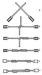

RobRiguez Posted May 27, 2015 Posted May 27, 2015 Also, make sure the tip of your iron is clean and tinned prior to heating the wires as well. This will help transfer heat to the wires faster and keep the new solder on the wires and not stick to the tip. 1 - Try to make sure your hands/fingers are clean and oil free. 2 - Try to expose up to an inch of clean wire. 3 - Cut your heat shrink tube at least 1/4" longer than your bare wire joint. Slide your heat shrink tube on before you twist the wires. Follow the diagram above. 4 - If you have rosin, brush a little on the twisted wire. If you dont have rosin, make sure you have rosin core soldering wire. 5 - Clean, Heat, and tin the tip of your iron 6 - Heat the wire at the twist and try your best to melt the solder into the wire. You should not be touching the iron to the solder at all. 7 - If you have a clumpy mess, try to quickly rub the iron over the joint to smooth the solder out, clean the tip, repeat. 8 - Slide heat shrink over joint, use a flame (I find butane torch or heat gun to work the best) to shrink the tube.

rbig1 Posted July 3, 2015 Posted July 3, 2015 back in the day it was called a western union splice used on telegraph wires. that's the one venturous posted. it had seven wraps per side dang tough. if you take apart a splice on wiring ground on bike they used small copper Ferrell. no solder, as that makes wire stiff and brakes easer.
