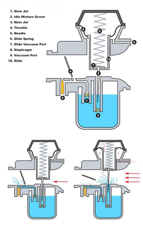

Examine the slide diaphragms carefully for tears and pinholes. Lightly stretch and straighten each diaphragm along with a strong backlight to reveal perforations.
Closely examine each slide for cracks. Hold the slide upright (diaphragm up), plug the vacuum port (at the now bottom of the slide) with a finger tip and pour gasoline into the slide interior. Cracks will manifest as gasoline leaking (seeping) out the slide side.
Clean the bore of carb body where the slide is supposed to, um, slide.
Check all the diaphragm/slide return springs for identical at rest length.
The vacuum path is fairly short and simple. Air passing through the venturi creates a negative pressure (vacuum). The vacuum port on the end of the slide allows vacuum to be applied to the outer diaphragm chamber. This raises the slide. Any leakage due to a perforated diaphragm or a cracked slide or misplaced diaphragm lip (allowing leakage to atmospheric pressure around the diaphragm cap) will mean there is not enough vacuum generated to overcome the return spring force.
Since you mentioned the "pea shooter" method of cleaning, you are probably aware that there is a more thorough, but similar method, variously called "the shotgun" or "shotgunning". You apparently haven't tried the shotgun yet. There is a 50/50 chance that you may get the pilot jet (the real culprit) clean enough with the "shotgun".
Edited by Prairiehammer
