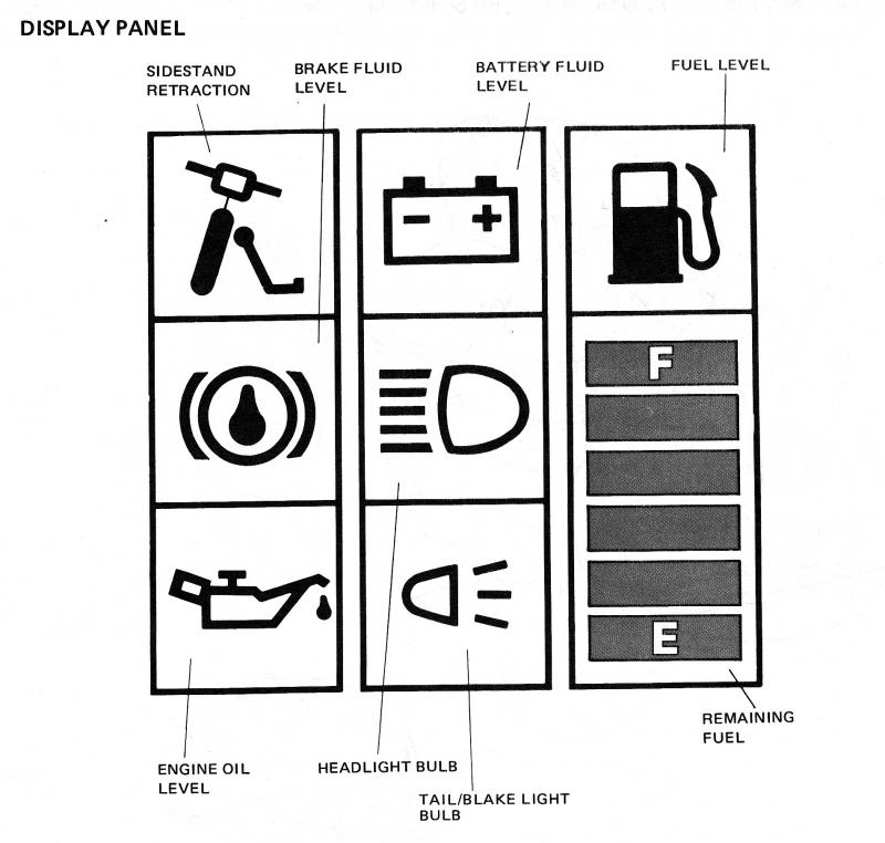

Prairiehammer Posted April 29, 2015 #32 Posted April 29, 2015 Top two lights on left, on control panel, are on. Here is a graphic of the CMS and it's icons.

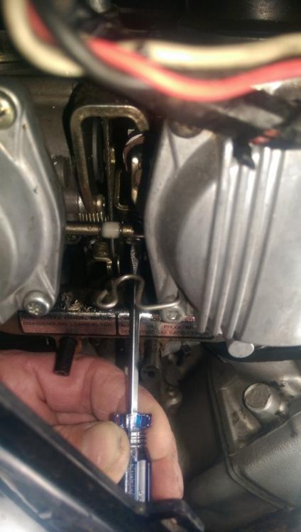

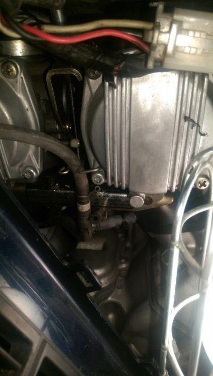

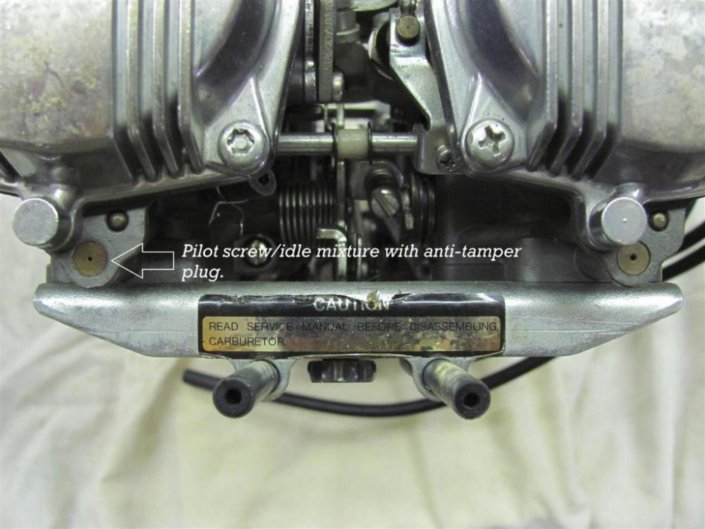

kinsmd69 Posted May 8, 2015 Author #47 Posted May 8, 2015 Ok. Have all new plugs, all firing. no problems. Cant find linkage screw, as mentioned above. Looked into manual, no" linkage screw to adjust," (all other jets and screws, none as linkage). Has a tear down view of carbs. Found pilot screw and jet. No problems with panel lights, all off and everything running ok, except carbs. Still cant ride bike, cause of shoulder.
Patch Posted May 9, 2015 #48 Posted May 9, 2015 Ok. Have all new plugs, all firing. no problems. Cant find linkage screw, as mentioned above. Looked into manual, no" linkage screw to adjust," (all other jets and screws, none as linkage). Has a tear down view of carbs. Found pilot screw and jet. No problems with panel lights, all off and everything running ok, except carbs. Still cant ride bike, cause of shoulder. kneeling down on the left side of the bike, looking at the carb caps, move the small black vacuum tube by pulling it forward and out of the way- cast your eye past the stainless U-shaped clip, just to the right of the cable hub, you see a slotted screw! That is the screw you need to turn, 1 turn, then start the engine, let us know if there is a difference in the RPM and then the temp. See the pictures below:
kinsmd69 Posted May 10, 2015 Author #49 Posted May 10, 2015 ok, that screw at bottom of a plounger plate, it wouldn't screw in at all, so its all the way in. I screwed it back one full turn and the idle picked up. Is there a set place it should be at, to start a good adjustment? The no. 1 carb has vacuum in the plug, but there is no change/decrease in idle when I pull plug off. The no. 3 carb has straightened out, so 2,3,4 carbs all have vacuum and lose approximately half idle when plug on intake cover is removed. Only no. 1 still has no change. Bike is idling at 1000 good and strong, since 3 picked up. But no 1 cylinder is still slower at getting hot in top half, but does warm up. Membership on its way.
Patch Posted May 12, 2015 #50 Posted May 12, 2015 Well outside of the choke I can't think of any other setting that should be set to a max? For general knowledge I'll mention this, before syncing carbs it's important to do basics, like a tune-up checking for heat on the pipes to make sure each cylinder is firing. If we use vacuum to sync not knowing if a cylinder is firing we end up with what you describe. I assume you turned the correct screw? What you described it pilot? If it were me I would do the following: check compression to to get it out of the way and off the check list: then I would pull the carbs and open #1 remove the jet body/housing, (do not force it, if it doesn't lift off spray some penetrating oil and let it soak) remember to remove the large brass slotted screw first: when looking in there with a light, there is one passage you need to confirm is open, holding it flat side down, the small passage on the right, move your light to the corner away from you and to the right, look through the passage you should see light, not a lot of it but a pin hole., If it's blocked there it will likely also be blocked in the barrel. Wash it out, a twist tie from a garbage bags will help,(remove the rapping to just have the wire for about 2") but only use it if you believe it is blocked. Wash the barrel as well, now spray carb clean into each ports where the jet body sits, you will need a fine air gun tube attached to the compressor 90ish lbs. Now carefully blow air though each passage and,,,, make sure it is traveling through not just blowing back at you! Do not blow air at a float. You have of course by this time checked the float valve seat; so reassemble but this time do a bench sink, before re installing them. The heating you speak of at #1 is thermal passage transfer not what we need, it needs to achieve 150- 160 within 3 or 4 minutes without choke. Patch
