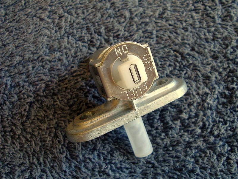

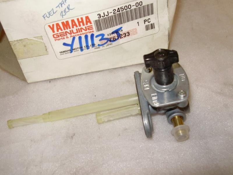

Prairiehammer Posted April 21, 2015 #2 Posted April 21, 2015 There is a difference in fuel petcocks and fuel pump circuitry between 1983 (as your post title indicates) and 1984 (as your profile indicates). What is the full VIN of your bike? Look on the lower frame rail beneath the brake pedal. The 1983 fuel petcock is tool operated and hidden behind the right side cover. The 1984 petcock has a hand operable knob and is visible with the side cover on. The 1984 fuel pump circuitry has two relays, the fuel pump relay and the fuel pump control unit.
kinsmd69 Posted April 21, 2015 Author #3 Posted April 21, 2015 Prairiehammer, thanks for the response. I actually have both. Bought a 84 project, then came across a 83. Found both fuel petcocks. what tool do u use for the 83? Would channel locks be ok, or 3/8 wrencth? The line in the petcock is in vertical pos. Is that off, on, or reserve? The 84 is in a horizontal position, which one is that? Are the two years the same? Thanks again! I feel like an idoit. Ive had bikes for 40 years, only light shadetree work, but still didn't see them. ugh!
Prairiehammer Posted April 21, 2015 #4 Posted April 21, 2015 Prairiehammer, thanks for the response. I actually have both. Bought a 84 project, then came across a 83. Found both fuel petcocks. what tool do u use for the 83? Would channel locks be ok, or 3/8 wrencth? The line in the petcock is in vertical pos. Is that off, on, or reserve? The 84 is in a horizontal position, which one is that? Are the two years the same? Thanks again! I feel like an idoit. Ive had bikes for 40 years, only light shadetree work, but still didn't see them. ugh! For the '83, either a Crescent wrench or screwdriver are needed to change from OFF to ON (there is no RESERVE on most 1983), but be warned (!) that the plastic valve is sometimes difficult to change positions without breaking the exposed part of the petcock. If the slot in the petcock is vertical it is ON. (See accompanying pic). On the 1984, there is an arrow to designate position. Broadly, if the knob is horizontal it is OFF. In the vertical position it is either ON or RES, depending on the arrow (See accompanying pic.)

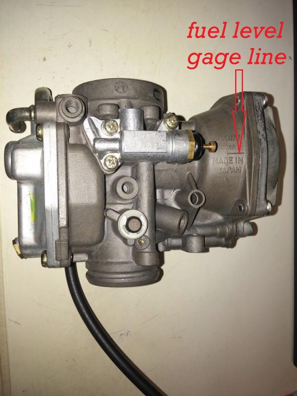

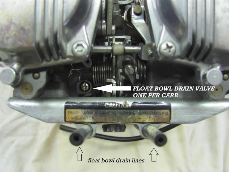

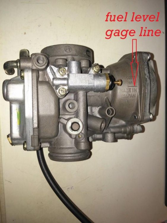

kinsmd69 Posted April 25, 2015 Author #15 Posted April 25, 2015 The fuel pump is an "on demand" pump. If the float bowls are full, the pump will not run, until there is a demand for fuel (fuel being consumed from carb float bowl). Ok, I read about checking float bowls with clear tube. Can someone show a pic of flow bowl on the carb? Is it behind the brass fitting with the jet? If float bowls are receiving enough gas, but bike wont start, like starving from fuel, and have spark, what's next? My bike only has 7500 miles on it. The PO always ran the gas out of it, followed a check list, for the winter.
Prairiehammer Posted April 25, 2015 #16 Posted April 25, 2015 Can someone show a pic of flow bowl on the carb? Is it behind the brass fitting with the jet? Here a couple pics that show where the float bowl drain lines are as well as the float bowl drain valve. Also a pic that shows the fuel level gage mark on the side of the carb body. Attach a clear hose to the drain line, open the float bowl drain valve and observe the fuel level in the clear tube. The fuel level should be 14mm ± 0.5mm (according to the 1983 Yamaha Service Manual) below the mark on the carb body.
kinsmd69 Posted April 25, 2015 Author #17 Posted April 25, 2015 Here a couple pics that show where the float bowl drain lines are as well as the float bowl drain valve. Also a pic that shows the fuel level gage mark on the side of the carb body. Attach a clear hose to the drain line, open the float bowl drain valve and observe the fuel level in the clear tube. The fuel level should be 14mm ± 0.5mm (according to the 1983 Yamaha Service Manual) below the mark on the carb body. [ATTACH=CONFIG]98970[/ATTACH] [ATTACH=CONFIG]98971[/ATTACH] Thanks for the pics. So, is the idle screw the one between the float drain lines with the big head?
Prairiehammer Posted April 25, 2015 #18 Posted April 25, 2015 Thanks for the pics. So, is the idle screw the one between the float drain lines with the big head? Yes.
