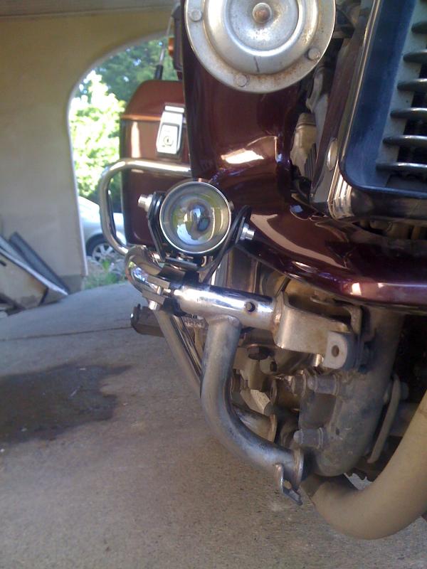

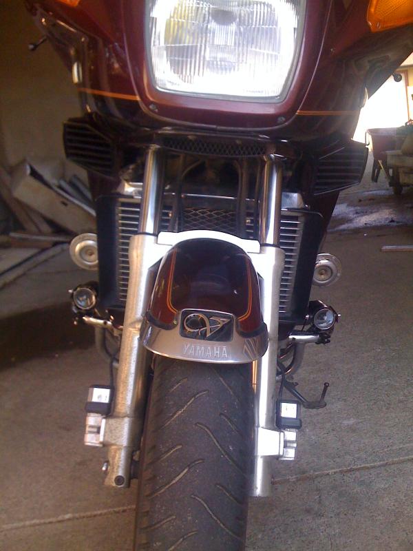

camos Posted April 9, 2015 #5 Posted April 9, 2015 (edited) What do you think? Bright enough, power use good? http://www.banggood.com/CREE-U5-Motorcycle-LED-Headlight-Waterproof-High-Power-Spot-Light-p-941300.html?utm_design=18&utm_source=emailvision&utm_medium=Mail_men128_all&utm_campaign=newsletter&utm_content=Claire I put a pair of those on my 89 VR, from a different seller but look about the same. I found mounting them was a bit of a trial because there is no lateral adjustment. Had to file the clamp mount bolts in order to point them in the right direction. Didn't want them outside the guard area. The pix show the lights without the top cover, left it off to make adjustments easier but will probably put them back on. I have the lights set to illuminate a little bit nearer than low beam and a bit to the outside which works quite well. Really wanted fogs but they come as a pencil beam. Apparently these lights have 3 modes, hi-lo-strobe, but I don't see how to change between them. For the price, I'm happy with the lights. Just looked at the photos on your link and those mounts appear to have lateral adjustment which will make them way easier to install. Edited April 9, 2015 by camos Additional info

camos Posted April 12, 2015 #8 Posted April 12, 2015 How do you switch the modes? High, low, flash. Do they cycle thru when the power is applied? I would prefer to set the desired mode and then be able to just turn them on/off without the mode changing. JimmyThere were no instructions with mine so I wired them into a relay powered by the accessory circuit so I could see if they would change mode sequentially when powered up but they didn't. When turned on, with the ignition, the lights have stayed in full power pencil mode which is what I wanted to begin with. I have a switch for them but did not want to go to the trouble of installing it to begin with and since they don't draw much having them on all the time does not appear to be a problem. These LED's make pretty good DRL's with low draw and bright light. Only wish I had found the ones in the link before purchasing as it would have been a far easier install.
