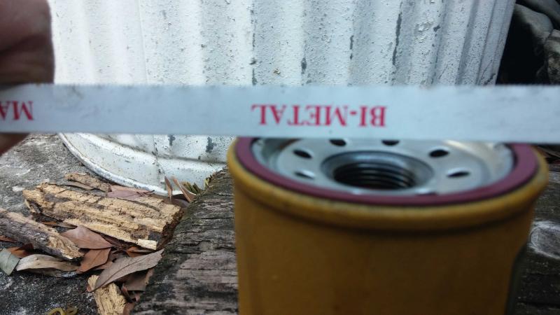

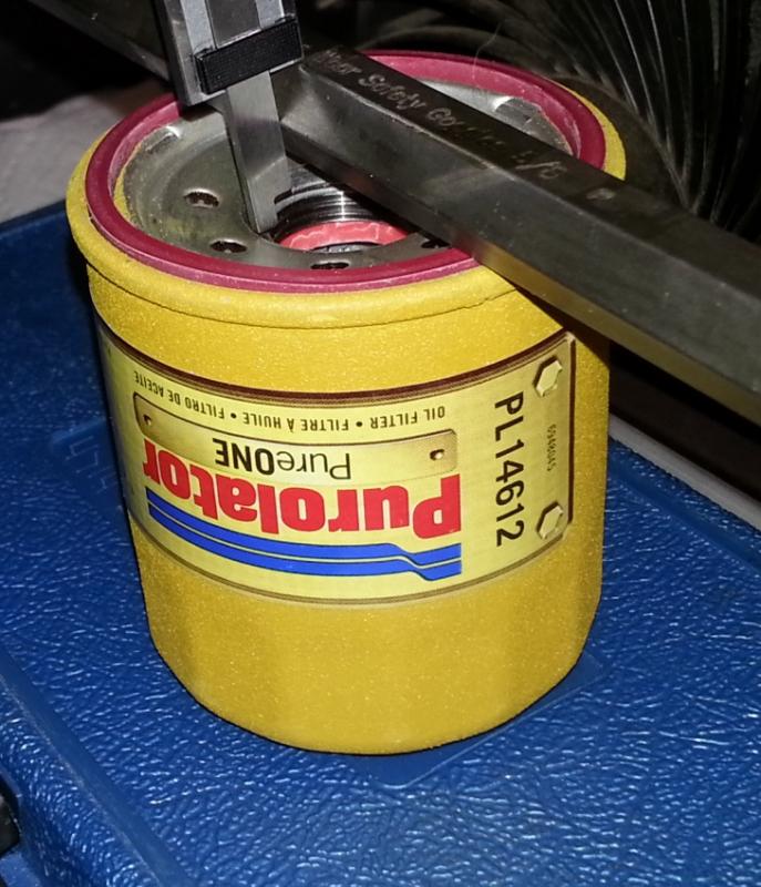

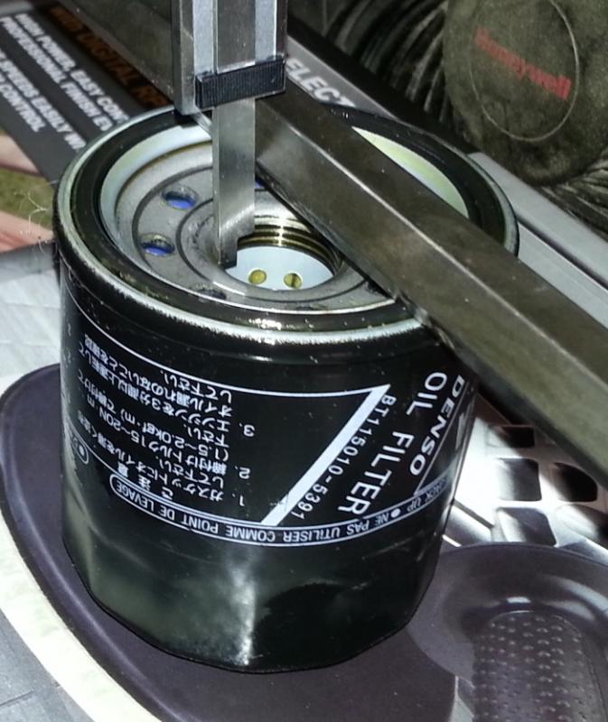

Du-Rron Posted April 6, 2015 Posted April 6, 2015 I have recently heard of two reports of a Purolator PL14612 not screwing on far enough to make a complete seal. Seems to work ok on my RSV so far... I will keep an eye out. The factory 5GH-13440-30 has a gasket to first thread depth of 0.300" The Purolator PL14612 has a gasket to first thread depth of 0.235" which is 0.065" less than a factory filter, (I know the caliper is crooked in the picture but I measured it before I took the pic.) I would suggest that you first make sure that the Union Bolt is tightened to 36 ft lbs and if you still can't get a seal it may be time to look for another filter. I have not yet had the chance to measure the depth of a PL14610. Anybody else have one they could look at and tell us?

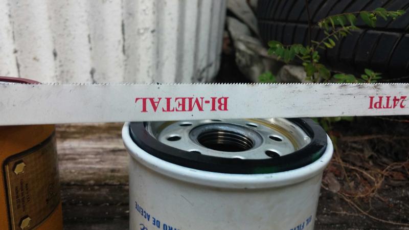

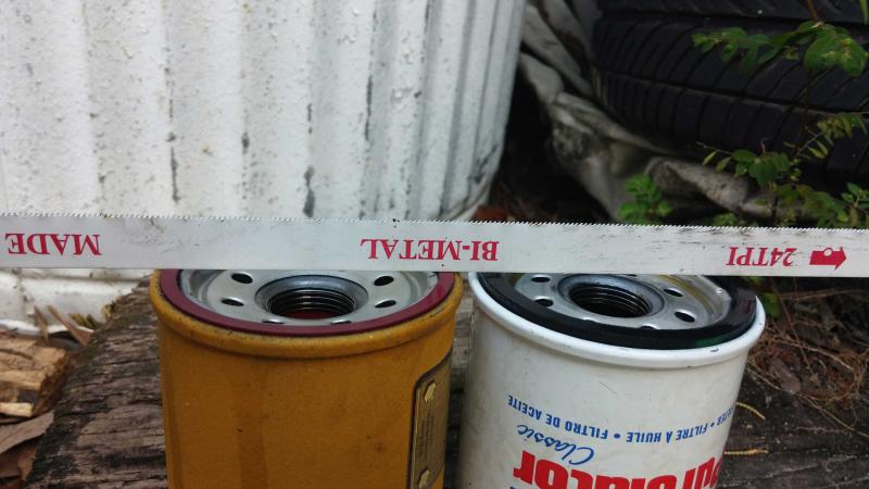

djh3 Posted April 8, 2015 Posted April 8, 2015 OK sports fans. I dug thru the trash con for only you guys so I could take these. Old style 14610. Notice "dip" where threads on. new style more flat. Thus you dont have enough clearance to get straight shot to thread on. Side by side. Maybe this helps clear it up a little.

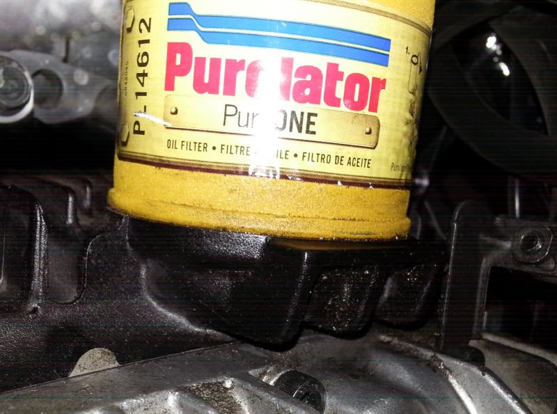

oconeedan Posted April 8, 2015 Posted April 8, 2015 (edited) YES YES YES YES YES YES!!!! Last weekend, I changed the oil for the first time on my "new to me" RSV. I bought a 14610 long white Purolator filter. I CAN"T get it started, it is a tad too long and hits the frame. Drive to town and the store is out of the white 14612, so I spend the extra $$ and get the gold 14612. Installed on the bike, and I don't like the way it feels. As soon as the filter spins on and the gasket touches, it stops turning, feels like metal to metal. I am a maintenance tech, am good with tools, and have changed oil a million times. OK, maybe a few less than a million. I was concerned enough that I put a wrench on it to tighten it (which I never do). Next day, the bike had marked it's territory, badly. I pulled off the filter, looked and couldn't see anything wrong, tried it again. Nope, wouldn't seal. So I put the old one back on, until I find one that fits right. This thread has GOOD timing. I measured the new Purolator gold filter, the distance from the top of the red gasket to the first thread is 0.350" . Are you measuring from the top of the gasket, or bottom? Our measurements don't jive, but your description of the problem is exactly what happened to me. My filter looks like djh3 's photo of the white filter. Do you reckon that Purolator put the tops on upside down? Edited April 8, 2015 by oconeedan error
Rick Haywood Posted April 8, 2015 Posted April 8, 2015 I have recently heard of two reports of a Purolator PL14612 not screwing on far enough to make a complete seal. Seems to work ok on my RSV so far... I will keep an eye out. The factory 5GH-13440-30 has a gasket to first thread depth of 0.300" [ATTACH=CONFIG]98562[/ATTACH] The Purolator PL14612 has a gasket to first thread depth of 0.235" which is 0.065" less than a factory filter, (I know the caliper is crooked in the picture but I measured it before I took the pic.) [ATTACH=CONFIG]98563[/ATTACH] I would suggest that you first make sure that the Union Bolt is tightened to 36 ft lbs and if you still can't get a seal it may be time to look for another filter. [ATTACH=CONFIG]98564[/ATTACH] I have not yet had the chance to measure the depth of a PL14610. Anybody else have one they could look at and tell us? I hve been running tht filter on my RSV for 110,000 miles with no problems
djh3 Posted April 9, 2015 Posted April 9, 2015 Cant even get them up in the space now. They hit and want to start cross threading. I put the short one on in gold one on. Ran about 180 miles today all seems OK. It tightened up fine for me. Contact and about 1/2 or 3/4 turn. I will probably cough up the coin for the Mobil 1 next time.

Du-Rron Posted April 9, 2015 Author Posted April 9, 2015 (edited) OK sports fans. I dug thru the trash con for only you guys so I could take these. [ATTACH=CONFIG]98612[/ATTACH]Old style 14610. Notice "dip" where threads on. [ATTACH=CONFIG]98613[/ATTACH]new style more flat. Thus you dont have enough clearance to get straight shot to thread on. [ATTACH=CONFIG]98614[/ATTACH]Side by side. Maybe this helps clear it up a little. Ok, now we are getting somewhere. I am going to assume that those two filters are the PL14610 (yellow) and the L14610 (white). There is clearly a difference between the two. When I cut up a L14612 ( white-short filter ) http://www.venturerider.org/forum/showthread.php?96009-Oil-Filter-Comparisons-Hey-I-m-no-Engineer the mounting plate was concave. There appears to be a difference now in the L14610 (white-long) & L14612 (yellow-short) mounting plates. The current L14610 (white-long) may be harder to fit as the plate is convex and will not funnel the Oil Filter Mounting Bolt to it, however it may still work as the mounting depth of gasket to first thread may still be the same. Your old PL14610 (yellow-long) and the PL14612 (yellow-short) that I have on my bike now both seem to have concave mounting plates. YES YES YES YES YES YES!!!! Last weekend, I changed the oil for the first time on my "new to me" RSV. I bought a 14610 long white Purolator filter. I CAN"T get it started, it is a tad too long and hits the frame. Drive to town and the store is out of the white 14612, so I spend the extra $$ and get the gold 14612. Installed on the bike, and I don't like the way it feels. As soon as the filter spins on and the gasket touches, it stops turning, feels like metal to metal. I am a maintenance tech, am good with tools, and have changed oil a million times. OK, maybe a few less than a million. I was concerned enough that I put a wrench on it to tighten it (which I never do). Next day, the bike had marked it's territory, badly. I pulled off the filter, looked and couldn't see anything wrong, tried it again. Nope, wouldn't seal. So I put the old one back on, until I find one that fits right. This thread has GOOD timing. I measured the new Purolator gold filter, the distance from the top of the red gasket to the first thread is 0.350" . Are you measuring from the top of the gasket, or bottom? Our measurements don't jive, but your description of the problem is exactly what happened to me. My filter looks like djh3 's photo of the white filter. Do you reckon that Purolator put the tops on upside down? If your PL14612 (yellow-short) has a top that now looks convex like the L14610 (white-long) then maybe Purolator mis-labeled some filters as the PL14612 (yellow-short) has always had a concave mounting flange. My measurement of 0.300" from gasket to first thread depth as shown at the beginning of this article was taken using a 4 lb pry bar atop the filter gasket (maybe 0.004" or 0.005" compressed from the weight) to the first thread depth and I was using the top of the thread to provide a minimum clearance number. However, your measurement of 0.350" would suggest a plenty of depth that would provide the ability to tighten the filter down all the way, while not hitting the Oil Filter Mounting Bolt that would impede sealing. One of my suggestions is to make sure your Oil Filter Mounting Bolt is as far in as it can go by attempting to tighten it to 36 ft lb during your next oil change. I would find this dimension to be more of a variable than how Purolator makes oil filters. When I screw my PL14612 (yellow-short) on, I have it on tight enough so that the gasket is compressed and that the metal of the filter can outside diameter is touching the Oil Filter Mounting Flange on the bike. You would have a hard time getting a 0.002" feeler gauge in there. (I am really going to have to have a talk with the fellow that cleans that bike. It's filthy under there.) Edited April 9, 2015 by Du-Rron

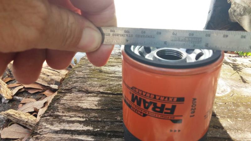

djh3 Posted April 9, 2015 Posted April 9, 2015 Well thought I had this thing fixed, but using the short filter. Today had a very small amount of oil on ground after sitting all night. Say a spot 2 quarters big. So must be something to not being able to draw it down far enough. Went by Wally World on my to run some errands. Did you know they dont handle the super tech oil filters anymore? So I ended up with a FRAM PH7317 It does have to concave threadded part and measures .254 to the top of where the thread starts.

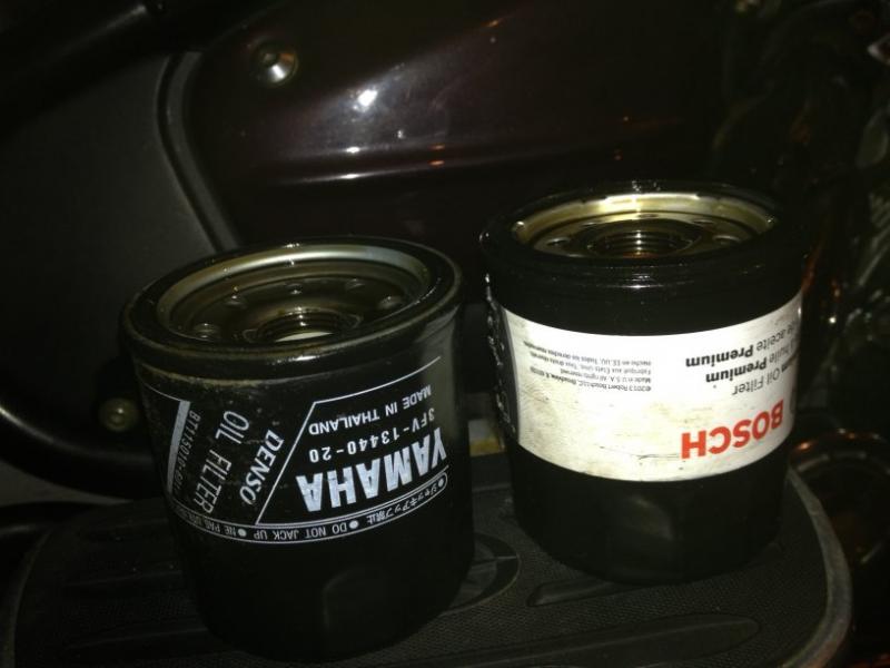

pbjman Posted April 10, 2015 Posted April 10, 2015 I bought a Bosch 3300 a few weeks ago and finally got around to installing it today. Same problem; as soon as the gasket was starting to make contact, the filter came to a hard stop and would go no more. Here's a pic of the yamaha filter I took off next to the Bosch. The oil filter bolt on my bike is all the way in; it just sticks out too far for this filter that is not concave. I guess I'll be looking for something with a concave surface tomorrow.

djh3 Posted April 10, 2015 Posted April 10, 2015 If its got the dip in it like shown you will be OK. Other wise be ready for a puddle of oil the next day. I found it odd that it did not leak under pressure. But sitting static over night I had leakage, Beats me 2 similarly built filters both short so I thought would snug up. They sure felt that way. So I gave up today and looked for 15 min at filters in Wally World. Settled on a FRAM Not my first choice for sure. As far as the ML purolator filters I dont think I have seen one.
Du-Rron Posted April 10, 2015 Author Posted April 10, 2015 Well thought I had this thing fixed, but using the short filter. Today had a very small amount of oil on ground after sitting all night. Say a spot 2 quarters big. So must be something to not being able to draw it down far enough. Went by Wally World on my to run some errands. Did you know they dont handle the super tech oil filters anymore? So I ended up with a FRAM PH7317 It does have to concave threadded part and measures .254 to the top of where the thread starts. [ATTACH=CONFIG]98651[/ATTACH] Ichieee Waaa Waaa... a FRAM Filter?!?!?! a Fram PH7317 filter?!?!?!?!? If you have a 2009 Royal Start Venture then Fram recommends a PH6017A. I do not know what a PH7317 fits. Please don't put this filter on your bike.
