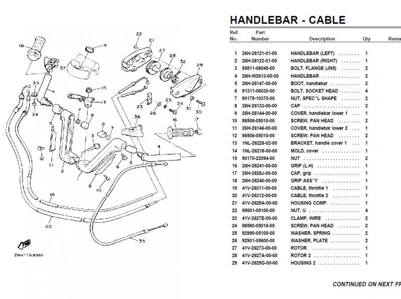

dingy Posted April 4, 2015 Posted April 4, 2015 Switching them at the carbs is not possible due to different barrel clamps on the end of cables that attach to the throttle linkages. What may be incorrect is the way the throttle cables are assembled at the junction block where the cruise control ties in. These all have similar ends and could be mis-assembled. Attached picture from parts fiche shows upper cables to junction box, all I could find that is useful. Gary

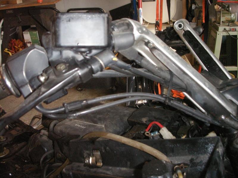

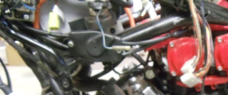

dingy Posted April 4, 2015 Posted April 4, 2015 1st picture is from an 88 that I got from MiCarl that now partially lives in Tweety. Shows connections at throttle. 2nd picture shows that exiting throttle junction block, that cable to carbs that has in line adjuster is on top. Based on this post and previous one, you should be able to determine correct configuration of cables. Gary
