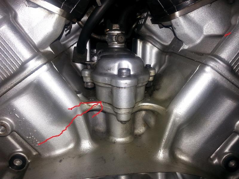

DarrinGT Posted March 31, 2015 #1 Posted March 31, 2015 Near the end of last riding season I was seeing a little antifreeze leaking coming from behind the left side engine covers. So I an getting it ready for this season and the leak seems to be coming from a housing nestled between the "V" of the motor. I just don't know what it is,.. Here is a pic of where it is leaking: So what is this thing, what does it do, and how hard is ot to get out and replace the gaskets? Just want to see what I am geting into before tearing it apart. Thanks!
M61A1MECH Posted April 1, 2015 #2 Posted April 1, 2015 It is part of the cooling system, everyone calls it the Twinkie, the parts catalog calls it a cover, there is an upper and lower cover with gaskets in between them and the block. Here is a link that shows the parts involved. Not sure how you get it out, never had to do that on either of my two Royals. Items 35, 36, 37, 41. http://www.yamahapartsandaccessories.com/parts-catalog/parts/street-mcy?ls=Street&dealernumber=#/Yamaha/XVZ13ATJ_-_1997/RADIATOR_HOSE/XVZ13ATJ_(1997_MOTORCYCLE)/RADIATOR_HOSE_(XVZ13ATJ_-_1997)
DarrinGT Posted April 1, 2015 Author #3 Posted April 1, 2015 Thanks Steve, Calling it a Twinkie makes sense to me! I did see that diagram yesterday and looks like I can get the gaskets. Still wondering what it does, and if it comes out of there without removing the Carbs. Planning on working on it on Saturday, so just seeing what I am getting into. Thanks again,..
Condor Posted April 1, 2015 #4 Posted April 1, 2015 DarrinGT said: Thanks Steve, Calling it a Twinkie makes sense to me! I did see that diagram yesterday and looks like I can get the gaskets. Still wondering what it does, and if it comes out of there without removing the Carbs. Planning on working on it on Saturday, so just seeing what I am getting into. Thanks again,.. Pretty sure it's a heat exchanger between the coolant and the oil... May keep the oil temp down a bit?? Or get the oil to flow quicker on cold mornings?? Or???
DarrinGT Posted April 2, 2015 Author #5 Posted April 2, 2015 Yup that makes sends Condor, Thanks, So for now I decided, it is 62 deg and sunny, it is barely leaking, so we said screw it, put it back together and got in our first ride of the season. We got 125 miles in this evening with 3 other couples and thier bikes. Great first ride. ! ill watch it and see if it gets any worse. Thanks guys

DarrinGT Posted March 16, 2016 Author #8 Posted March 16, 2016 So, Almost a Year Later, I decided to fix the leak, Drove it all last summer with no issues, just kept an eye on the coolant level. I had to tear into it to answer my own questions, it happens, so if anyone else needs to reseal the Heat Exchanger here ya go. Sorry, no pics. No, you can not remove the Twinkie with out removing the Carbs. I tried, but to no avail, just make it easy on yourself, disassemble the bike and enough to have the carbs removed. You dont have to take the carb boots off. There is a Oil flow Tube that runs up into the heat exchanger and down into the motor, you have to be able to lift up the heat exchanger high enough to clear that tube. It simply pops in and out. Once out it is easy enough to clean and replace both top cover and bottom unit gaskets. Getting some other things done on the bike along the way getting it ready for Spring,.. Later..

DarrinGT Posted March 16, 2016 Author #11 Posted March 16, 2016 I finished up the job today, After I removed the twinkie I was doing some cleaning up in that area, it is almost impossible not to spill Antifreeze down the Oil Gap. So today I drained, flushed, and filled the oil a few times to clear out any antifreeze, then filled it with new Syhtnetic. I plan on doing another oil change in about 500 miles or so just to be safe. So the bike is back together and running, Done with that project, now on to a rear end Re Gear, new front tire, windshield and other misc maintenance,..
