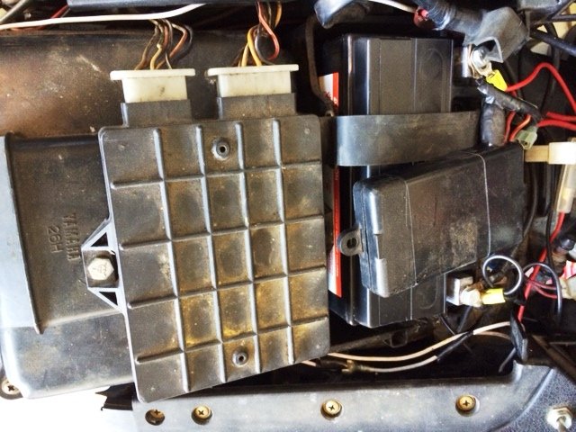

KIC Posted March 21, 2015 Posted March 21, 2015 I couldn't find a picture of the TCI mounted after being moved on an earlier search. So, this past weekend I had the chance to work on my son-in-laws 86 that he bought from 1Rooster. His TCI had been moved so I snapped a picture of it. My understanding is that if you cut one tab off of the TCI it will fit nicely and easier to remove by cutting the tabs off.
videoarizona Posted March 21, 2015 Posted March 21, 2015 Thanks for the picture, Bill. That's bigger than I was thinking....
