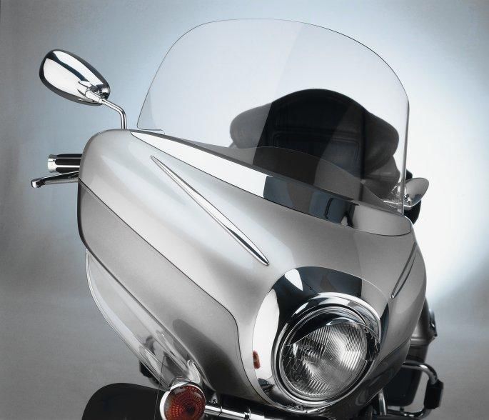

Zzyzx Posted March 16, 2015 Posted March 16, 2015 (edited) Cut mine down early last year but I didn't like the added buffering on longer rides so I picked up a Show Chrome 13" windshield before by trip last year and love it. (specs below) I like the wider and shorter look and is comfortable riding with it in most weather conditions. These run from $100 to 125.00 average and come in clear and smoke tint. This stylish clear windshield for the Yamaha Royal Star Venture is 2-1/2" wider per side and 4" shorter than stock OEM windshields. A windshield height of 13" gives it a lower profile for a “sporty” look. Manufactured from 3/16" thick transparent Lucite DOT approved acrylic. Made in USA. •4" Shorter (13" tall installed height), •2 1/2" Wider •3/16" Lucite DOT Acrylic Also available in smoke tint. Fits Yamaha Royal Star Venture - all model years Part number 20-610 by Show Chrome. Edited March 16, 2015 by Zzyzx
