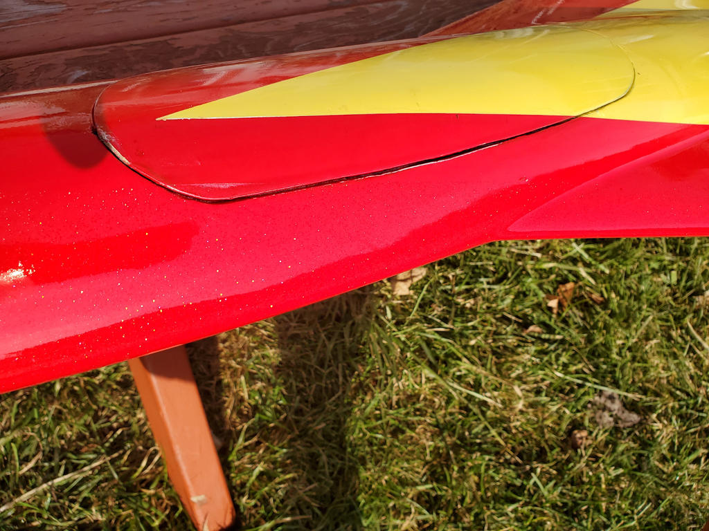

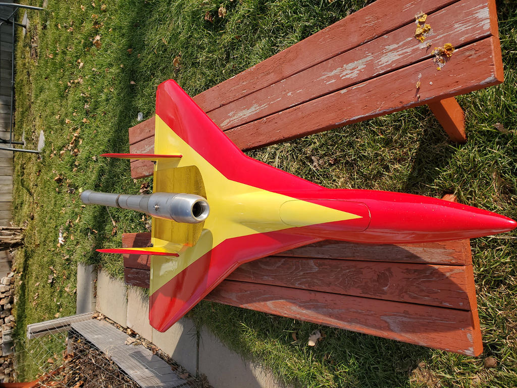

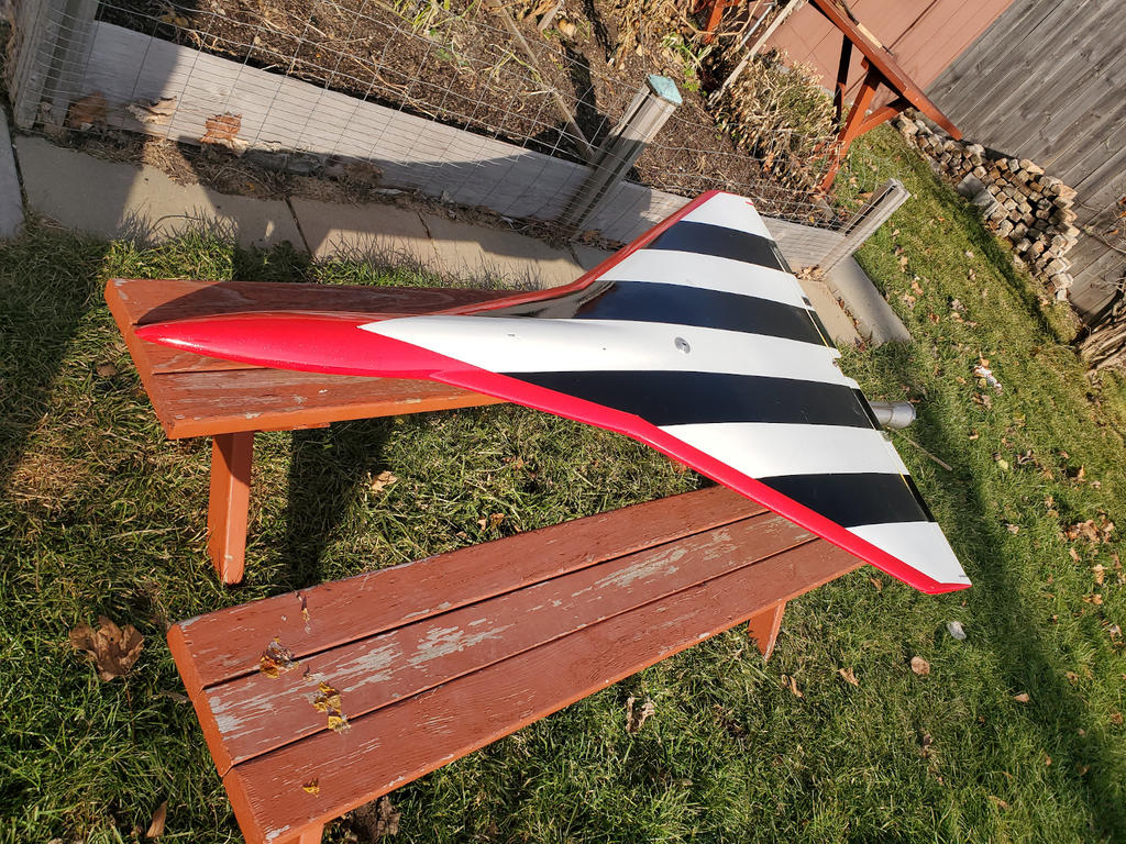

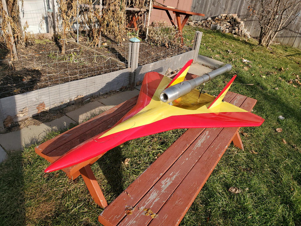

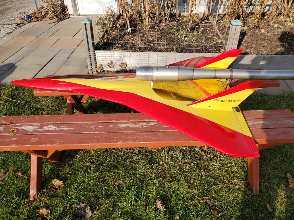

Flyinfool Posted December 9, 2019 Author #62 Posted December 9, 2019 And now for the drum roll please................,..., The pics of the paint job you have been waiting for...................... This was the first time the sun came out since I painted it. It looks good as long as you don't look closely at it anywhere. The camera did not capture the metal flake in the red very well, that part looks better in person. 1
