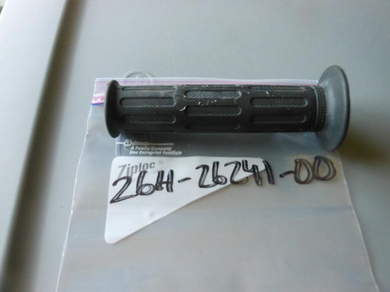

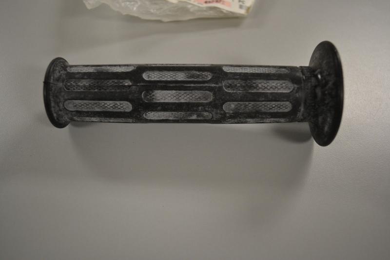

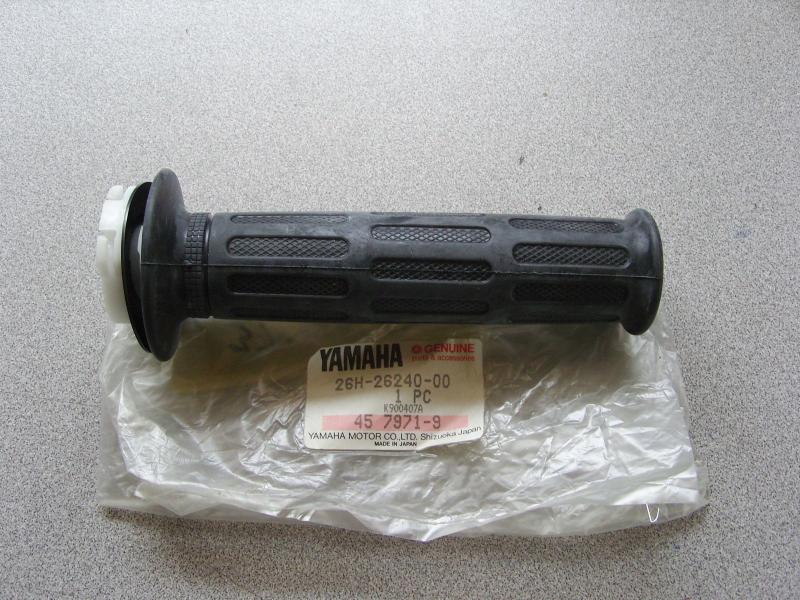

Stock grips are pictured below. There are a couple of NOS grips on eBay. Seven-eighths is bar diameter, but be aware, because of the throttle tube on the right grip, that there is a right and there is a left. One other point about grips for the First Gen: the stock grips are longer than most Yamaha grips of the era. Nearly six inches long if IIRC. If you elect to go with aftermarket grips, those that are advertized to fit a GL1500 will fit the Venture perfectly for diameter and length.
1984 1993 Yamaha XVZ1200 XVZ1300 Venture Royale Left Grip 26H 26241 00 | eBay
Yamaha Grip Assembly 84 85 XVZ1200 86 93 XVZ1300 26H 26240 00 00 | eBay
Yamaha Hand Grip LH XVZ12 Venture Royal 26H 26241 00 00 | eBay
