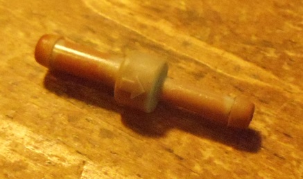

dingy Posted March 4, 2015 #3 Posted March 4, 2015 Auto Zone sells a similar item that can be used to replace restrictor. The stock one also serves to connect 2 different ID vacuum lines together. 2 different size hoses are not needed when intake boot is used as vacuum source. AutoZone also sells a rubber plug that can be used to block port on #2 carb. Don't have that P/N handy. Gary

dingy Posted March 10, 2015 #8 Posted March 10, 2015 frankd said: Gary, Did you restrict the connector or just install it as is? If you filled in the connector with something, what did you use? I'm considering a blob of RTV type instant gasket/sealant with a toothpick pushed through it. Then when the sealant cures a bit, just rotate the toothpick and remove it leaving a small hole. The restrictor I listed above has a narrowing in tube. There would be no need to modify it. Gary
