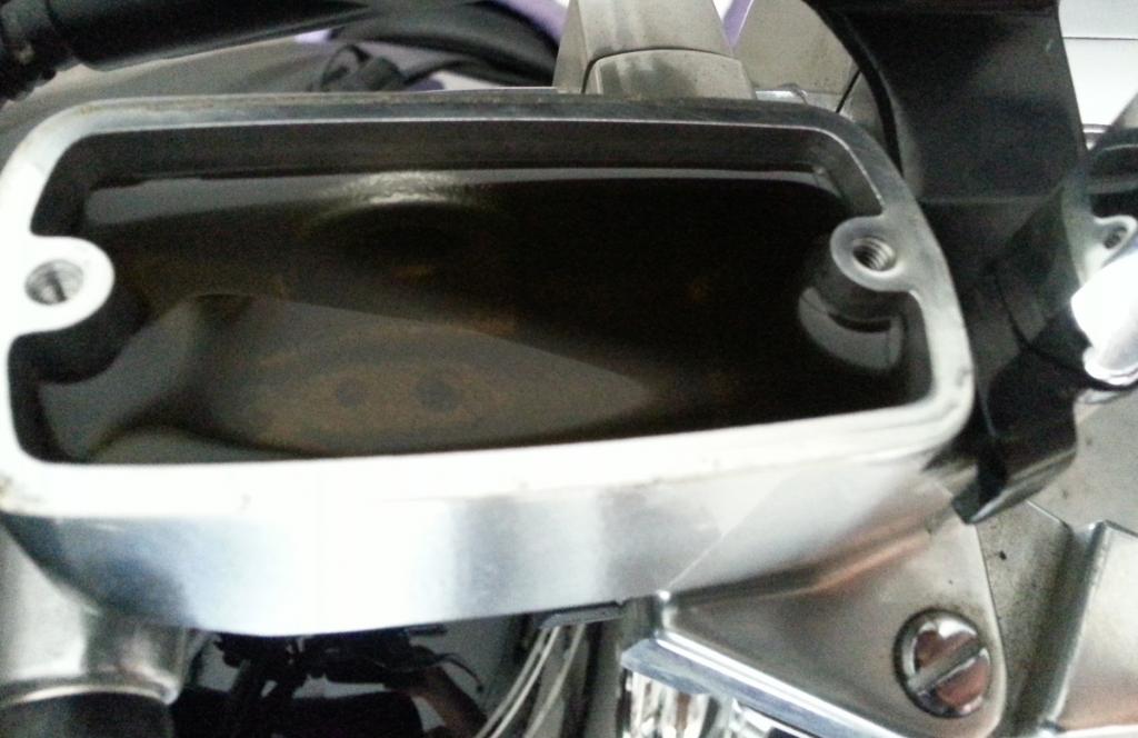

Du-Rron Posted February 14, 2015 #1 Posted February 14, 2015 (edited) On 10-7-14 when I bought my 2012 RSV I thought it had one of the best "feeling" clutch action I have ever experienced. By the time the 600 mile service came around about ten days later the clutch action had worsened considerably. The clutch fluid was two years old when I bought the bike new and was black and nasty looking. I flushed and bled the clutch and it again "felt" great. On 2-10-15 about 4 months later when I had 5000 miles on the bike I was noticing the clutch action no longer was "feeling" good. I inspected the clutch fluid and again found that it had baked itself black again. The clutch action on this bike is largely determined by the "newness" of the fluid. I again flushed and bled the clutch and the "feeling" again returned to "brand new". I began looking for any area on the clutch route that could be exposed to high heat. I found the most likely location to be exposed to radiant heat was to be the location 1" away from the exhaust pipe on Cyl #2 . Behind the rubber cover is a steel clutch fluid line that is most likely to take a lot of radiant heat. I took some "Heavy Duty" foil from the kitchen and cut a 16" X 6" piece. I then folded the foil (shiny side out) to make a 4" X 6" piece out of it. I then wrapped the foil around the clutch line at Cyl #2 . The cost was next to nothing and the time spent was about ten minutes. I am hoping that by providing a radiant heat shield to the clutch line that the fluid will last a little longer and the clutch "feel" will last longer. Edited February 14, 2015 by Du-Rron

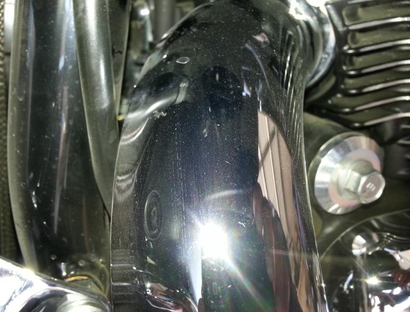

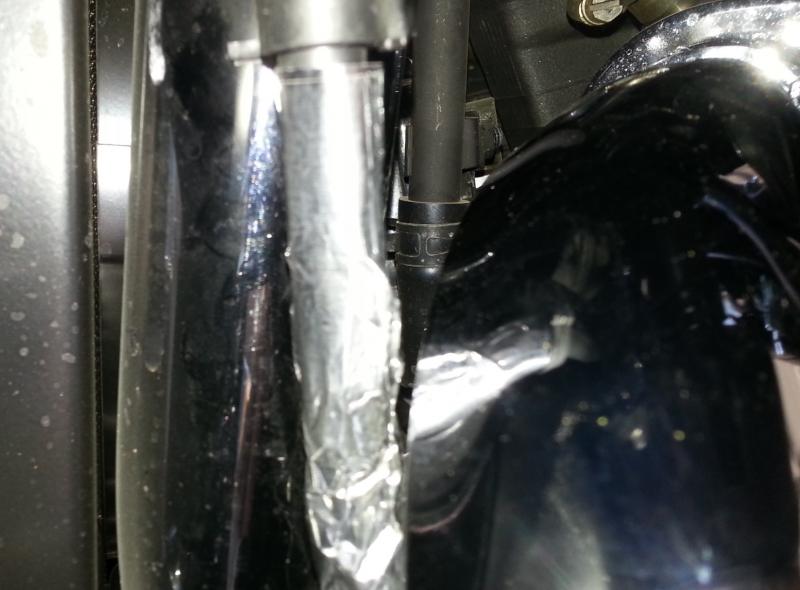

V7Goose Posted February 16, 2015 #5 Posted February 16, 2015 [snip] The boiling point of DOT4 is around 350 wet and if you ever hit that just once, your brake fluid is toast. Interestingly, its flash point is just a little over 250 PMCC. Once you hit 250 you slowly start deteriorating your brake fluid. (see enclosed MSDS). At this point in time, I believe that a radiant heat problem may exist due to my riding style and the location of the clutch pipe 1" away from Cyl2. No harm, no foul by trying a no-cost heat shield for a few months to see what happens. I've got four years eight months and no miles limit warranty to figure it out if it starts becoming a real problem. Du-Rron, I do not doubt that you have experienced the problems you state - no reason to try and prove it to me. But if you HAVE experienced them, I DO believe there is something wrong with your bike. It is not where you live (I lived in Texas also for the first 100,000 miles on my RSV), and it is not how you ride (I rode to work daily in all weather, and I did lots of distance touring, including at least 3 different 1,000+ mile stretches in under 24 hours where the engine spent MANY hours straight pushing my loaded bike at 85-95 MPH). All I am trying to state is that you are not doing anything that thousands of other owners have not been doing, yet we do not experience the same thing. I do, however, believe that you have made a couple of misstatements and wrong assumptions about brake and clutch fluids. AFAIK brake fluids are absolutely NOT "toast" just because you hit the wet boiling point one time. This used to be a very common occurrence in the mountains, especially before DOT4 fluid was introduced. The significance of the "wet" figure is that old fluid that has absorbed moisture (that is what the "wet" means) will have the moisture convert to steam at that temp which basically makes your brakes totally unusable UNTIL the fluid cools down, then they behave normally again. I am not saying that heat cannot hurt brake fluid, just not the way you state. My last comment for you to consider is that there are many many riders who NEVER change their clutch fluid, even very high mileage riders, and despite the fact that it is called for every two years in the manual. And those individuals, despite having really nasty fluid in their bikes, STILL do not experience the problems you have stated. Just more evidence why I personally suspect you have a defect with your bike. If you want to ride out here to the southern mountains in New Mexico, I'll be happy to try and help you figure it out - and it is just possible I can give you quite a bit more info about this particular bike that you have not yet absorbed from this site. No mater what, I wish you the best of luck in resolving your problems. Goose
Du-Rron Posted February 16, 2015 Author #6 Posted February 16, 2015 LOL - you don't know me too well. I work at Toyota and our plant makes Corolla, RAV4, and Lexus RX350 in the I.T. department. I'm not a mechanic but do my own work on the bike or have local members help me when I'm not sure of something. My knowledge on the Venture is from reading the forums and tech notes. Your clutch fluid changing colours so quickly isn't "the nature of the beast". What you have is an abnormal condition. Pretty sure I've done about 20,000 km since my last fluid change which included a 10,000 km trip that included a lot of clutch work (eg getting to the top of the Mt. Rushmore observation area, the Bear Tooth....) and although I'm due to change it in the spring, my fluid is slightly golden but not black. Your Venture is still under warranty until at least 2017 (5 years from original purchase). Explain to the dealer what has been happening and ask them to fix it. If they say it is normal for the Venture, then you need a new dealer. I get my Venture knowledge from here as well. That is why I am here. I think my fluid was way past "golden" around the 2500 mile mark. Like I said earlier is that I will keep your words close to heart. I just can't take it to the dealership now since it has brand new fluid in it. I'll have to wait till it turns nasty again.
Du-Rron Posted February 17, 2015 Author #7 Posted February 17, 2015 Du-Rron, I do not doubt that you have experienced the problems you state - no reason to try and prove it to me. But if you HAVE experienced them, I DO believe there is something wrong with your bike. It is not where you live (I lived in Texas also for the first 100,000 miles on my RSV), and it is not how you ride (I rode to work daily in all weather, and I did lots of distance touring, including at least 3 different 1,000+ mile stretches in under 24 hours where the engine spent MANY hours straight pushing my loaded bike at 85-95 MPH). All I am trying to state is that you are not doing anything that thousands of other owners have not been doing, yet we do not experience the same thing. I do, however, believe that you have made a couple of misstatements and wrong assumptions about brake and clutch fluids. AFAIK brake fluids are absolutely NOT "toast" just because you hit the wet boiling point one time. This used to be a very common occurrence in the mountains, especially before DOT4 fluid was introduced. The significance of the "wet" figure is that old fluid that has absorbed moisture (that is what the "wet" means) will have the moisture convert to steam at that temp which basically makes your brakes totally unusable UNTIL the fluid cools down, then they behave normally again. I am not saying that heat cannot hurt brake fluid, just not the way you state. My last comment for you to consider is that there are many many riders who NEVER change their clutch fluid, even very high mileage riders, and despite the fact that it is called for every two years in the manual. And those individuals, despite having really nasty fluid in their bikes, STILL do not experience the problems you have stated. Just more evidence why I personally suspect you have a defect with your bike. If you want to ride out here to the southern mountains in New Mexico, I'll be happy to try and help you figure it out - and it is just possible I can give you quite a bit more info about this particular bike that you have not yet absorbed from this site. No mater what, I wish you the best of luck in resolving your problems. Goose Dear V7Goose: Right now everything is okay. Can't take it to the dealer now because the clutch fluid is new so I have to wait a while till it turns nasty again. => "and it is just possible I can give you quite a bit more info about this particular bike that you have not yet absorbed from this site." That is exactly why I am here. => "If you want to ride out here to the southern mountains in New Mexico, I'll be happy to try and help you figure it out" A ride to Mecca. That sounds very good. I haven't been there yet and would like to meet some of yall. Right now the clutch is working fine. But, I promise to give updates in the next few months/thousand miles and let you know what happens. I don't have a problem with getting the dealer to replace the entire hydraulics in the clutch system should it go south and I will keep yall informed as to how it turns out either way. Thank you for the offer!

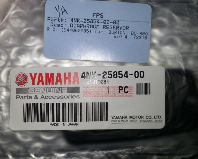

Du-Rron Posted February 22, 2015 Author #14 Posted February 22, 2015 Went to dealer on Saturday. I know these guys. They offered to replace every seal/hose from master cylinder to slave all at once, ...she-bang. We then had a chat about finding the possible one component that would most likely be causing the problem and if we changed all the variables at once we would never know what it was. Outcome was dealer ordered master cylinder diaphragm and will replace it and re-bleed clutch (just for the heck of it) when part comes in next week. If at any time in the future I don't like it, then next step is mastercylinder piston kit, then hose, then slave kit. Wash Rinse Repeat as necessary. Right now, since the clutch fluid is a week old, the clutch is working perfectly. New master cyl diaphragm & clutch fluid will be installed next week and then we will "play" with it for a while. The mechanic we had inspected clutch and since it was good, other than my report of previously nasty fluid and grabby clutch with said nasty fluid, he couldn't find anything wrong with it. No creep, full disengagement, no slip when feathered in fourth and then re-engaged at speed, slick shifts and no leaks.
Du-Rron Posted March 8, 2015 Author #15 Posted March 8, 2015 Under the wise direction of @V7Goose @Condor & @XV1100SE the dealer replaced the master cylinder diaphragm and the clutch was flushed/bled again on 3-6-15. Right now, the clutch is working perfectly and has absolutely clean, clear, new, fluid in it. Now we will see what happens after a few miles. A shout out of appreciation to Levi & Jon of Family Power Sports, San Angelo, TX.
Du-Rron Posted March 20, 2015 Author #17 Posted March 20, 2015 Interesting post from both. I too suffer from early browning of my clutch fluid and I end up changing it out frequently in the summer riding season. Mind you, I do a lot of clutch riding during training courses as I demonstrate with my RSV so that puts more wear and tear on the clutch system than the usual rider. I hadn't thought of trying the shieding until I had seen the OP's message and will give that a try to see if it makes a difference this coming riding season.. Though I flush out my clutch system twice a year (simple enough to do it), in between flushes I would typically change out the reservoir fluid with a turkey baster to suck out the old and pour in fresh from the bottle new Dot4 fluid. I have new seals in the master cylinder and under the reservoir cap. I live on the coast (moisture) and ride in the rain a lot, which may contribute to the browning of the fluid through water contamination.. if it's not the heat causing it. Lookie what I found from Yamaha.

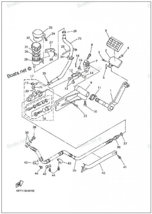

dingy Posted March 20, 2015 #18 Posted March 20, 2015 Just a thought on the heat convection to the brake line. The rear brake has a similar close encounter with right front exhaust, but Yamaha put a shield over it in that area. Maybe it was a cost decision not to do the front line on the RSV's. The front line is farther away, I believe, but still close. Item #40 in picture. Gary
Du-Rron Posted March 20, 2015 Author #19 Posted March 20, 2015 (edited) Just a thought on the heat convection to the brake line. The rear brake has a similar close encounter with right front exhaust, but Yamaha put a shield over it in that area. Maybe it was a cost decision not to do the front line on the RSV's. The front line is farther away, I believe, but still close. Item #40 in picture. Gary So far no problems with rear brake fluid. Since I initially wrote this article about a month ago, the clutch fluid has been bled/flushed about 3 times. One time by me, one time by the dealership when they replaced the diaphragm, and just last week again by me when I installed the @skydoc_17 Clutch Upgrade kit. So, this thing has been through about fifty gallons of brake fluid in the last month and I have worn out the screws on the Master Cylinder ( Anyways, I really never had a problem with the clutch operation when using new fluid, just after 5k on the old fluid when it got black and nasty. Thought I would put a heat shield on to try and stop a little radiant heat from getting to the fluid from the exhaust pipe and turning it dark so quick, as I can do nothing about the conductive heat of the slave cylinder. Thank you for the "heads up" on the rear brake fluid though. Edited March 20, 2015 by Du-Rron

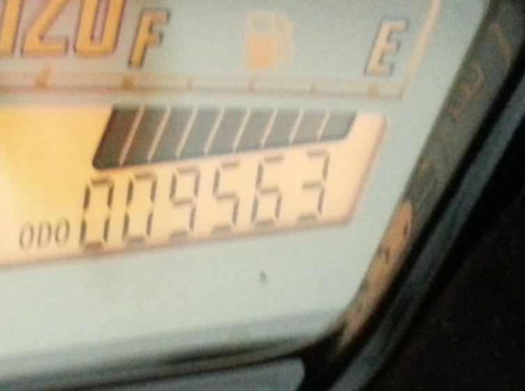

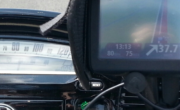

Du-Rron Posted September 1, 2015 Author #20 Posted September 1, 2015 So, I am not putting on the miles as fast as I though I would due to new job since April. Oh well. So the bike has 9500 miles on it now and it is getting very hard to find neutral. When I do ride around, I usually do it at a speedometer indicated 85mph or GPS indicated 80MPH in over 100 degree heat the past few weeks. The clutch fluid is nasty looking ... kinda like weak coffee. Today, I changed out the clutch fluid again. Now, all is right with the world.
