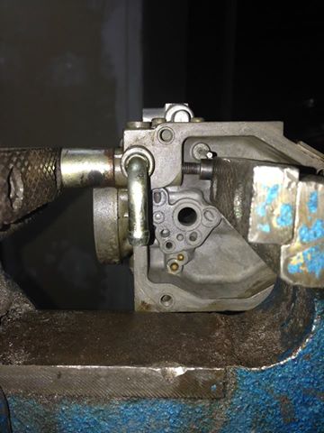

Get Off My Lawn Posted June 27, 2020 #26 Posted June 27, 2020 The caps may be 'staked' like this: https://www.venturerider.org/forum/attachment.php?attachmentid=97196 If so, try to remove or mitigate the protrusions that help to hold the cap in the carb body. Then using a punch, drive the float valve seat out. The valve seat should push the cap out as the seat is driven out. The net filter will be squashed, but the new float valve assembly should include a new one. Here's how to drive the valve seat out: https://www.venturerider.org/forum/attachment.php?attachmentid=97197https://www.venturerider.org/forum/attachment.php?attachmentid=97198 HOw hard do you have to hit the punch to get that float seat out? I've given it a few good taps taps, but it's not budging. On my way to my local shop to pick some brains.
Prairiehammer Posted June 27, 2020 #27 Posted June 27, 2020 HOw hard do you have to hit the punch to get that float seat out? I've given it a few good taps taps, but it's not budging. On my way to my local shop to pick some brains. The float valve seat and the "cap" are a friction fit with an O-ring on each. And of course the "stakes" securing the cap. So they (the float valve seat, the net filter and the cap WILL come out with sufficient force). The net filter and the float valve seat will be ruined when using a punch, but you are replacing the seat and filter anyway, right? Some have pressed the float seat and cap out (still squashing the filter) with a vise. You ARE trying to remove the float seat from the inside out, correct?
Get Off My Lawn Posted June 27, 2020 #28 Posted June 27, 2020 The float valve seat and the "cap" are a friction fit with an O-ring on each. And of course the "stakes" securing the cap. So they (the float valve seat, the net filter and the cap WILL come out with sufficient force). The net filter and the float valve seat will be ruined when using a punch, but you are replacing the seat and filter anyway, right? Some have pressed the float seat and cap out (still squashing the filter) with a vise. https://www.venturerider.org/forum/attachment.php?attachmentid=119155 I like that idea. You ARE trying to remove the float seat from the inside out, correct? Heh. Yeah, from the inside out. I was just at my local shop, and they asked the 'old' tech who started in the 80s (OLD?!?!?) He said he's never had to remove one of those, and recommended some 800grit to clean out the upper throat (NOT touching the bevel seat) I'll try that. Before I put them back on, I'll rig up a test. to see if the float needle actually seats. It's only one carb giving me grief, and I've ordered the cap and O-ring anyway. It's raining again so I'm not missing any riding anyway Thanks again.
