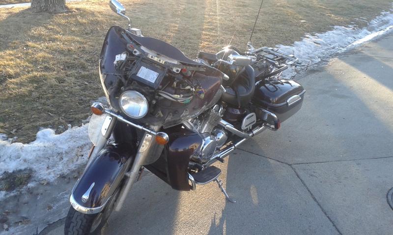

Well as you may remember I recently added a post about the first ride of the year. I was seeing mom and dad off to texas for 9 days as we were loading up their goldwing I decided to take a ride and it definitely didnt help extinguish my riding fever! So here it is thursday and as promised I went home to work on the bike. Not like I had a choice though, I need to take mom's cat out every other day. So i got home and got to work. I approached my old, stripped, but never self concious Royal Star Venture with what I could only describe as a gut feeling for glory (or last nights burritos)

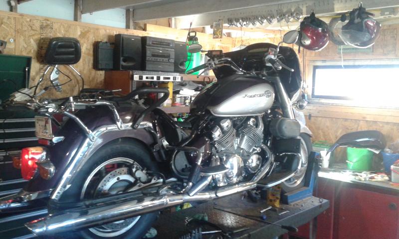

I walked to her left side and pulled the choke and within a second she fired right up. She still doesnt want to run on the front left cylinder with the choke on, but really that doesnt concern me too much. I let her warm up As i made some final adjustments. Put the right front cowell on. Fastened the gas tank and the front seat on. After she warmed up and was purring on all fours I shut her off and did the final try on the back tire. Put the washer back where its supposed to go and threw the side bags back on. Man I gotta tell yah that I really missed seeing her with her bags. Definitely just doesnt look complete without the bags! I lowered my dads bike lift (he's spoiled I know) thew the new antanna on and straightened her out in the garage. I excitedly ran to her left side eager to plop my but on that old familiar seat but when I did, something just didnt feel right.
I scratched my frazzled hair the frazzlyness of which can only be matched by my frazzled brain and wondered why it felt so weird. Clearly somebody was tampering with my bike, and then suddenly like a light bulb it came to me. Some fool raised the back end an inch higher off the ground and boy what a difference that inch can make. So once I came to terms of my new butt position. It was time to ride.

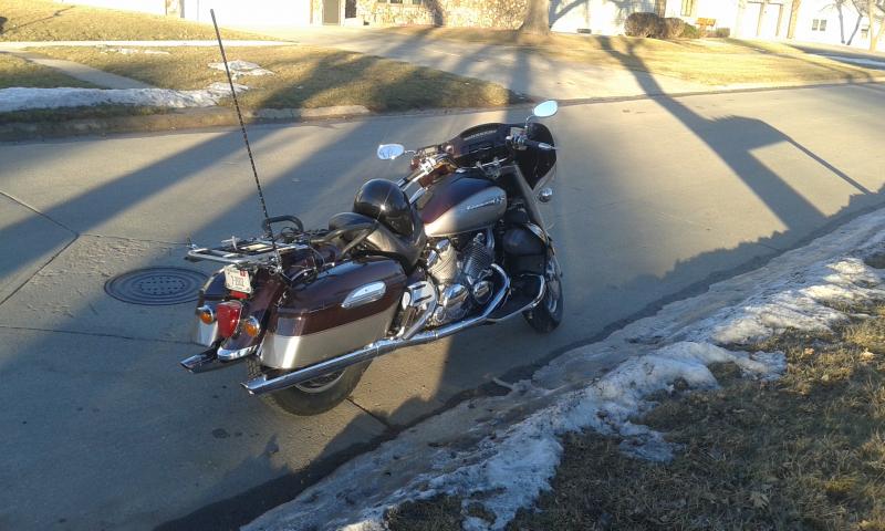

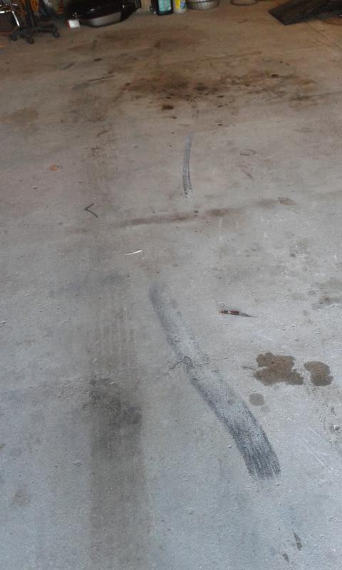

When i first got going I decided to kind of swirl around the road like i usually do and with the new leveling links along with the car tire. I had to learn to re-ride my bike. Kudos to whoever came up with this whole leveling link idea by the way. With the new tire, leveling links, and relubed suspension it almost rivals my 85 in handling now. I'd have to say the most different thing about it is sharp back and fourth cornering, but I also didnt get to play with my air pressures much. I'll probably wait until a 40 degree day to do that! As far as traction goes... Gobs and gobs of it, I even have proof!
010.jpg Notice that nice fat Tread mark on the back... Now notice the skinny one in front of that? Yeah even with the back tire broke loose the front still couldnt hold it still. Now thats traction! (probably also a good indicator that my bike is running stronly)
