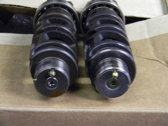

Venturous Randy Posted January 22, 2015 #4 Posted January 22, 2015 I pulled a 1st gen and a 2nd gen shift drum and checked and they look identical on that end. I suspect you have a CMU or wiring problem. Randy
