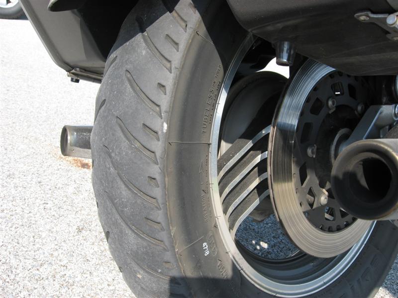

I have E3's on my '85 VR and I really like them. I railed a few hundred miles in Arkansas in 2013 and over-ran the rear tread while carrying a passenger.

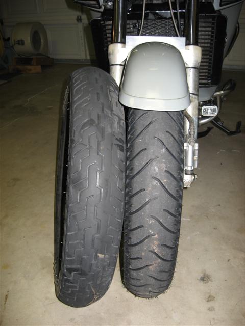

The tires hold up very, very well on this heavy bike. BTW: I do not like the E2 tires. They feel vague and the front wants to wobble at low speeds (I presently have a set of E2's on my '92). The second picture is the worn out E2 next to the mounted new E2 on my '85.

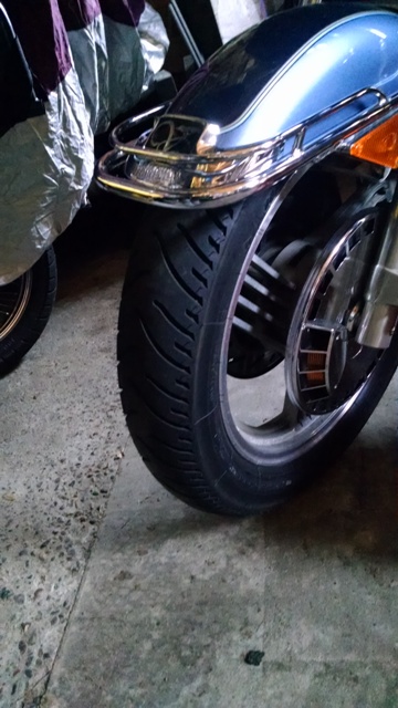

added pic of front tire
I see your tire. I am very familiar with the rear tire. I have one in my basement with a nail in it. If you were to see an Avon or Comander2. You would see how dunlop gets the mileage from rear. It's not special rubber compound. It's the less-rounded profile. Thus it spreads the load. I got good mileage from the older "Elite2". But hated the handling. And the front Elite2 caused head shake and had a less rounded profile compared to others. What I mean to clarify is,...as many know, once you ride a rounded profile tire, the bike feels 200# lighter. But the front E3 I am not familiar with. It would help if I see a picture of an E3 on the front of a 1st gen. thanks

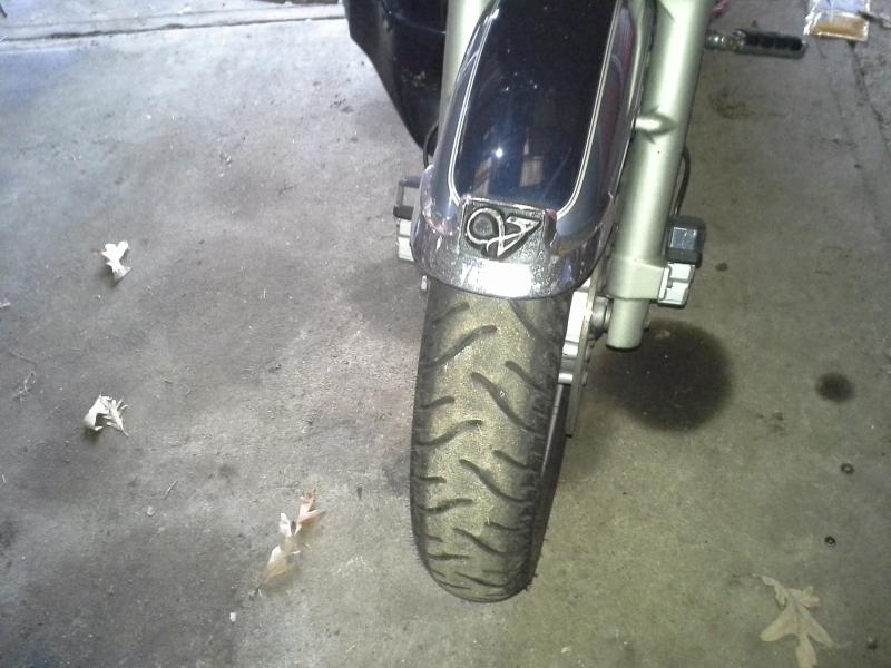

This is an E3 on the front of a first gen (6k on the pair). I actually liked the handling of the Shinko better, but not the life (less than 8k on rear and it was gone).
Posted (edited)
picture and info you have relayed has helped me significantly. My Commander2 has 3k. So a FRONT shinko lasting 10k or so would likely match the year the rear wears out.
