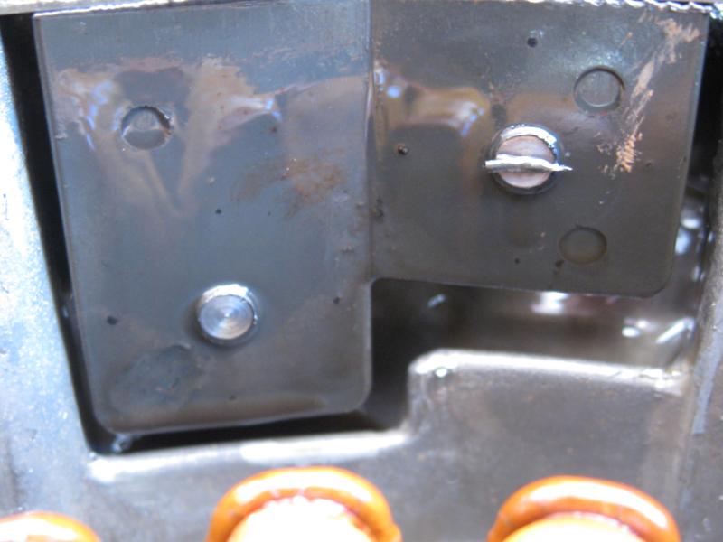

flyday58 Posted February 10, 2015 Author Posted February 10, 2015 Opened up the motor and found a piece of metal across the #2 pickup coil. Could this cause the ignition to fail intermittently?
Neil86 Posted February 10, 2015 Posted February 10, 2015 Definitely.....there needs to be a gap between pickup coil and spinning rotor.
bongobobny Posted February 10, 2015 Posted February 10, 2015 Yup, that metal is in essence magnetically shorting out the pickup coil...
flyday58 Posted February 11, 2015 Author Posted February 11, 2015 Man I hope this is it. Will put it back together tomorrow if I get the time and see what happens.
Flyinfool Posted February 11, 2015 Posted February 11, 2015 More important is WHERE did that piece of metal come from INSIDE of the motor. AND are there more pieces of metal wandering around inside of your motor.

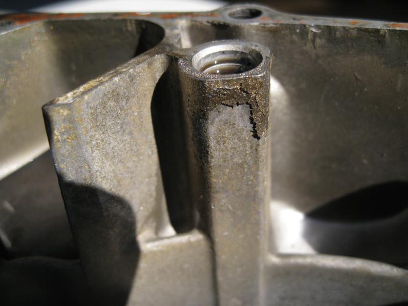

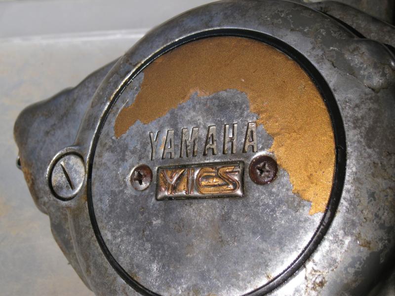

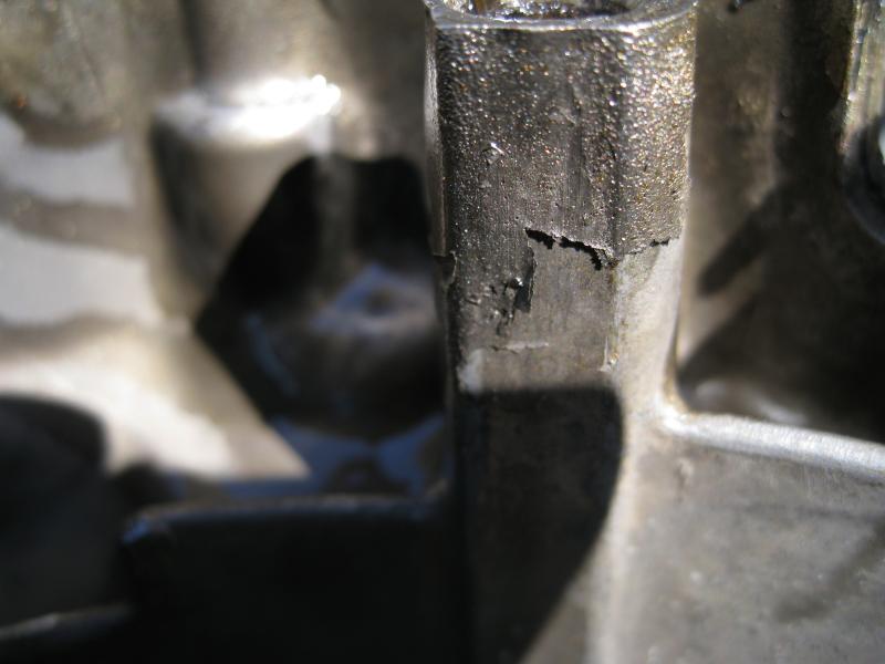

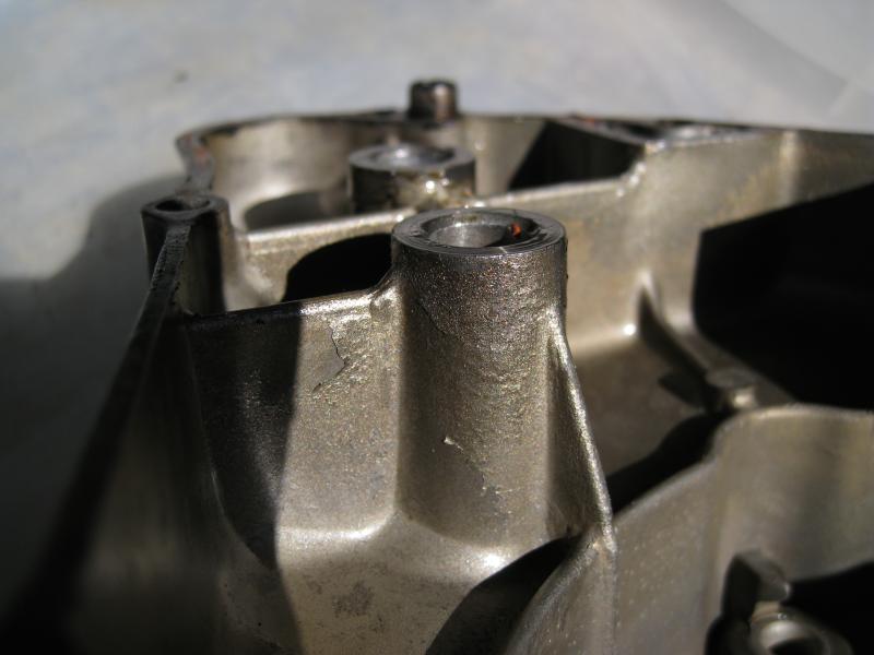

flyday58 Posted February 11, 2015 Author Posted February 11, 2015 (edited) Upon further inspection, found what looks like gold metal flake paint on the inside of the stator cover. It's flaking off and definitely magnetic. PO had painted the outside, plus some other parts. Guess he got a good bit of overspray on the inside of this. Who knows. Also found some phenolic chips from the stator floating around, very small pieces, so not worried about that. But this cover is definitely bodged, PO also overtorqued the stator screws, had to use my impact driver to get two most of the way out. So shopping for a cover now. Edited February 11, 2015 by flyday58 additional info
MiCarl Posted February 11, 2015 Posted February 11, 2015 Those stator screws have red loc-tite on them. You should use it when you put it together too.
flyday58 Posted February 11, 2015 Author Posted February 11, 2015 Two of the heads were boogered up, one really bad, and its threads were stripped, too. So they've been out before. I'll use red loc-tite when i reassemble, got a cover coming.
