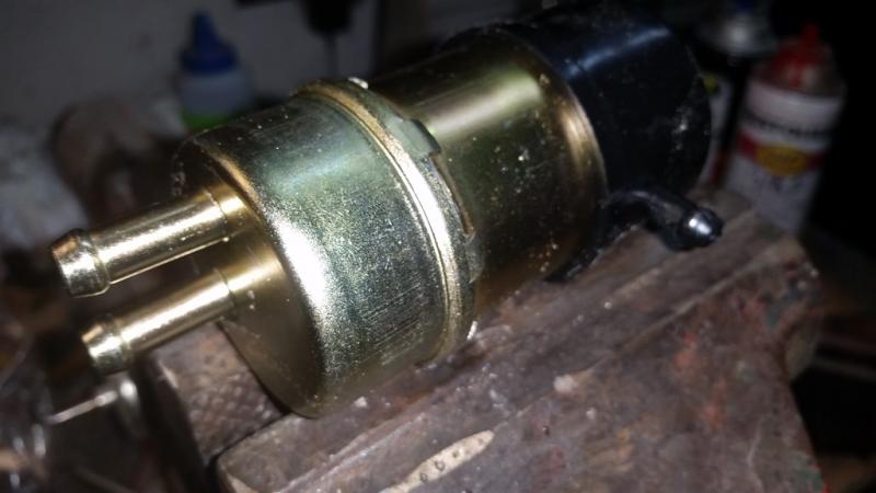

pbjman Posted December 12, 2014 #1 Posted December 12, 2014 (edited) This will be kind of a long one, so read the first paragraph then you will see if you want to skip the first section on fuel pump rebuilding. The other two sections are not very long. If you want to read about gravity feed (fuel pump bypass) go to my next post in this thread. If you want to read about the Cheap Ebay Fuel Pump, go to my third post in this thread. Last week my RSV was leaking lots of fuel while I had it running to warm up for a ride so I had to abandon my ride and figure out what needed fixing. It turned out to be the fuel pump; it was leaking lots of fuel from the seam where the two halves come together. Apparently this is not a common failure and I could not find a diagram of the fuel pump exploded into component parts. It is only listed as a complete assembly, although you can replace the points if needed. New pumps cost approx. $200 for OEM so I began researching what my alternatives would be: Repair, replacement, or bypass Since I could not find a diagram of what’s in the pump, I decided to see if I could have a look for myself. Hopefully I would see something that can be tightened, patched, or replaced! Nothing to lose right? I removed the pump from the bike and took off the metal mounting clamp that secures the pump onto the bike. I wiped the pump clean and concluded that what holds it together are the little tabs that are bent over the middle seam. In this pic I have already pried them open to separate the two halves. (Now I wonder if the first thing I should have tried was to just hammer all the tabs down tighter!) The next pic shows the two halves apart, and a large washer and very thin gasket that were inside. The half on the left has a rubber diaphragm that is ‘pinned’ to the unit at its center, so the metal washer and gasket had to be pulled up from under the diaphragm by flexing the diaphragm through the hole in the washer. I hope I explained that well enough, because I don’t have a good picture of that. Anyway, the washer and gasket went where the red arrow points, with the flimsy little gasket going between the metal washer and the metal pump body. After looking things over, I decided it seemed that the most likely cause of the leak was the little gasket. Did I mention it was really thin, floppy, and flimsy? I tried to put it back together but couldn’t get the washer and gasket over the diaphragm again without distorting or wrinkling the gasket. It looked like it needed to be seated perfectly and in such a tight space, I wasn’t sure I had done it. (To shorten this part of the story up….it didn’t work. Gas still came out of the seam so I took it apart again, still pretty sure the gasket was the problem.) Next, I went to the local Napa and asked if they had thin, gas-proof gasket material, and showed the guy my pump. He went in back (they are an auto repair shop also) and came up with a partial sheet of 1/32 gasket material that he said should work, and gave it to me for free. I traced the washer on the gasket sheet and then cut it out with a razor. I reassembled the pump and hammered the tabs back down. I gently blew into the ‘inlet’ stem and it made kind of a honking noise, which I took as a good sign because no air was coming out of the seams as far as I could tell. I installed it and turned on the key. It made the usual clicks for a moment, then stopped once pressurized, and did not appear to be leaking. I started it and let it run for a few minutes and then turned it off. I felt around the pump and my fingers did not get gas on them. I let it sit for a while longer then felt it again and there was a very small drop on my finger from the underside of the pump. I pulled it out again and looked it over. I wiped it off and blew in it but still no obvious air leak and a good ‘honk’. Then looked at all the metal tabs and realized some of them could be tapped down a little tighter and more evenly. Doing this did seem to tighten things up and may have been good enough, but I decided to do one more thing. I have some metal HVAC tape so I wrapped the pump body with it twice around. I put the mounting clamp around the middle of the pump, which helps tighten the tape like a hose clamp would and put a hose clamp on the other side. See pic I went for a 30 mile test ride, stopping frequently to feel for gas on the pump, and so far it is working. I’ll leave that side cover off next time I ride so I can keep checking until I am satisfied it will hold. Edited December 12, 2014 by pbjman font

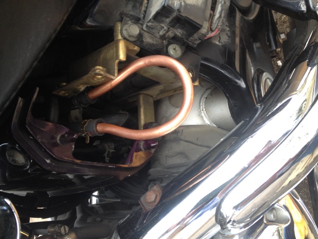

pbjman Posted December 12, 2014 Author #2 Posted December 12, 2014 (edited) While researching fuel pumps I came across a few threads mentioning ‘gravity feed’ or ‘pump bypass’. This is a method of temporarily running your bike without a fuel pump. It has gotten some riders off of the roadside when their pump failed. How it works, is simply the weight of the gas in the tank alone will push gas into the carbs, though not as effectively as with a fuel pump, and it will only work down to a certain level in the gas tank. When the tank is half full or ¼ full, there may not be enough to push gas throught the system well enough to run the motorcycle. Since I was already working on the fuel pump, I decided to experiment with bypassing the pump. I went to the local plumbing supply place for a pc of 5/16 flexible copper tubing and was just going to buy 1ft but the guy was interested in what I was doing and bent it for me! I had the pump with me so he made the total length to be not longer than the fuel pump and was able to get the two ends in closer to each other than with a simple U shape would allow. If you bend it yourself, you will need the little tubing bender tool or need to bend it around a curved object so it doesn’t kink. So I simply inserted the ends into the fuel lines on the bike where the fuel pump would go, set the petcock to reserve, and fired it up. After warming for a few minutes I went for a test ride. I only went about 6 miles. I was at ¾ tank and I would say you could ride like that if you had to, but you might not want to. There was a lack of throttle response and a little popping, but it did almost seem normal at a steady, easy, pace. It reminded me of that last 30 seconds before you realize you need to switch to reserve. So if your fuel pump dies and you aren’t low on gas, this seems like it should get you home. (Note: there is another way to bypass, where you go directly from the petcock to the carbs with a piece of hose, but I have not tried that. If you go that route give consideration to adding a small inline filter to your bypass hose, because you will be bypassing the main fuel filter with this method.) Edited December 12, 2014 by pbjman

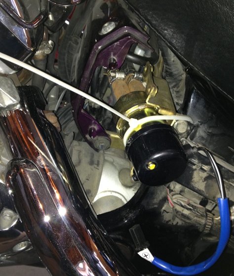

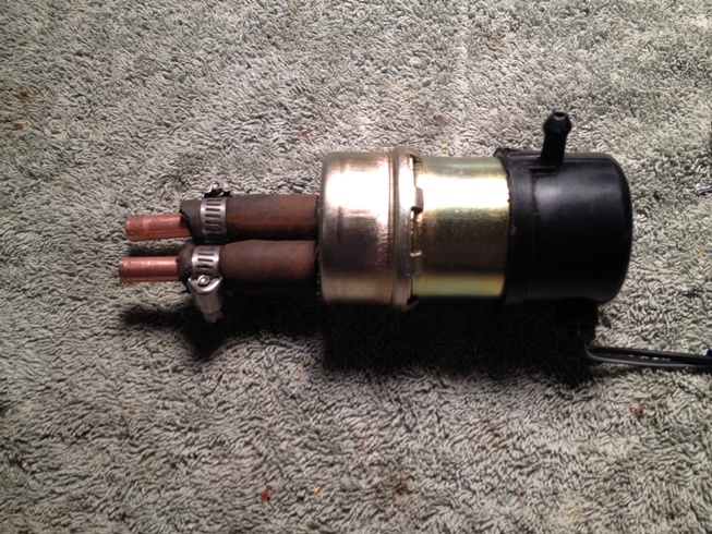

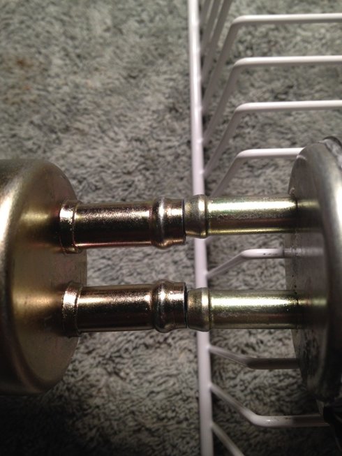

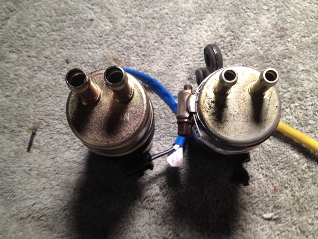

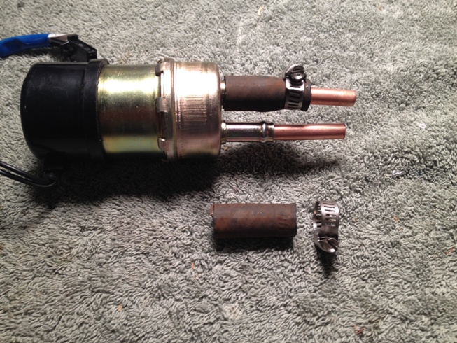

pbjman Posted December 12, 2014 Author #3 Posted December 12, 2014 (edited) Now we come to the Ebay fuel pump that can be had for $24.98. It is sold as a direct OEM replacement with 10mm inlet/outlet pipe diameter, current draw of 0.8-1.0 amp. And 1 year warranty. It looks like the OEM pump but with a blue wire. Here’s the link to the one I purchased: http://www.ebay.com/itm/291268226096?_trksid=p2059210.m2749.l2649&ssPageName=STRK%3AMEBIDX%3AIT#ht_3516wt_1041 I see that the price has since changed to $29.99. Although it is billed as a direct OEM replacement, there is something I missed, and it was there all along. You may have missed it too… That’s the new one on the left, with the FAT tubes. So the stock tubes are about 8mm and the tubes on this one, as stated, are 10mm. OOPS. I wanted to keep this to be a cheap spare, so I came up with this: I found that the 5/16 copper tubing (had a small cutoff peice that was left over from the bypass tube experiment) fits into the ends of the fat tubes on this pump, so I cut two short pieces of 3/8” fuel line and put them onto the fat tubes. They fit very snugly no clamp needed! I then inserted two short pieces of 5/16 copper through the rubber and into the tips of the tubes, and hose clamped them into the rubber hose. I don't know what that little stem is for....so I did not do anything with it! From there, the copper tubes go easily into the hoses on the bike. This makes it a little longer, so make sure you are not creating a kink in the fuel lines of your motorcycle as you push this into place. I didn’t bother to bolt it on, as this was just a quickie test ride so I zip tied it into place, plugged it in, and went for a ride. If I was going to ride for any length of time, I would use screw-type hose clamps where the copper tubes insert into the hoses on the bike, since the copper tubes don't have a barbed end and you don't want them popping off and spraying gas everywhere.. The test ride for the Ebay fuel pump was right after the test ride with the bypass tube, and it felt sooooo much better. It ran perfectly and I will be packing this in as a spare for any long road trips or group rides. my bike: Edited December 12, 2014 by pbjman

Mike G in SC Posted December 12, 2014 #8 Posted December 12, 2014 Lot's of work, good write up. Yeah, I did the gravity feed from the petcock to the carb inlet when one died on my RSTD few years ago (and wrote it up). What's nice there is you can simply use the original line that goes to the filter. Just need to pull the seat and lift the seat end of the tank some to get to it all. (Oh, and disconnect the electric to the pump incase it tries to puke out remaining gas.) I did add the $3 filter inline when I found the part was going to take several days. I ran several hundred miles with that setup. When I told the shop, they suggested I simply have a line to run from the filter outlet to the carb. Results are same. Thanks again, Mike G.

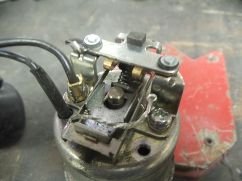

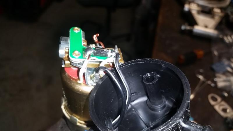

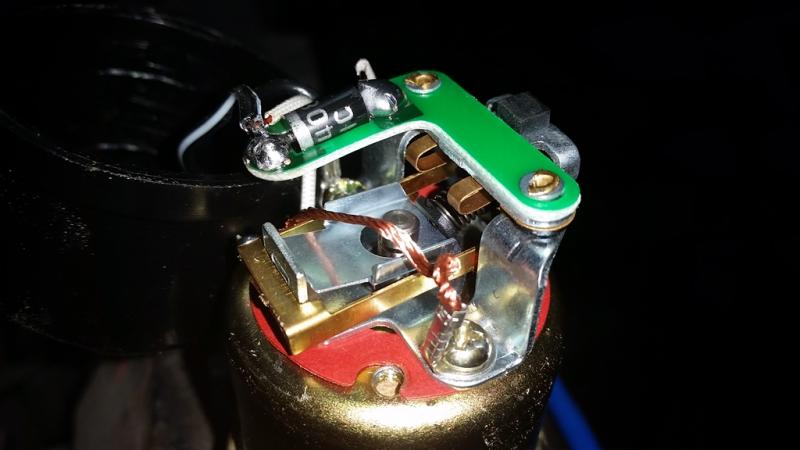

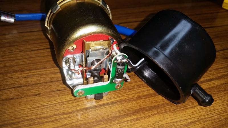

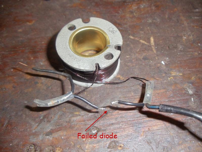

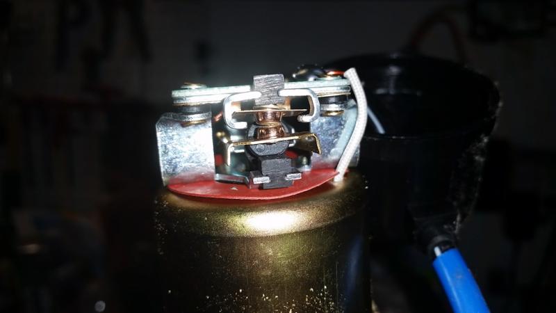

dingy Posted December 19, 2014 #10 Posted December 19, 2014 (edited) I ordered one of the RSV replacement fuel pumps and it came with the needed 8mm fuel ports on it. Cost was $24.77 with shipping included. Shipping was fast. Some pictures attached of the electrical end of the pump. It is almost the exact same layout as a stock RSV pump with one very good exception. The diode on the stock pump is much smaller and is located near the coil, the replacement unit has a much larger diode and it is in the electrical end where it is easier to replace if needed. The ebay sellers ID is ultimatecomponents. Hover cursor over links and click., they don't seem to highlight since site upgrade on my computer. Listing for current auction is New Fuel Pump for 1996 2009 Yamaha XVZ13 XVZ1300 Royal Star 4NK 13907 00 00 | eBay Couple of pictures of stock RSV pump I dissected also attached, one has failed diode pointed out. Gary Edited December 22, 2014 by dingy

pbjman Posted December 20, 2014 Author #12 Posted December 20, 2014 Gary, good find on the pump with the 8mm inlets! I wish I had known the difference before I ordered mine. Have you tried it yet? Does it stop the fuel from running through when it is not running?
dingy Posted December 20, 2014 #13 Posted December 20, 2014 Gary, good find on the pump with the 8mm inlets! I wish I had known the difference before I ordered mine. Have you tried it yet? Does it stop the fuel from running through when it is not running? It won't let me blow back through it, so I would say yes it has a check valve. Gary
BlueSky Posted December 20, 2014 #14 Posted December 20, 2014 I just bought a 1987 Venture. Can someone tell/show me where the fuel "shut-off" valve at the tank pls? Or, where can I find a good manual online? thx It's on the right side kind of low on the bike. You can't get to it when riding.
pbjman Posted December 20, 2014 Author #15 Posted December 20, 2014 It won't let me blow back through it, so I would say yes it has a check valve. Gary What about the inlet; mine won't let the fuel (or blowing) go back, but it will let fuel run through the inlet.
