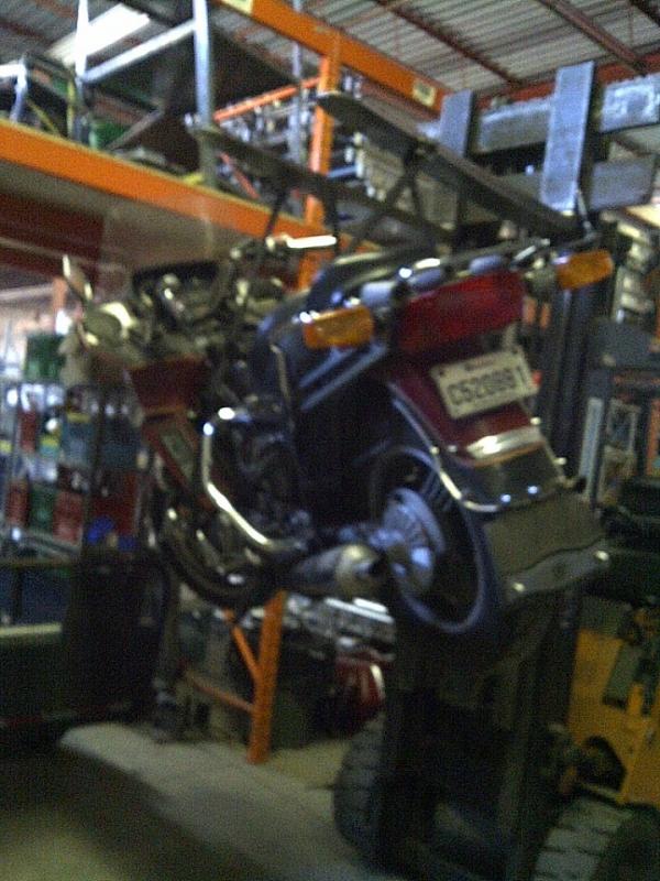

paysaw Posted December 13, 2014 Posted December 13, 2014 You need one of these. Sometimes. I do it this way.
BlueSky Posted December 13, 2014 Author Posted December 13, 2014 Can I buy one of those at HF? Hee! Hee!

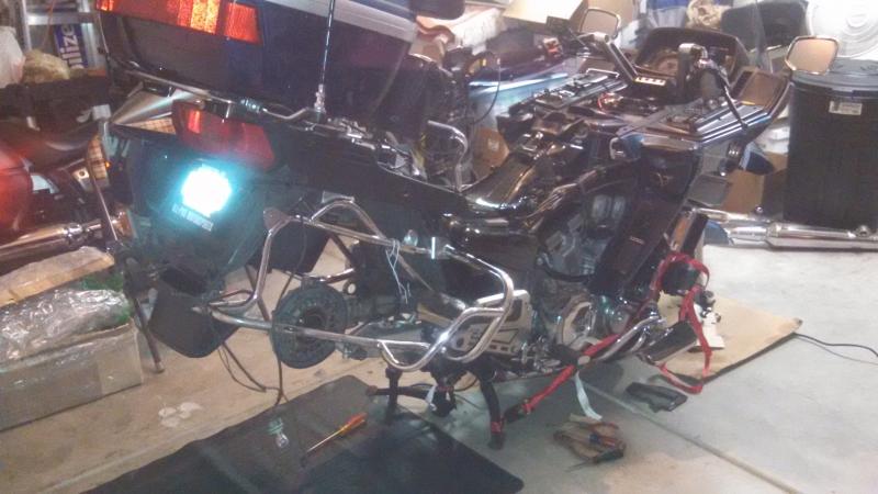

Peder_y2k Posted December 14, 2014 Posted December 14, 2014 I've never had to jack up the whole bike at one time. I use the center stand and brace it with a cinch strap so it can't kick back, then take off the front wheel and jack up the back end making the bike kneel on the fork ends, this gets the back end up enough for my service access needs. For raising the front, I empty the rear shock air and even let air out of the tire, then put a jack under the engine case to raise the front wheel and forks off the floor. For added bracing, side straps can improve stability. I haven't needed to do this much over the 20+ years of wrenching on my Ventures. -Pete, in Tacoma WA USA

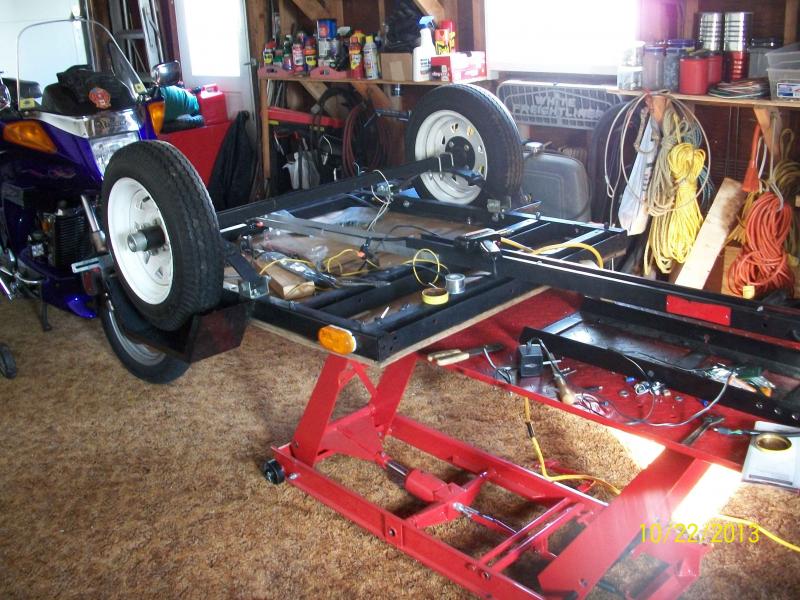

Jayceesfolly Posted December 14, 2014 Posted December 14, 2014 Buy the HF platform lift. Here is a photo of mine being used as a work platform to rewire a HF trailer. Rises to 30" off the floor, so it is at a good height to use as a workbench. Best $300 I ever spent. As was mentioned before, there is a plate that removes from the floor to allow the rear wheel to be removed from the bike. Jim
Flyinfool Posted December 14, 2014 Posted December 14, 2014 Buy the HF platform lift. Here is a photo of mine being used as a work platform to rewire a HF trailer. Rises to 30" off the floor, so it is at a good height to use as a workbench. Best $300 I ever spent. As was mentioned before, there is a plate that removes from the floor to allow the rear wheel to be removed from the bike. [ATTACH=CONFIG]95824[/ATTACH] Jim Your garage is carpeted? That looks like better carpet than I have in my living room.
Peder_y2k Posted December 14, 2014 Posted December 14, 2014 Maybe that is the living room! -Pete, in Tacoma WA USA
videoarizona Posted December 15, 2014 Posted December 15, 2014 I've never had to jack up the whole bike at one time. I use the center stand and brace it with a cinch strap so it can't kick back, then take off the front wheel and jack up the back end making the bike kneel on the fork ends, this gets the back end up enough for my service access needs. For raising the front, I empty the rear shock air and even let air out of the tire, then put a jack under the engine case to raise the front wheel and forks off the floor. For added bracing, side straps can improve stability. I haven't needed to do this much over the 20+ years of wrenching on my Ventures. -Pete, in Tacoma WA USA That's how I'm working on my rear end. Got the idea right here and it works!!
bongobobny Posted December 15, 2014 Posted December 15, 2014 Your garage is carpeted? That looks like better carpet than I have in my living room.Yes he has carpeting down where he works on the bike, and I do too! Makes it a lot better on the old body to lay on instead of a cold concrete floor especially in the winter...
