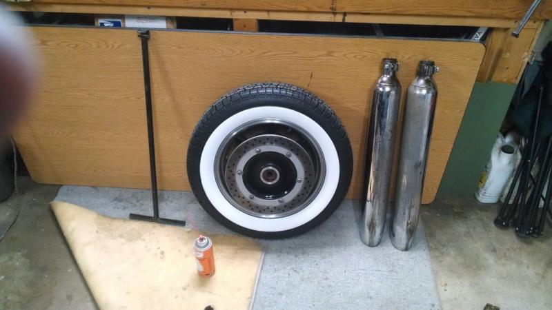

eagleeye Posted December 11, 2014 Share #1 Posted December 11, 2014 My mechanic tried everything. slime, silicone, aired up many times. He took it off of the rim and I polished it and tried again. Now it is sitting near the wood stove with approx 60+ lbs of air in it for the night. One side just won't go no matter what. Maybe the heat will do it. If that doesn't work, I'm going to take it to the tire store and see if they will use their blaster on it. If that doesn't work I'm taking my heat gun to the shop and we'll try that. I'm listening__________ Link to comment Share on other sites More sharing options...
djh3 Posted December 11, 2014 Share #2 Posted December 11, 2014 So do I understand rite. One side will sit down in bead and the other wont go over the hump? I have had car tires the bead lip has a bit more rubber on the in side and it just wont go. Sometimes once the ru-glide or whatever dries it actually gets sticky. I have used baby powder inside tube type tires to keep the tubes from getting pinched. Link to comment Share on other sites More sharing options...
eagleeye Posted December 11, 2014 Author Share #3 Posted December 11, 2014 Yup, one side just wont' go over the hump. But as you know, no tube type tires here. YET Link to comment Share on other sites More sharing options...
Pegasus1300 Posted December 11, 2014 Share #4 Posted December 11, 2014 I think he was suggesting that as a possible help. Link to comment Share on other sites More sharing options...
eagleeye Posted December 11, 2014 Author Share #5 Posted December 11, 2014 Thanks for the tip on baby powder. I've used it on tires with tubes for that reason myself, and I agree it works great. I took it to a tire shop and he used a different lube and it went right on. I'm going to use beads inside this tire for balancing. Link to comment Share on other sites More sharing options...
djh3 Posted December 11, 2014 Share #6 Posted December 11, 2014 Yup the beads work good for me. I have used them on the last 4 sets on the bike. Have them in the rears on the 3/4 ton PU now also. sometimes those inside beads are so sharp (squared off) they wont slip over at all. they should have like a rounded edge leading to the inside of the tire, but sometimes its dang near square. and that dont glide over nuttin. Link to comment Share on other sites More sharing options...
eagleeye Posted December 11, 2014 Author Share #7 Posted December 11, 2014 (edited) It's cleaned up and mounted, and the bike back together. Just got home from getting the new front Shinko mounted. 130-90-16. I don't have that one cleaned up and on the bike yet. I stopped to get some beads but the shop didn't have them so sometime before spring I'll put them in. The front tire I had balanced and won't put the beads in it. I did take the opportunity to clean up the bottom and back of the mufflers which never happens otherwise. Edited December 12, 2014 by eagleeye Link to comment Share on other sites More sharing options...
