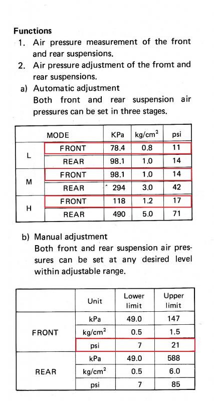

Pegasus1300 Posted December 7, 2014 #5 Posted December 7, 2014 Number 1 is that the front forks are only supposed to go about 7 or 8 lbs. Going to 17 will blow the seals so I suggest you start there.
Condor Posted December 7, 2014 #6 Posted December 7, 2014 Number 1 is that the front forks are only supposed to go about 7 or 8 lbs. Going to 17 will blow the seals so I suggest you start there. The first gens go to 17psi.... Common mistake....

Prairiehammer Posted December 7, 2014 #8 Posted December 7, 2014 (edited) Number 1 is that the front forks are only supposed to go about 7 or 8 lbs. Going to 17 will blow the seals so I suggest you start there. Paul, you might be thinking of the fork pressure maximum for the Second Gen. On the First Gen, Yamaha says the maximum is 21 psi on the front forks. The auto setting on High will go to 17 psi, but you can put up to 21 psi into the front forks when using the Manual setting. Edited December 7, 2014 by Prairiehammer
