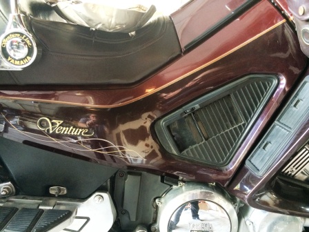

Prairiehammer Posted December 4, 2014 Posted December 4, 2014 The individual vanes on the 1985-1993 side cover adjustable vents are prone to distortion, breaking and loss. I know, I know, many have eliminated the adjustable vent altogether, but I find the ability to open and close the vents advantageous from a comfort viewpoint. Closed in hot weather and open in cool weather; the vent used like that is so effective, that Debbie requests that I 'turn on the heater' (open the side cover vents) when she is chilled or 'turn on the air conditioner' (close the side cover vents, open the knee vents in the lowers and most effectively, rotate the Baker Air Wings to scoop air into the rider envelope). However, many or most of the Venture's suffer from heat related distortion and ultimately breakage and loss of the individual vanes on the right side cover vent. Yamaha supposedly modified the plastic used in the side cover vents back around 1986-1987, with the intention to improve the durability of the vanes, but it seems it was a futile exercise (if it happened at all) for even late model Ventures suffer from the plastic degradation. The cause of the distortion and breakage on the right side and not on the left side (though, I have seen some with broken louver vanes on the left as well) is that heat rises and heats the right vent more than the left vent when the bike is shut down and placed on the side stand. That's Yamaha's theory. Whatever the reason for the vane degradation, I find the adjustable vent useful enough to replace the missing vanes, if possible. Of course, the individual vanes are not available. When the side cover adjustable vent assemblies (Yamaha description: "grill, side cover") were available they retailed for $190-$200 EACH. That price apparently justifies sellers of used (but always broken) vent assemblies to ask high and unreasonable prices for their vents/grills. Thus, my opening question. It would seem to me, that the original vanes could be replicated in ABS (as are the OEM vanes) fairly easily and inexpensively. The fly in the ointment, from my perspective, would be developing the 'X,Y,Z' information for the 3D printer, ergo the 3D scanner requirement. Are there any small batch manufacturers known to any of you's guys with those capabilities?

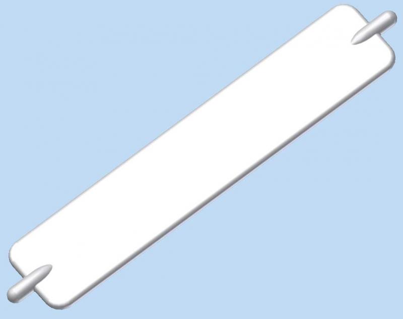

Flyinfool Posted December 4, 2014 Posted December 4, 2014 I may be a touch old school, but I think that a caliper and my 3D cad software could recreat those vanes just as well as a 3D scanner, and in not all that much more time. Unfortunately I do not have access to a 3D printer "yet"..... But the vanes are a simple enough part that someplace like protomold could make an injection mold for them fairly cheap and then crank out however many you want in whatever plastic you want. I'm thinking a glass filled black nylon that does not start to soften till around 350°F. ABS starts to soften at around 220°F. This 3D pic is what I threw together in a couple of minutes just from memory and guessing at sizes, It would be no big deal to bring it into size. The mold would be around $1500 so there would have to be enough interest in replacement vanes to justify it. I can output this part into the appropriate format for a 3D printer if we can find one.

Prairiehammer Posted December 4, 2014 Author Posted December 4, 2014 I may be a touch old school, but I think that a caliper and my 3D cad software could recreat those vanes just as well as a 3D scanner, and in not all that much more time. Unfortunately I do not have access to a 3D printer "yet"..... But the vanes are a simple enough part that someplace like protomold could make an injection mold for them fairly cheap and then crank out however many you want in whatever plastic you want. I'm thinking a glass filled black nylon that does not start to soften till around 350°F. ABS starts to soften at around 220°F. This 3D pic is what I threw together in a couple of minutes just from memory and guessing at sizes, It would be no big deal to bring it into size. The mold would be around $1500 so there would have to be enough interest in replacement vanes to justify it. I can output this part into the appropriate format for a 3D printer if we can find one. Your memory is *fairly* good, Jeff, but the critical part that is missing in your vane is the 'bell crank' arm with pivot point that is actuated by the 'traveler'. In fact, that arm is the kicker for preventing me from making some vanes from some brass sheet and wire soldered onto the center line axis. As for the $1500 mold, well, I believe a 3D printer would be more cost effective for 'on demand' or short runs.

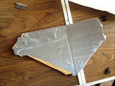

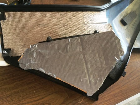

KIC Posted December 4, 2014 Posted December 4, 2014 Great idea. In fact I also lost half of my right side when I first bought the bike and took it to a car wash. without thinking, I hit the side with the spray and whammo, they were gone. I replaced them with a piece of ABS. In the summer, out here, we really need to block as much heat from the side as possible, so I tried to fabricate some type of removable piece that fit on the outside. Got some old heat shield from a friend and tried to bend it, and cut it, into a shape matching the inside vent area. That did not work well since I do not have the correct tools needed. But, I did take the cardboard pattern that I was using and covered it with the aluminum tape used for A/C and heater units and covered it with that. Then I screwed them in. It would be cool to make some ABS side covers to block the inside during the summer. Here are some pictures of my little attempt.
tucson_sailors Posted December 4, 2014 Posted December 4, 2014 Bill - lets talk about this on Sunday. Should be able to take the 5 screw mounting points on the inside of the plastic side cover and cut a piece of kydex plastic to fit. Its a thermoplastic so its moldable at oven temps, so would have to check the rating vs abs but could always put some of the silver insulation epoxied to it on the behind side similar to how you did the cardboard. Kydex comes with a smooth and pebble finished side, or could try and match paint job, etc. I had been thinking about getting some sort of perforated sheet metal to replace the panels and the triangular ones up by the radiator - no reason to limit to only one material while playing around with the idea. $.02 Glenn Great idea. In fact I also lost half of my right side when I first bought the bike and took it to a car wash. without thinking, I hit the side with the spray and whammo, they were gone. I replaced them with a piece of ABS. In the summer, out here, we really need to block as much heat from the side as possible, so I tried to fabricate some type of removable piece that fit on the outside. Got some old heat shield from a friend and tried to bend it, and cut it, into a shape matching the inside vent area. That did not work well since I do not have the correct tools needed. But, I did take the cardboard pattern that I was using and covered it with the aluminum tape used for A/C and heater units and covered it with that. Then I screwed them in. It would be cool to make some ABS side covers to block the inside during the summer. Here are some pictures of my little attempt. [ATTACH=CONFIG]95648[/ATTACH][ATTACH=CONFIG]95646[/ATTACH][ATTACH=CONFIG]95647[/ATTACH][ATTACH=CONFIG]95645[/ATTACH][ATTACH=CONFIG]95644[/ATTACH]

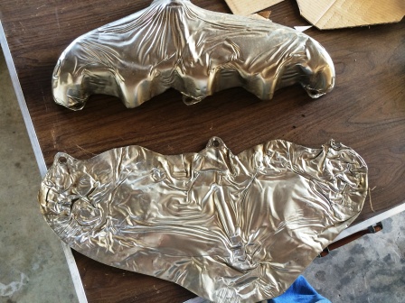

skydoc_17 Posted December 5, 2014 Posted December 5, 2014 (edited) Hey Kevin, I too have puzzled over this for a number of years, seeing as I own two First Gens. I realize that the pics below don't solve the issue of heat in the cooler months, it does solve the issue of too much heat in the summer! Please have a look at the pics below, and if there was some interest, I would consider making another run on these parts. Thanks Dingy and Flyin'Fool for bringing the professional perspective to this project in regards to fabbing a replacement for the OEM parts. One of the things I miss the most about Yamaha is the fact that when they designed the MKII Venture, they were SO DARING! Now, they just seem to be "middle of the road". And in the case of a new Second Gen. NO ROAD AT ALL! That's how I see it anyway. Earl Edited December 5, 2014 by skydoc_17 CRAYON BROKE!
