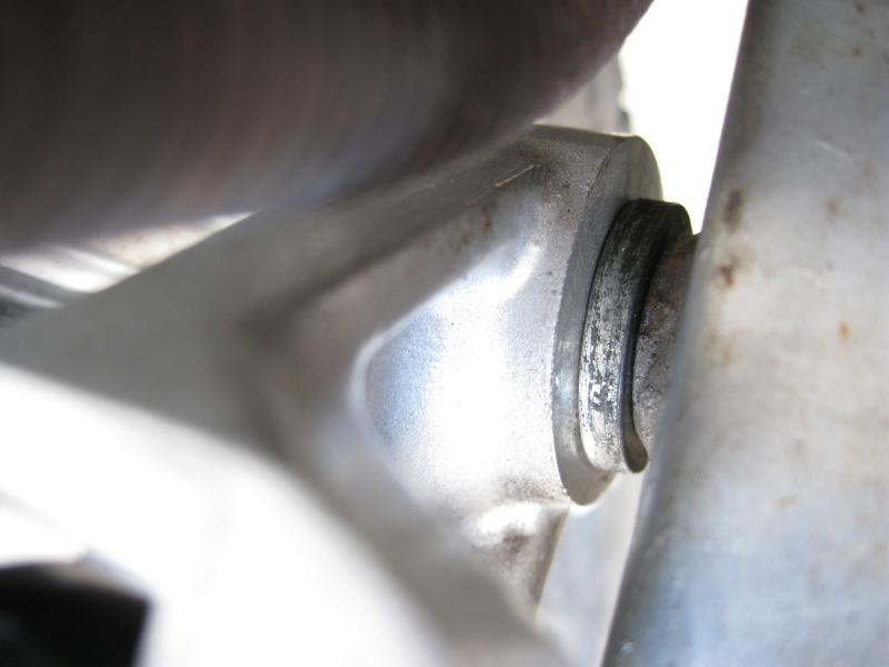

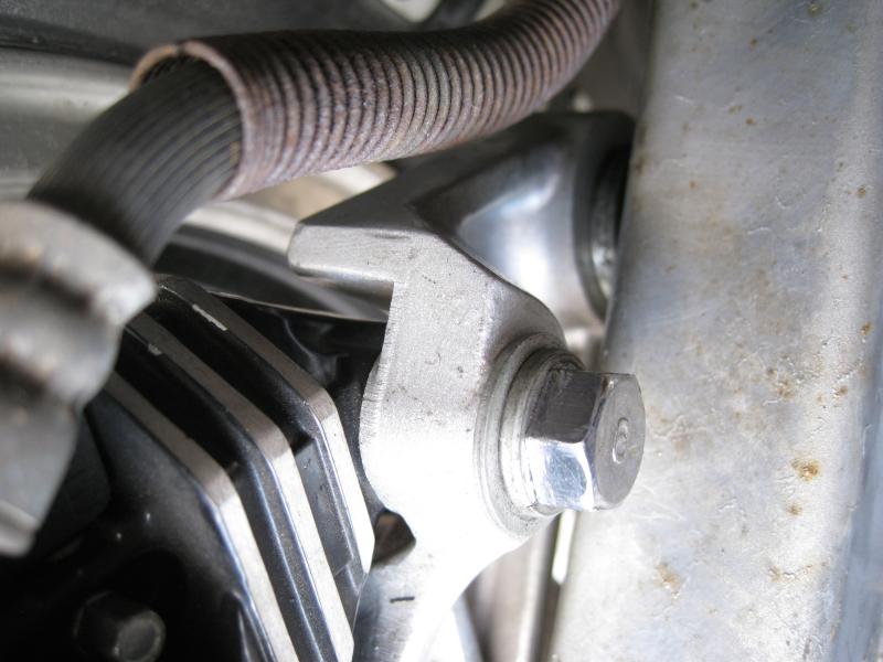

flyday58 Posted January 8, 2015 Posted January 8, 2015 Ah, also pertinent to me. On the caliper bracket, the parts diagrams don't show any washers/spacers where the bracket slides onto the pivot mount on the swingarm. I've had one washer on the pivot but yesterday found another laying on the ground under the swingarm. Only takes one, right? Two or none seemed to cause misalignment. No clue where the extra washer came from.

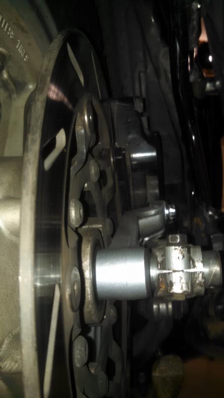

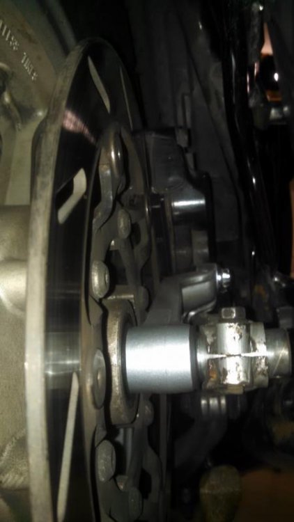

flyday58 Posted January 8, 2015 Posted January 8, 2015 Oh, and my swingarm may be fubar. Noticed in your (Kevin) pic the pinch bolt doesn't close the gap completely at the axle. Mine does. Sorry for sorta hijacking...
videoarizona Posted January 8, 2015 Author Posted January 8, 2015 Thanks for the picture Kev......Mine looks the same. Dick...my pinch bolt is almost closed....so maybe yours is fine.
flyday58 Posted January 8, 2015 Posted January 8, 2015 Back here on the pivot mount for the bracket on the right side of the swingarm. How many washers or spacers?
Venturous Randy Posted January 8, 2015 Posted January 8, 2015 My 83 does not have any washers on the post sticking out of the swing arm. I would think that might put the bracket in a bind. RandyA
flyday58 Posted January 9, 2015 Posted January 9, 2015 My 83 does not have any washers on the post sticking out of the swing arm. I would think that might put the bracket in a bind. RandyA Thanks Randy. Makes sense as, with the washer, the bracket doesn't go all the way onto the post. Probably added by the PO. Come to think, the rear did seem to be overly warm after riding. I just ass-you-me'd if was from the heat of the engine and tranny. I'll remove and check it. Richard
