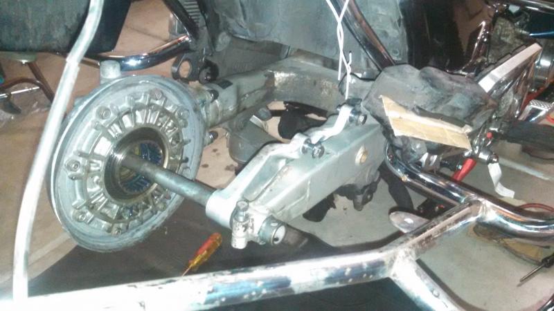

Update:
Yesterday and today. Got the boot off protecting the ujoint and found the intermediate shaft good and tight. Nothing broken there. Whew.
So rather than try and take the swing arm off (not fun for me since I don't have a socket large enough for the top bolts!)...I decided to take apart the used swingarm/rear end/driveshaft that I bought. The rear end (differential) looked fine. I cleaned and greased it up, then a buddy came over and we finessed the shaft into the ujoint. I snugged up the 4 bolts with the axle in for alignment. Going to leave everything as is until the new fuel filter comes in.
Also put new pads on the rear brake as they were getting low. Opened the observation hole on the MC so I could bleed out the excess fluid as I pushed the pistons in. After installing the new pads, I used the old trick of taking corners of a clean rag and twisting it so it would fit down the MC fill hole to soak up more fluid. Wanted to get the fluid level down to where it should be. Amazing how much fluid comes out with a little capillary action! So that's done.
There isn't any play on swing arm and eveything looks good there. Would have been nice to grease the top bushings but I'm not going to go and look for another large socket.

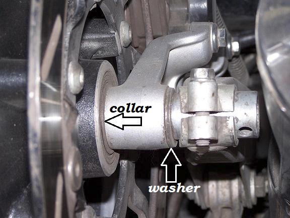

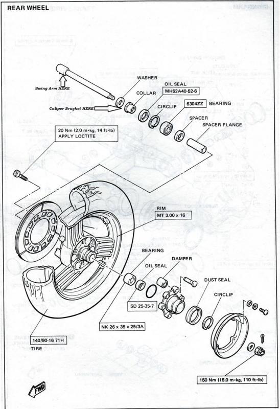

Both tire pressures at Max...42 pounds. Suspension back to "Low" on auto. Slight sashay at 70mph on up. BUT...only with turbulance! Took a back road and cranked it up with no traffic around...stable. Fairings are tight, fenders tight, saddlebags tight.....Only thing I've found is right muffler wiggles a little. The nut at the joint isn't tight enough I guess....so when she cools down, I'll make sure I have the clamp in the right spot and tighten down again. Axles torque'd, etc.. Do have the rear brake rotor getting hot...so there is drag there and the front left is warm. So I'll bleed more fluid out and check again. I put the rear axle washer between the caliper spacer and the frame...right? Not between the caliper spacer and the axle...? Can't find that in manual.....
make sure that you got the washer on right of the rear wheel back where it belongs. That will cause a hot rear rotor and a rear wheel misalignment The washer goes between the bracket and the swing arm.
Whew...that's where it is. Thanks for confirmation. Not shown is where the bracket is in relation to the washer and swing arm.
Posted (edited)
Proper assembly pic below. Make sure you didn't lose the 'collar' from within the wheel assembly. The collar fits inside the oil seal on right side of wheel. The collar will often fall out in the course of changing the tire.
XVZ rear axle assembly annotated.jpgThe correct arrangement: Wheel>collar>caliper bracket>washer>swingarm.Rear Wheel Assembly annotated (Large).jpg
