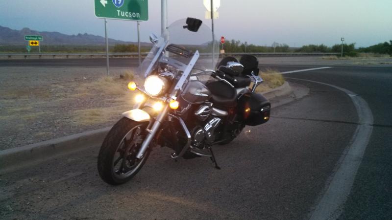

videoarizona Posted December 2, 2014 #3 Posted December 2, 2014 (edited) Skeeter, I think the type of lights would depend upon whether you want more visibilty for cars to see you, or more flood or spot lights for night driving. Maybe a little of both. For me, It was more along the lines of wanting people to see me easier. I already added a pair of WalMart lights ($20) to my VStar 950T, swapping out the 55watt bulbs for 30watt as the 950 charging system isn't robust enough for that much current. They seem to be doing the trick as I haven't had any issues since I put them on(knock on wood). I also put a small screw into each lens to make sure they didn't pop off as they are held on with a dimple. http://www.walmart.com/ip/Optronics-55w-Pair-Driving-Light-Kit/16680058 As you can see, the lower wattage bulbs are plenty bright. They do add light to the sides of the road at night as well... as I have them aimed that way just enough to catch the eyes of drivers on side streets. I'm now researching driving lights for my 89 1st Gen VR. May use the same lights as well but leave them at 55 watts. Haven't figured out where to mount them yet which is the holdup. Because the switches are poor quality, I would hard wire the lights to the battery through a relay so they are on all the time the ignition is on, as I did with the 950. If you want pure down the road light, suggest a good halogen or LED light proven for that use. $200 each will buy you very strong LED driving lights. These are cool... http://www.motorcycle-superstore.com/316/d/utv-lighting#&&SearchParameters=42-1021-0-0-0-1-24-1-6_1-2_956 Hope this helps... david Edited December 2, 2014 by videoarizona add info

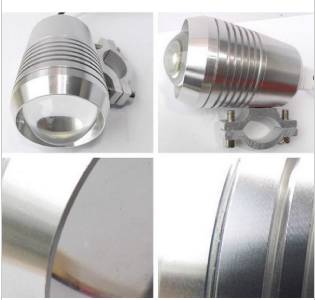

djh3 Posted December 2, 2014 #9 Posted December 2, 2014 Here is the listing off the site. Color:Black/Silver Material: Aluminum alloy Light Power: 30W Actual Power: 9~12W Environment Temperature: -40 ~ +40 ℃ Flux: 1200LM/W Input voltage AC·DC: ±12 ~ 60V Universal Light Color: White Temperature Protection: when the internal temperature exceeds the rated temperature, it will be automatically reduced to low light to work. Advantages: low power consumption, good waterproof effect, headlight life no maintenance, environmental protection.
