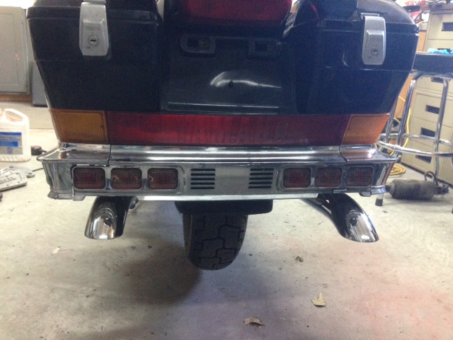

Hello guys,
I'm attempting to restore a 1986 Venture Royal that has the "Optional Yamaha Light bar" (as stated in the yamaha propaganda sales brochure). It is the one with the 10 red plastic lense covers. My lenses are so old, faded, brittle and downright fragile that simply removing them to replace the bulbs is like doing brain surgery and always results in breakage no matter how carefully I'am. Plus they look like they have been through a war.
I would assume I'm not the only person who has experienced this and I was wondering if anyone has found a replacement or maybe come up with a alternative way to fix or replace these with something else....maybe found a similar sized red LED lighted reflector?
I really like the look of this light bar bumper so I would love to find an alternative to make it pretty and useful again, rather then put on the boring stock non-lighted one which I have sitting on my work bench. Plus you can never have too many lights on the back!
Thanks in advance, any feedback or ideas are much appreciated.
Those lens are still available new. The lens are for a 'Baron Mini Twin' by Drag Specialties, PN. is DS-280168 (I think). Some over priced ones show up on Ebay, but you can find them cheaper at various motorcycle retailers. IIRC last time I saw some they were $2.50 or so.
Posted (edited)
I just bought some through Amazon.com. I counted the little squares you see cast into the plastic, on mine there were 9 across the width, then I counted them in the pictures shown on Amazon AND compared the measurements. The ones that Drag Specialties package DO NOT come with new screws btw.
